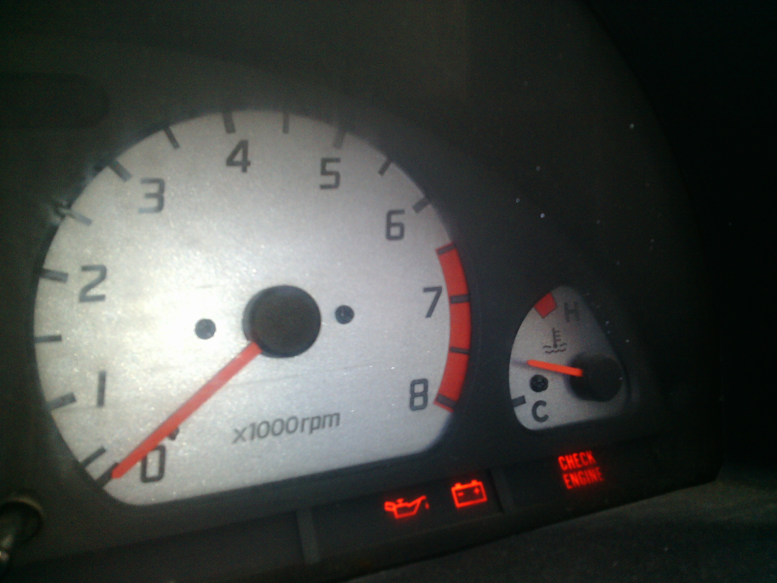

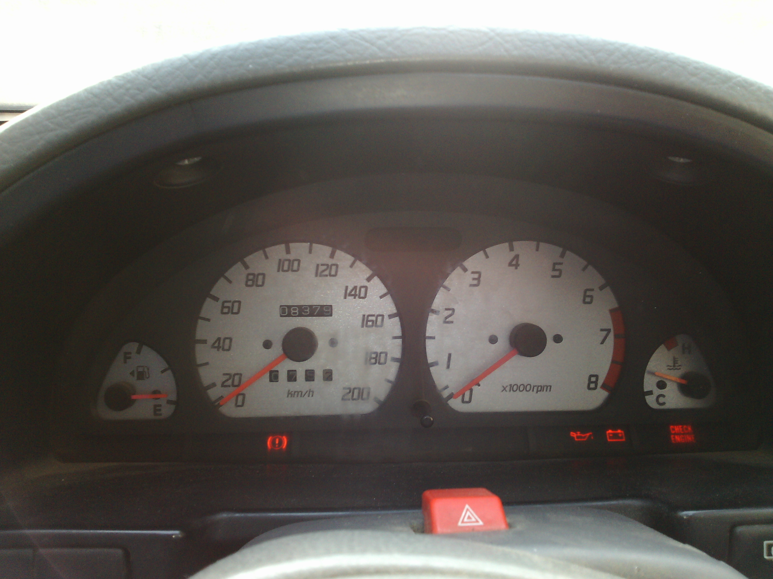

@nfsmostwanted @saboor73 @abid110Check these snaps: I started in morning, drove to some 4 Kilometer, then stopped car for 5 minutes to take some Breakfast from bakery. When i returned, on ignition needle stick to same place
As you told me that All the possible things like Radiator Fins/ T valve ? Radiator Fan etc are okay .
then this needle might be the culprit, is it staying at this place even if the key is not in the ignition/ car is off?
@nfsmostwantedNO BHAI.Needle comes back to default position when ignition is off? Also on starting, needle is at C but travel to this position very easily in very early manner. Is this position ok?
