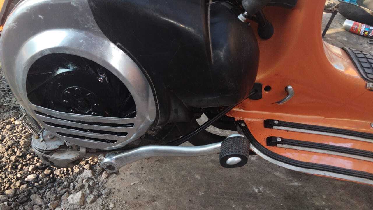

Today's Update: Did the first test ride MashAllah! It went smooth Allhamdolilah Apart from that did the following things for todays 1. Installed the flywheel cover, kick’s rubber and cylinder shied! Also fixed the rear mud guard with screws!
Allhamdolilah! Sums up the buildMashAllah MashAllah MashAllah
