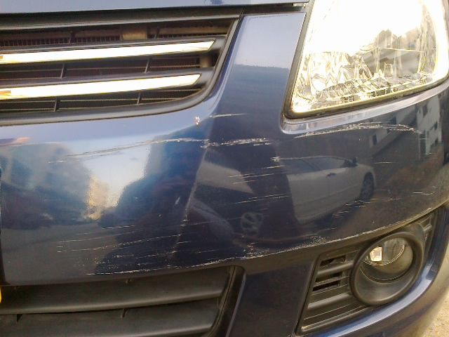

Pictures of the area hit and scratched.
Dont intend to get is repainted or anything. The marks don't hurt because of the monetary loss, thats hardly of importance, bu the fact that I tried my best to keep it safe and out of any danger, drove it very very carefully despite commuting daily to and from saddar and still this happened.

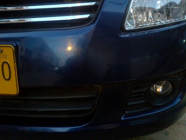

the affected area

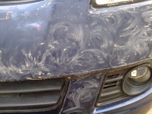

- started of with cleaning the affected area with a damp cloth
- applied thinner all over the place
- tried cleaning of the affected area to get rid of the other car's paint using a clean cloth and thinner
- after I saw no more could be done took out the rubbing compound
- applied it all over the affected area and started rubbing rigorously
- after all shaky arms and breaking sweat, wiped it off and saw slight improvement
- paint had gone off but scratches were still there, they required extra effort and I was dead tired
- to protect the paint layer applied a layer of wax to avoid the paint being all burned off etc
