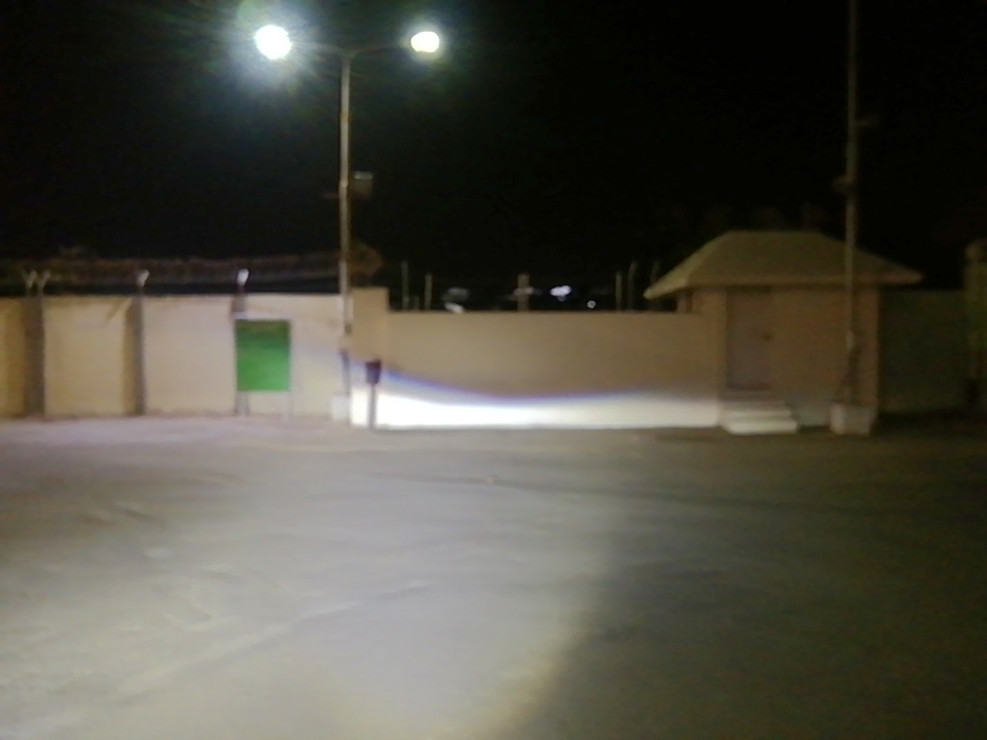

It looks ok to me, just like @salik990 bhai also said. And again, as Salik bhai said you didn't fiddle with the cut out so it's on OEM specs. Generally there will be a screw which can be rotated using a flathead screwdriver to adjust the beam pattern up and down but maybe I will check my car in the morning to confirm. There will be marking on the cover above the headlight telling you which way will adjust upwards and vice versa.
In my experience, LED will not give the same satisfaction as halogen bulb. Major portion of the light will be concentrated in a very small area whereas outside that area there will be very little light. In projector housing (low beam) this will be less obvious and cut out will actually be crisper than halogen bulb. But in halogen housing (hi beam) it will be all over the place - too much light in a circle in the center whereas outside that circle the light will be all over the place and probably cause glare too.
That's why based upon my personal experience I have left the OEM bulbs in the hi beam as they give a much better result compared to LEDs.
