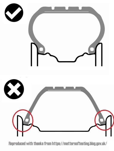

About stretched tyres you are risking your life because a stretched tyre isn’t sitting properly at the bead of rim and you are exposed to tyre failure. The lower diagram is of a stretched tyre to explain how it isn’t stable at the rim. The edge can come off easier from the rim

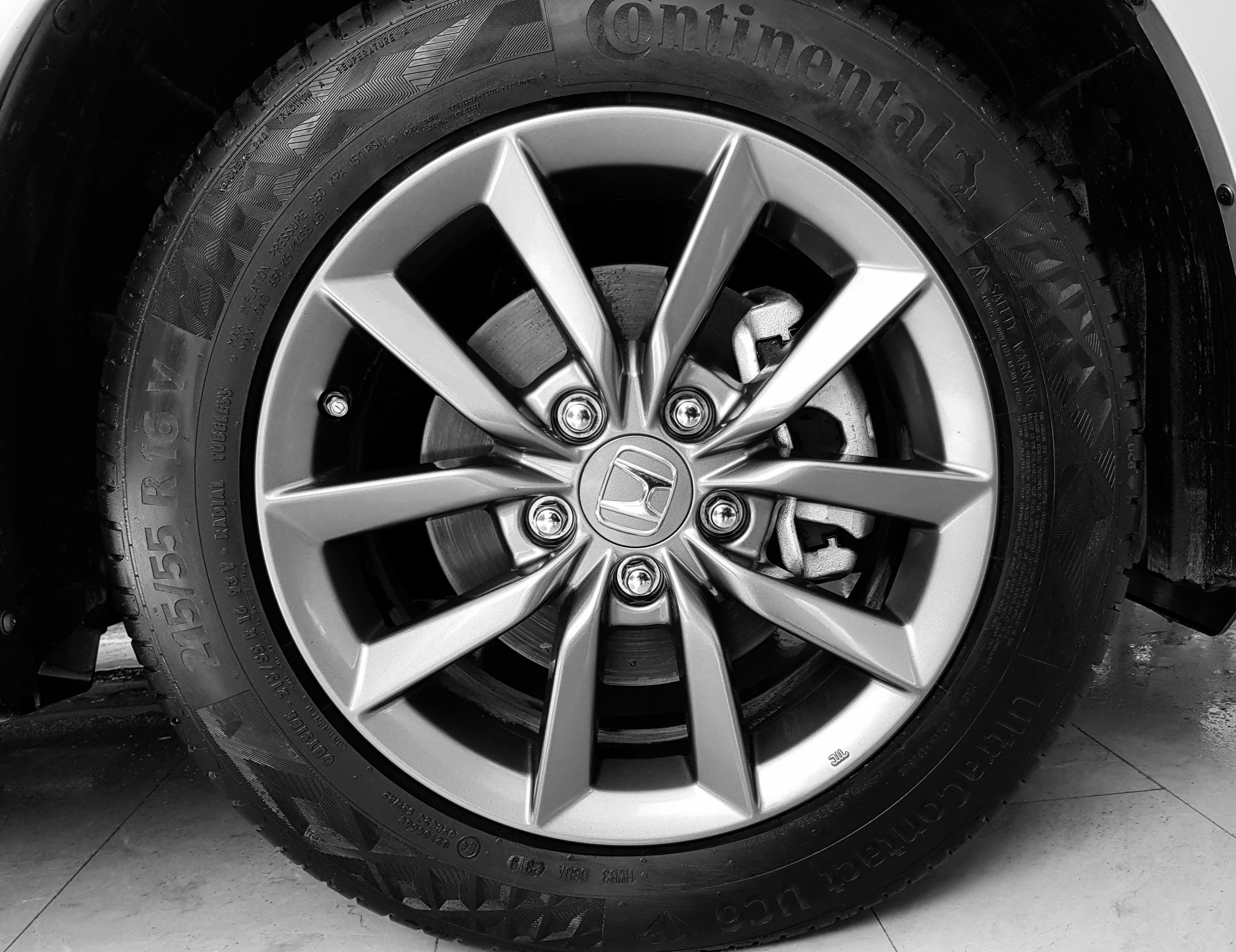

About overall diameter: 225/40-18 tyre is slightly smaller than stock size, the diameter of 235/40-18 is more matching to stock 215/55-16. Your fuel average will drop max 1 kmpl on 225 width and more than that on 235 though
