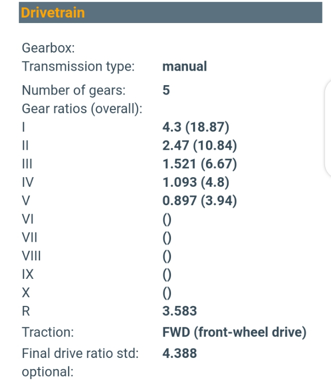

Assuming it has a ring and pinion ratio of 4.71, a 5th gear ratio of 0.9 and a stock tire height (diameter) of 22.1", its slightly above 4800 rpm at 120 km/h.
Assuming the same 5th gear, but a ring and pinion ratio of 4.064, its just under 4200 rpm.
Btw, Mehran, with its 4.350 ring and pinion ratio, and a 0.9 4th gear, and 21.1 inch tires, cruises at almost 4700 rpm at the same speed.
I'm inclined to believe that the Alto is at 4800 RPM; it makes sense considering that the most common complaint about this car is the engine noise inside the cabin.
There is a reason that this is called a city car; I wouldn't buy it if most of my traveling consists of motorways.
