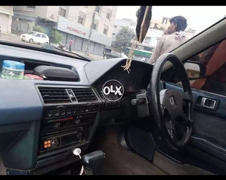

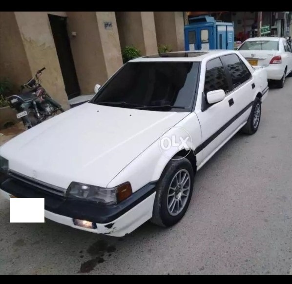

HI there, I just bought a 1989 jap model Accord EX auto transmission. 1600cc A16 engine.
It shifts abnormally when engine warms up (like after 5-10mints of driving in morning).
It does not up shift up easily when from 2nd to 3rd and up to 5th, instead goes to higher rpms like 3500 - 4k and then shifts with a jerk..
In traffic it shifts down to 1st gear on high rpms when it should take 2nd gear as it is already in good movement.
