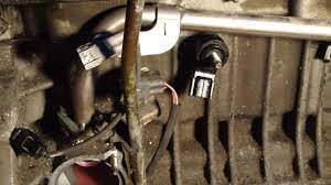

This is knock sensor over a Toyota VVTI engine
Thanks all, the connection grip was faulty
