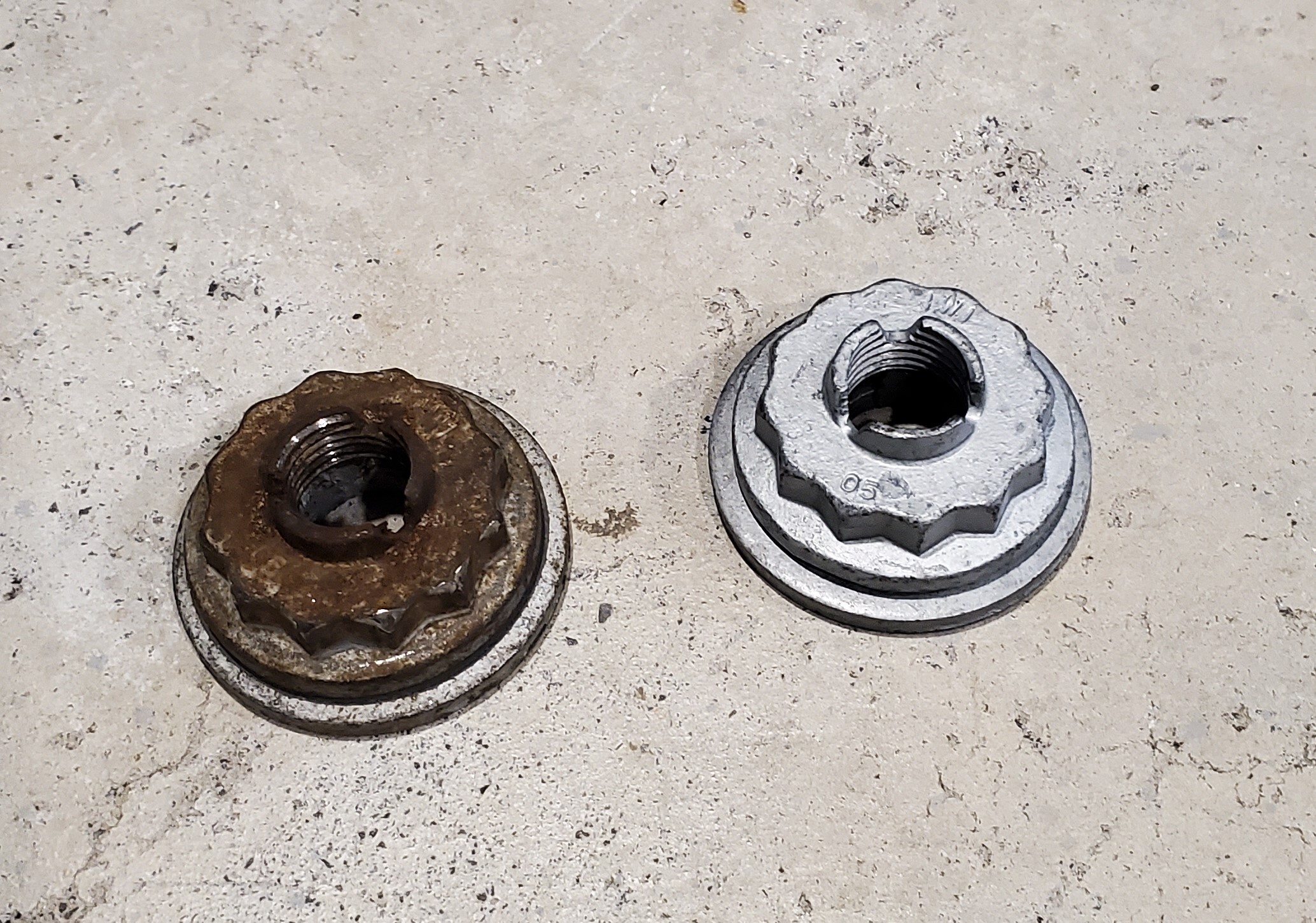

I was able to take out some time today to flush brake fluid. Long process, mostly because rear lugs were overtightened and they were PIA to remove.

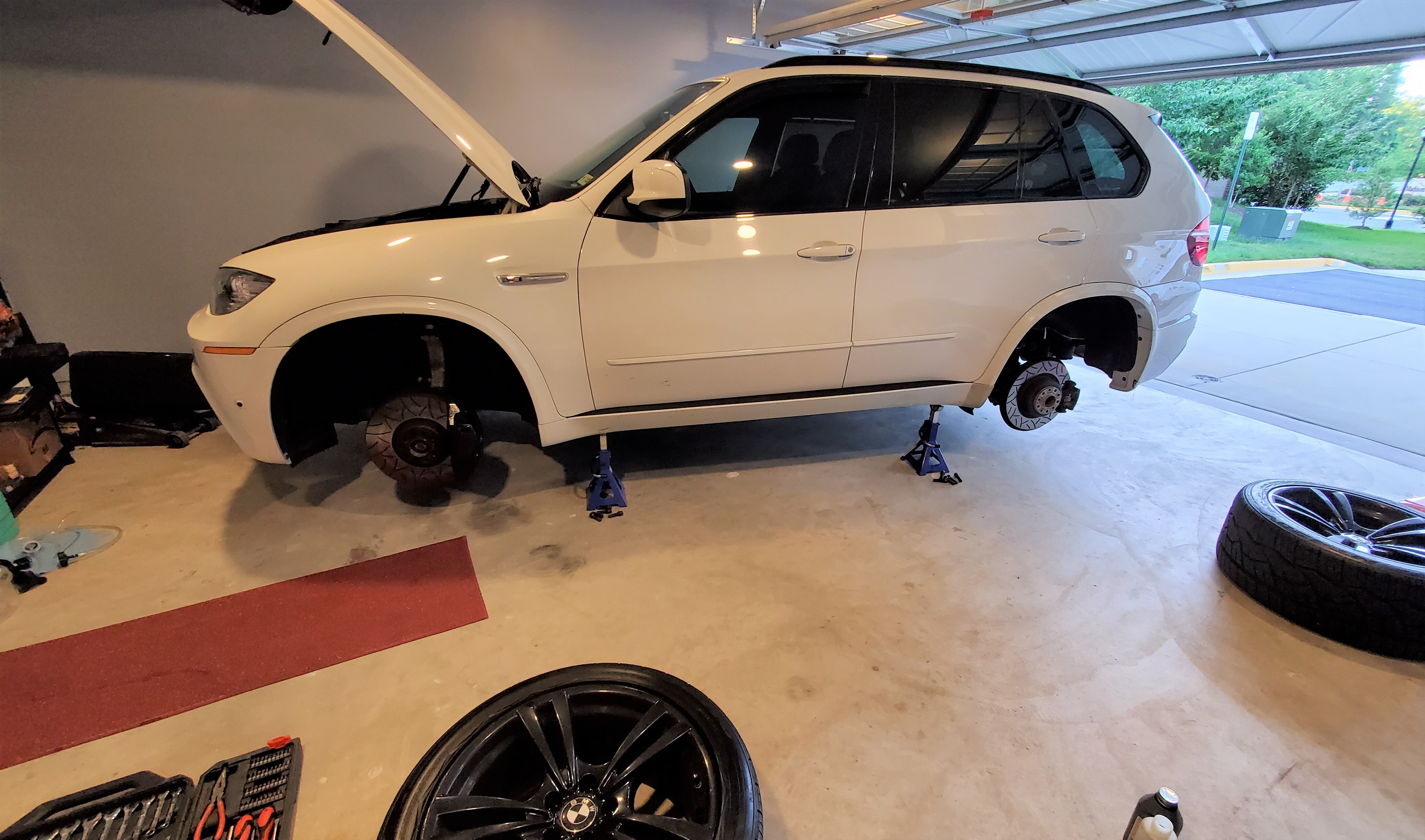

Jacked up the truck and removed all wheels.

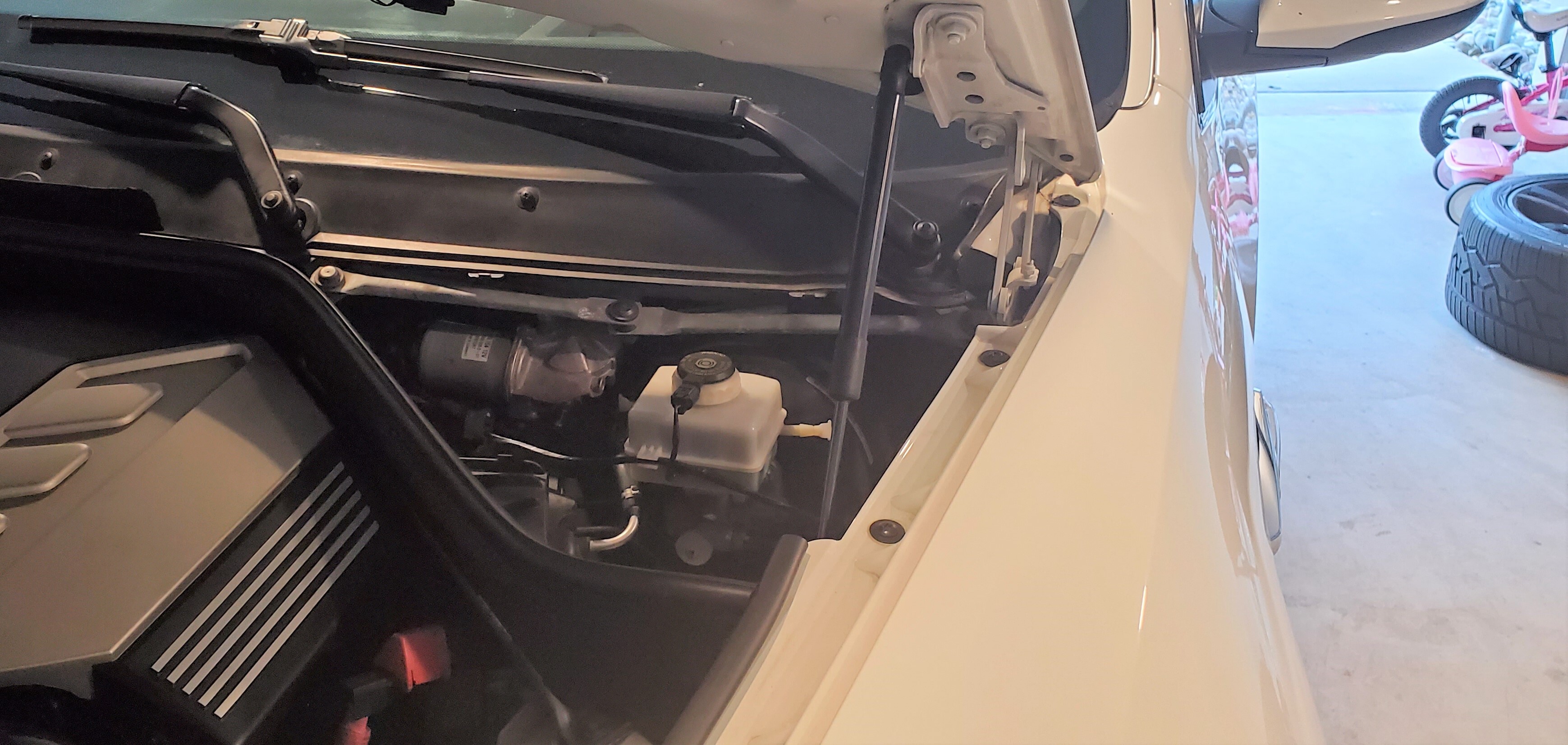

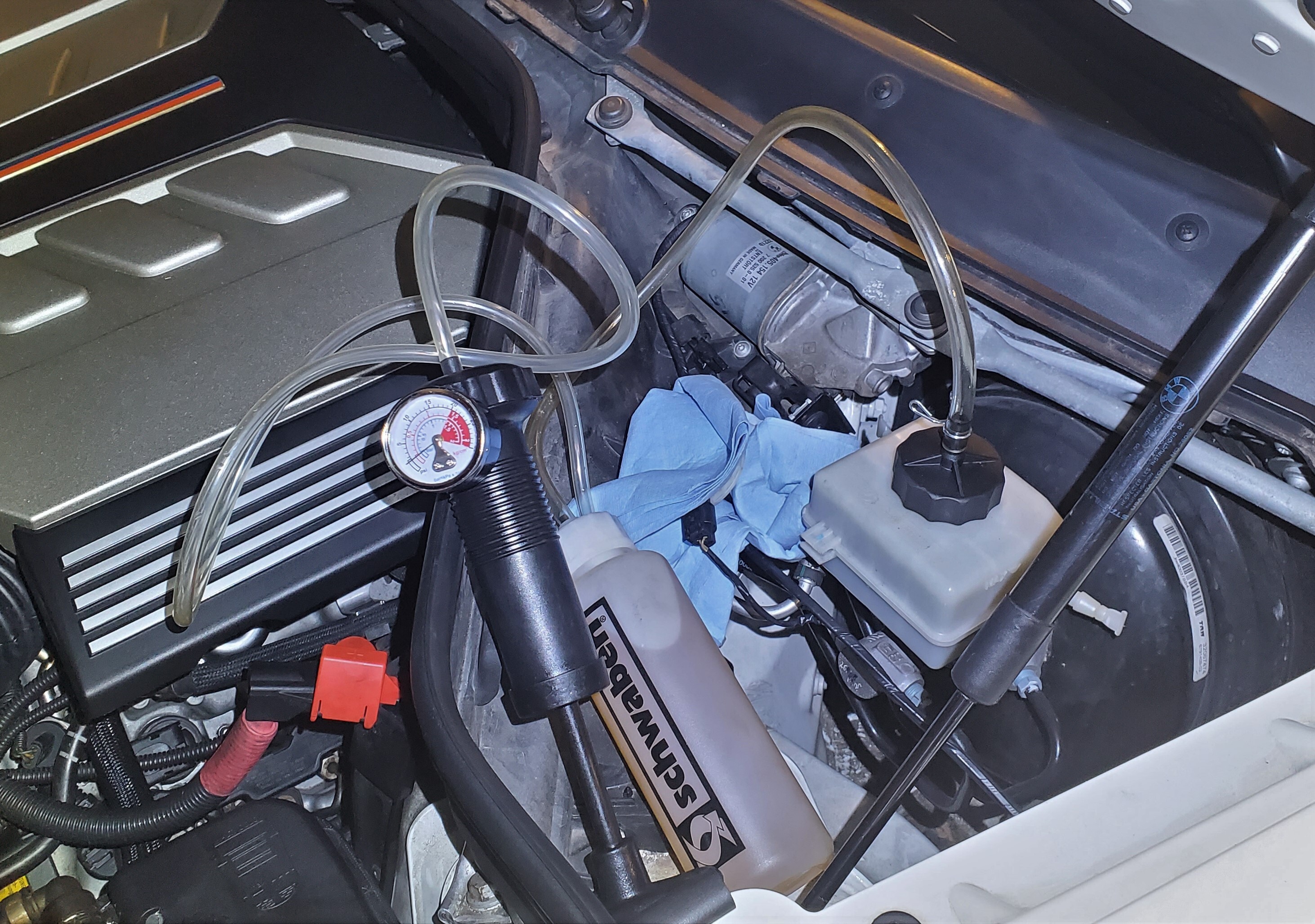

Removed the cover to gain access to brake fluid reservoir
Used Liqui Moly DOT4 brake fluid - I did not flush the ABS system, that requires a diagnostic tool to run and I didn't have it right now. Ended up only using one bottle of brake fluid (500ml)
Used a smaller brake bleeding/flushing tool by Schwaben. Filled up the bottle with 500ml and pressurized the system to about 13psi. Started with passenger rear, driver rear, passenger front outer then inner, driver front outer then inner, bled the system until I saw clear fluid come through.

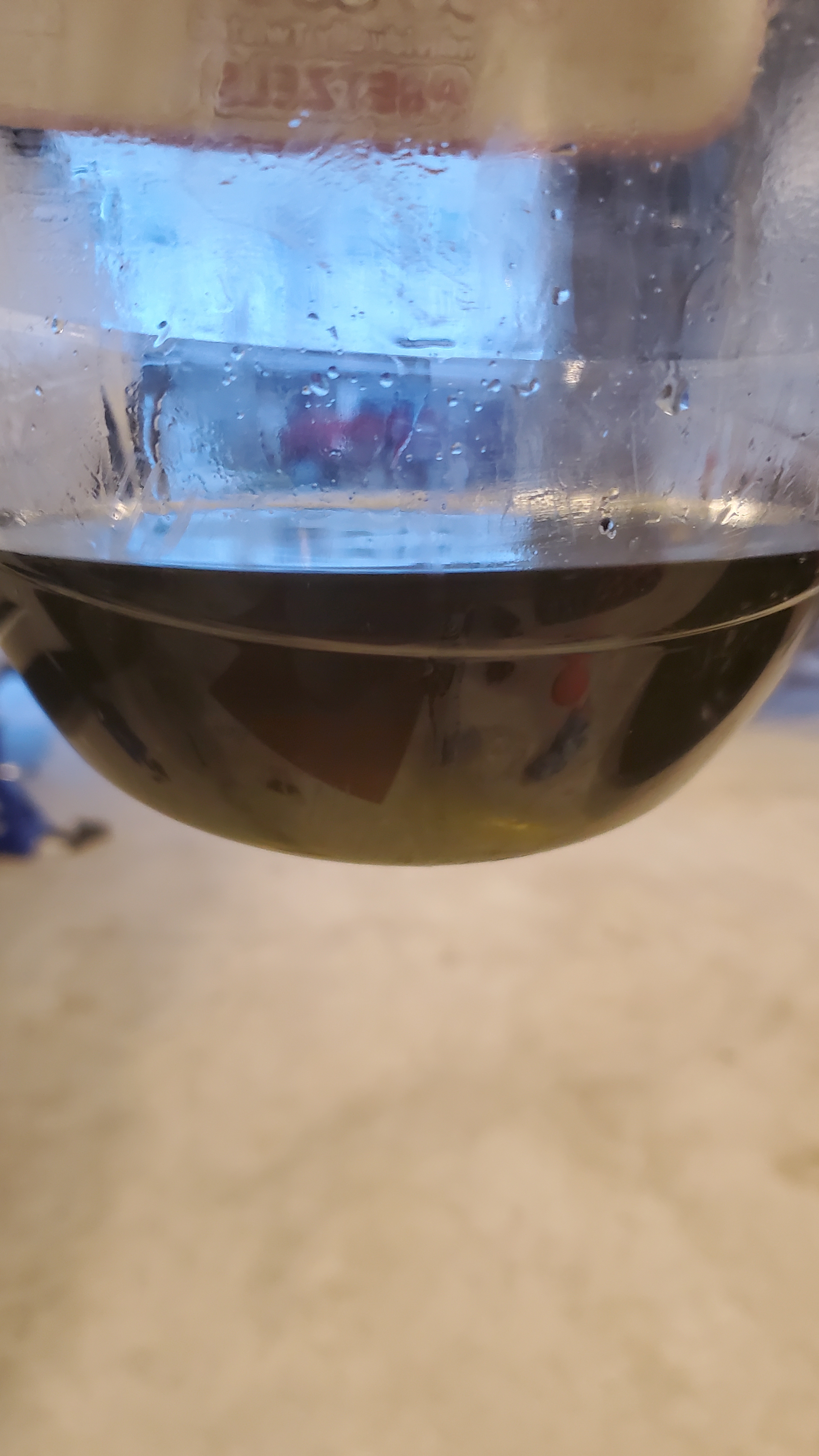

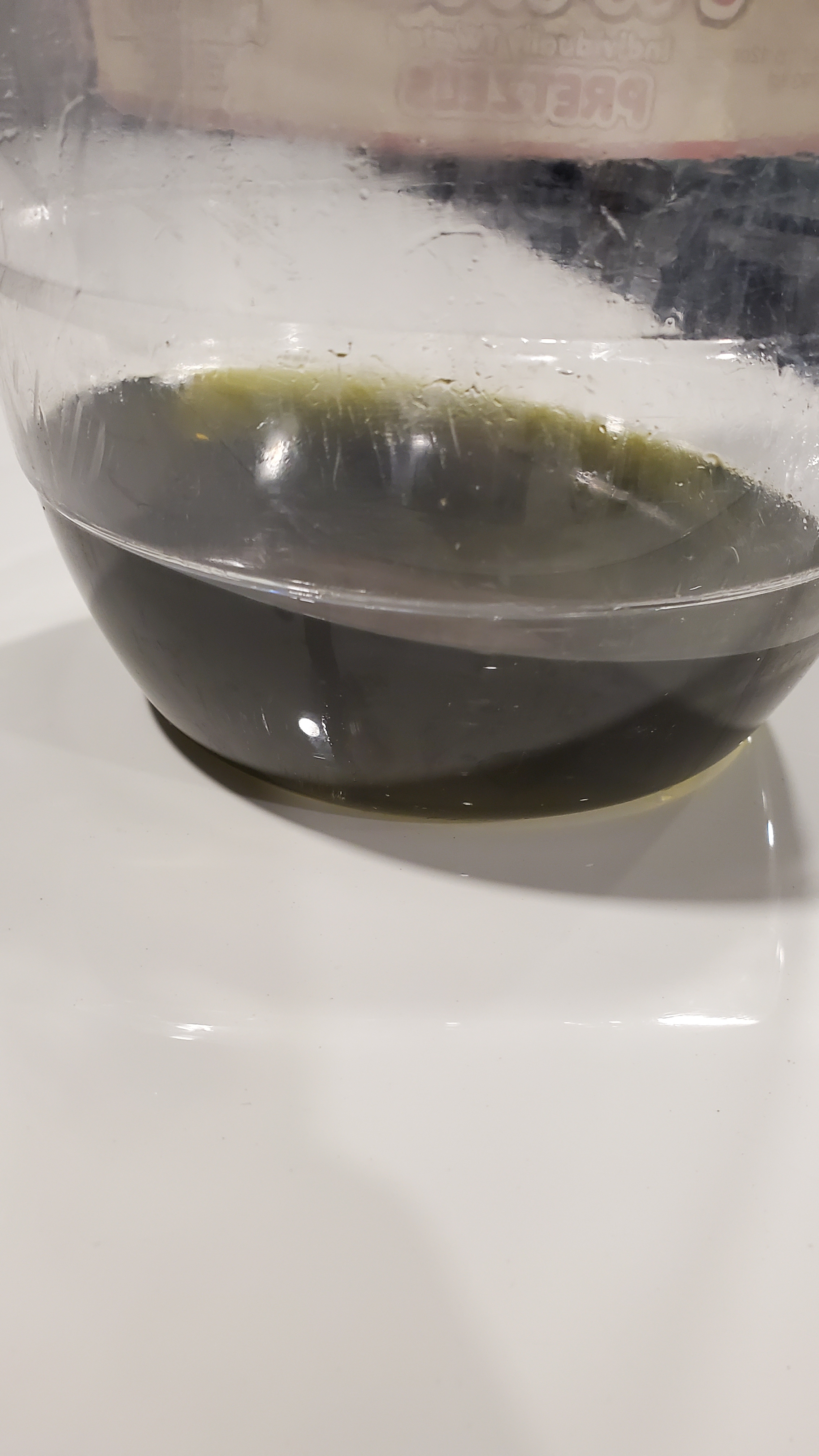

Fluid started off with clear green and turned darker as it kept going. Ended up with what I have in the container.

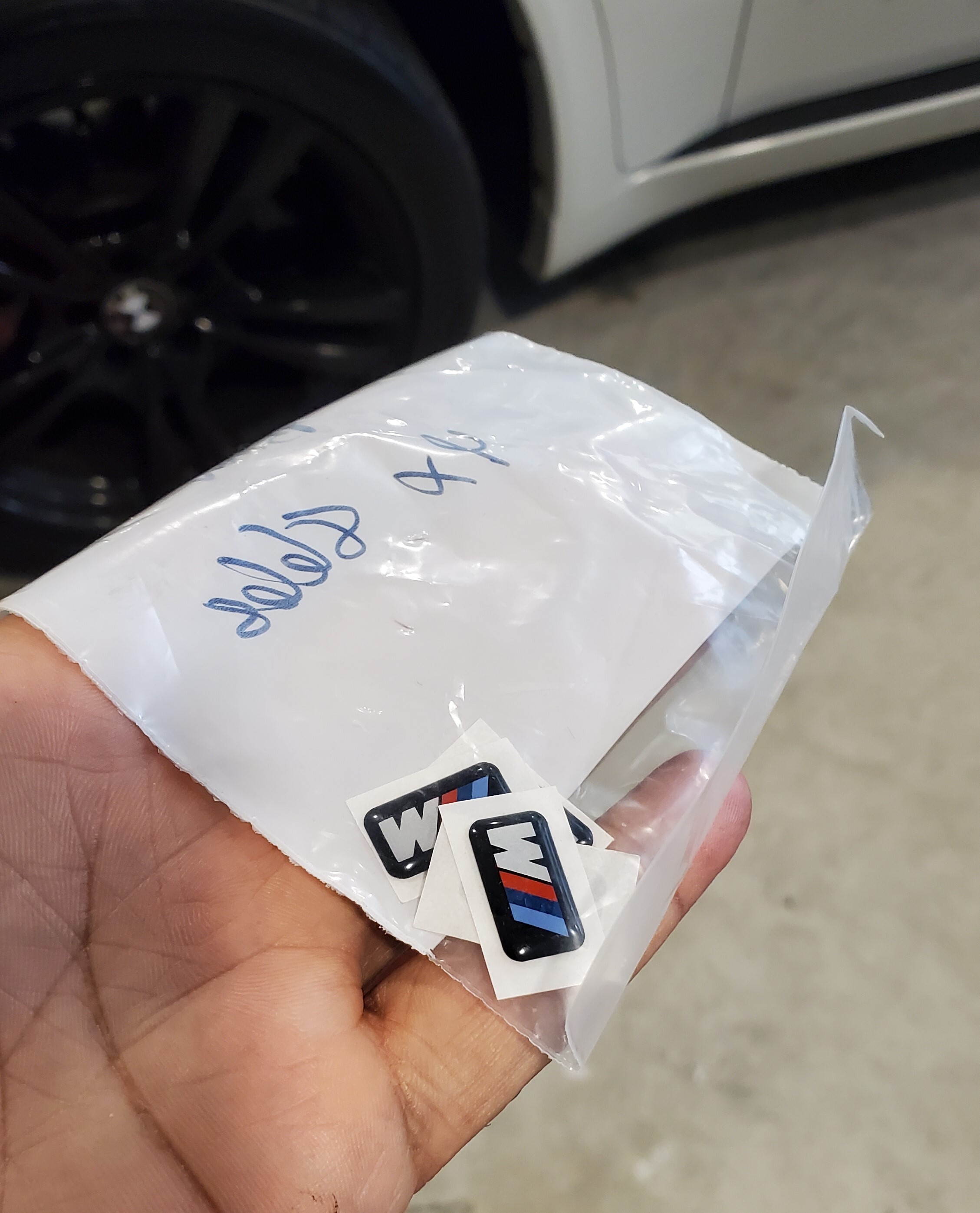

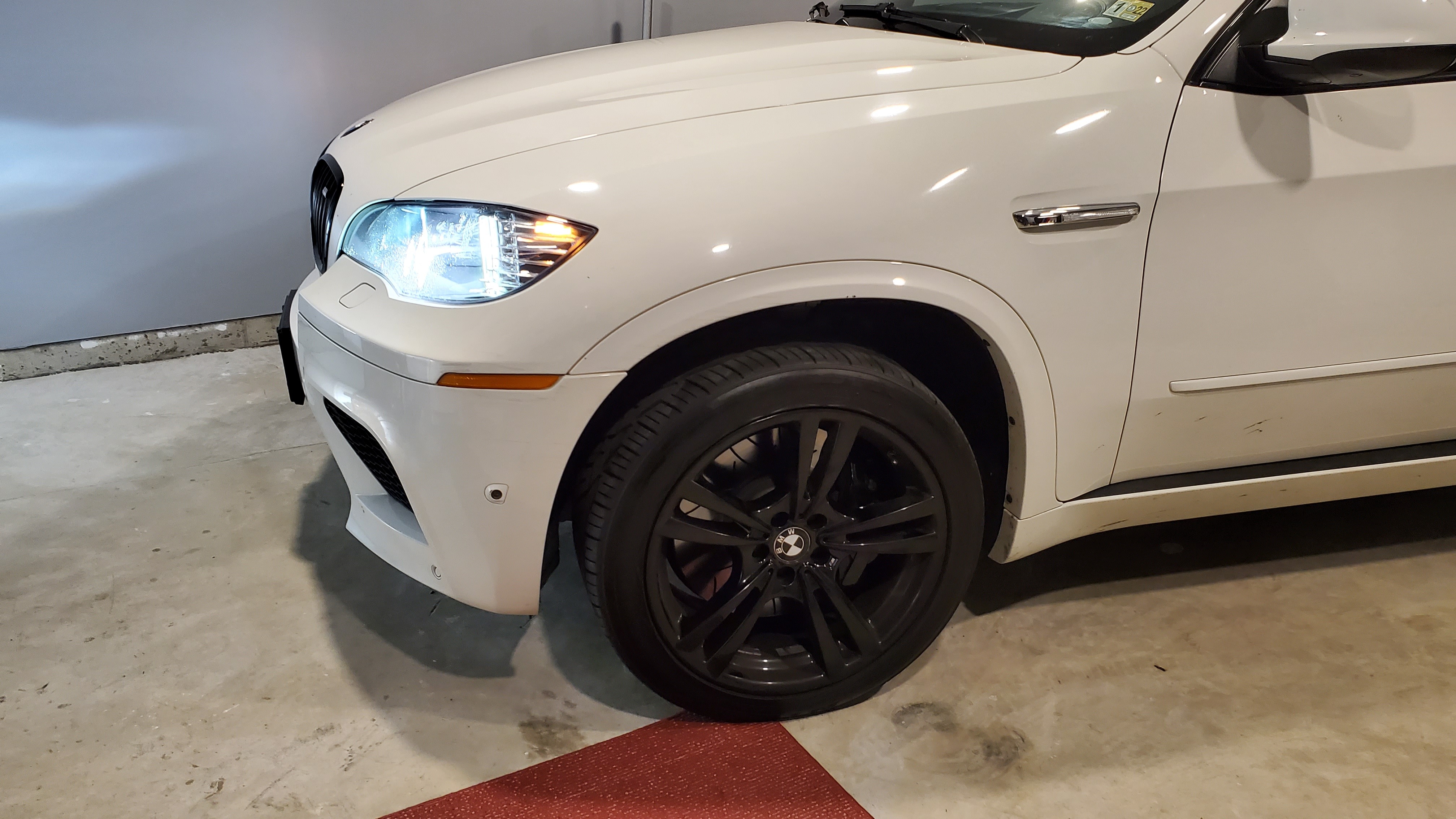

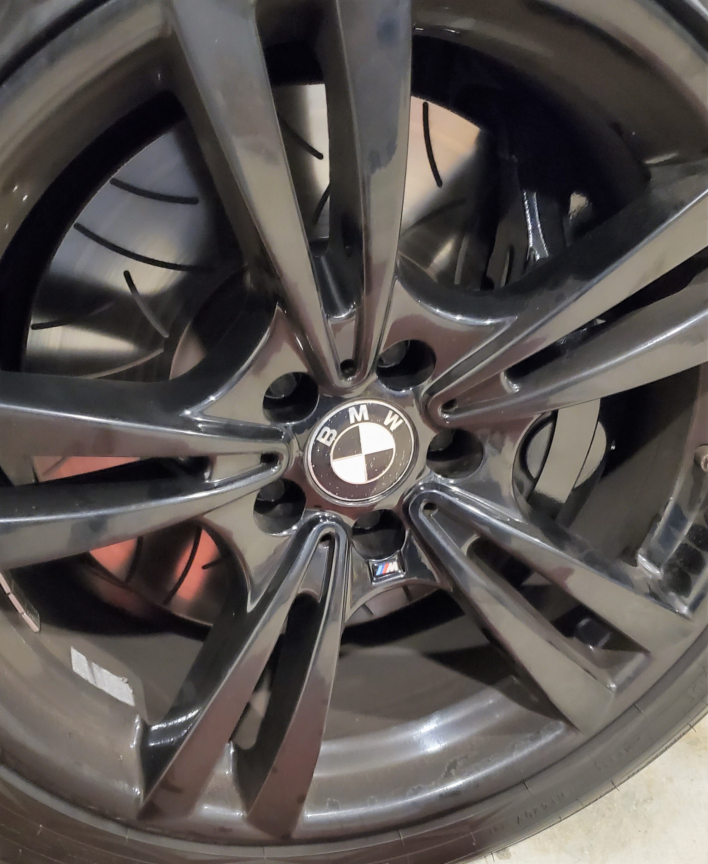

While I was at it, I had 'M' emblems for the wheels sitting around that I decided to put on as well. These wheels are BMW Style 299m that came on the E70 X5M series and are 20x10" fronts and 20x11" rears.
