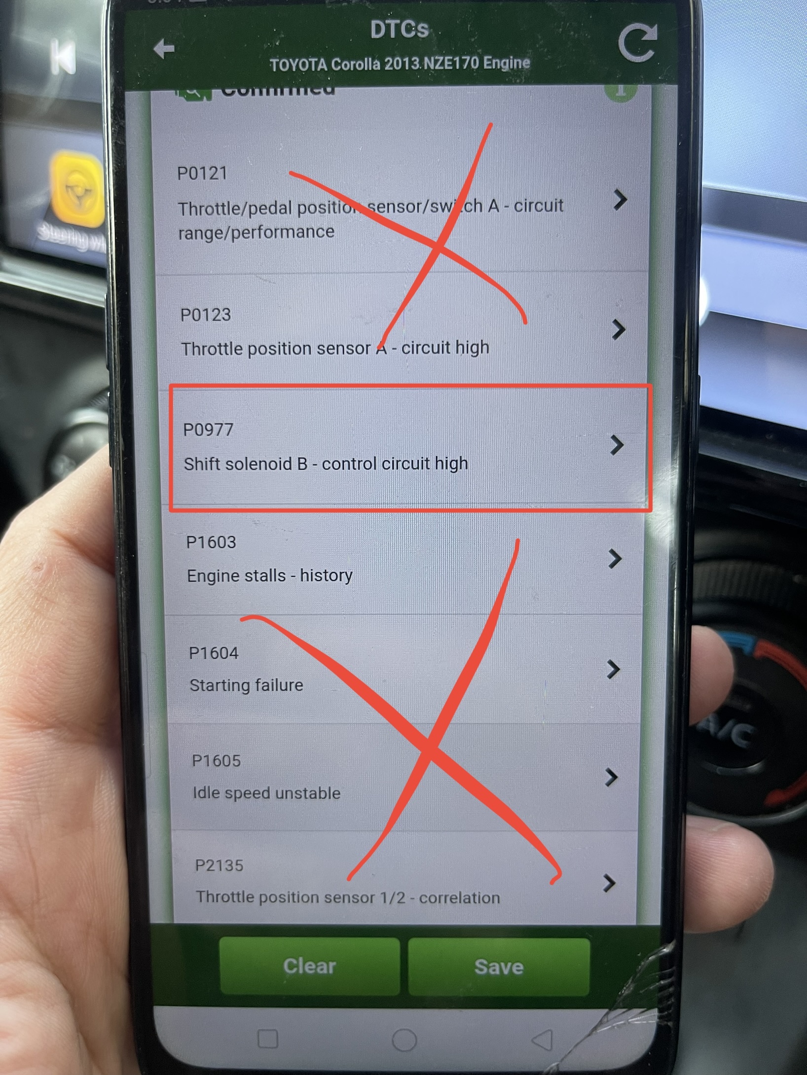

So today this code P0977 came out of no where just started the car and check light came in upon check this is what shows up.Is the solenoid bad or wiring issue ?
beneath battery tray you see two solenoid valvebody just clean that with carb cleaner and check solenoid with battery. if any of solenoid not working get it from kabar

If gear is behaving like crap then it's a solenoid.
Swapped with 2019 model gli sensor still same problem. Gear check light came only once and it’s not doing crap while shifting.
if u have hands on tech stream or any good scanner u can check solenoid in that menu. so any break in wire or ecu problem can be ruled out
Sadly no good scanner available with me and most of the idiots mechanic in my vicinity don’t have skill to read the scanners etc.
