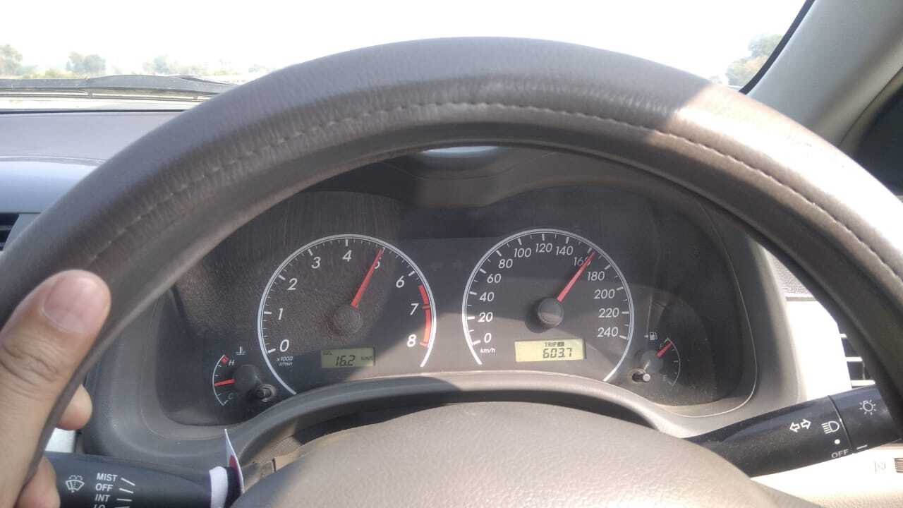

I bought a used Corolla GLI 2016 with 84K KM. i was getting 4KM/L average. I changed the oil & filter, transmission oil and the spark plugs. The fuel average improved to 6KM/L.
Then I had air filter replaced, throttle valve assembly cleaned. Had Fuel Injectors inspected and cleaned, O2 Sensor cleaned, Catlalic Convertor claned (no acid). The fuel average improved to 6.5 in the city and 7.8 max on the highway.
Engine runs louder than normal on high speeds.
The pevious owner apparently had impact from below as the oil pan nut was pushed in and was leaking oil. I can get the suspension checked? Any other suggestions that anyone has?
