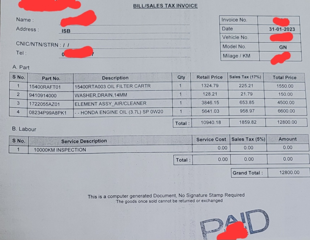

Got my 3rd free (10k) service today.

During the free service they changed the air filter (which was quite dirty/oily, i had got it cleaned by air twice previously) and they also cleaned the spark plugs.

Keeping finger crossed on the oil leakage issue, hopefully it has been fixed permanently. The repair was covered under warranty, no didn't pay anything for that.
