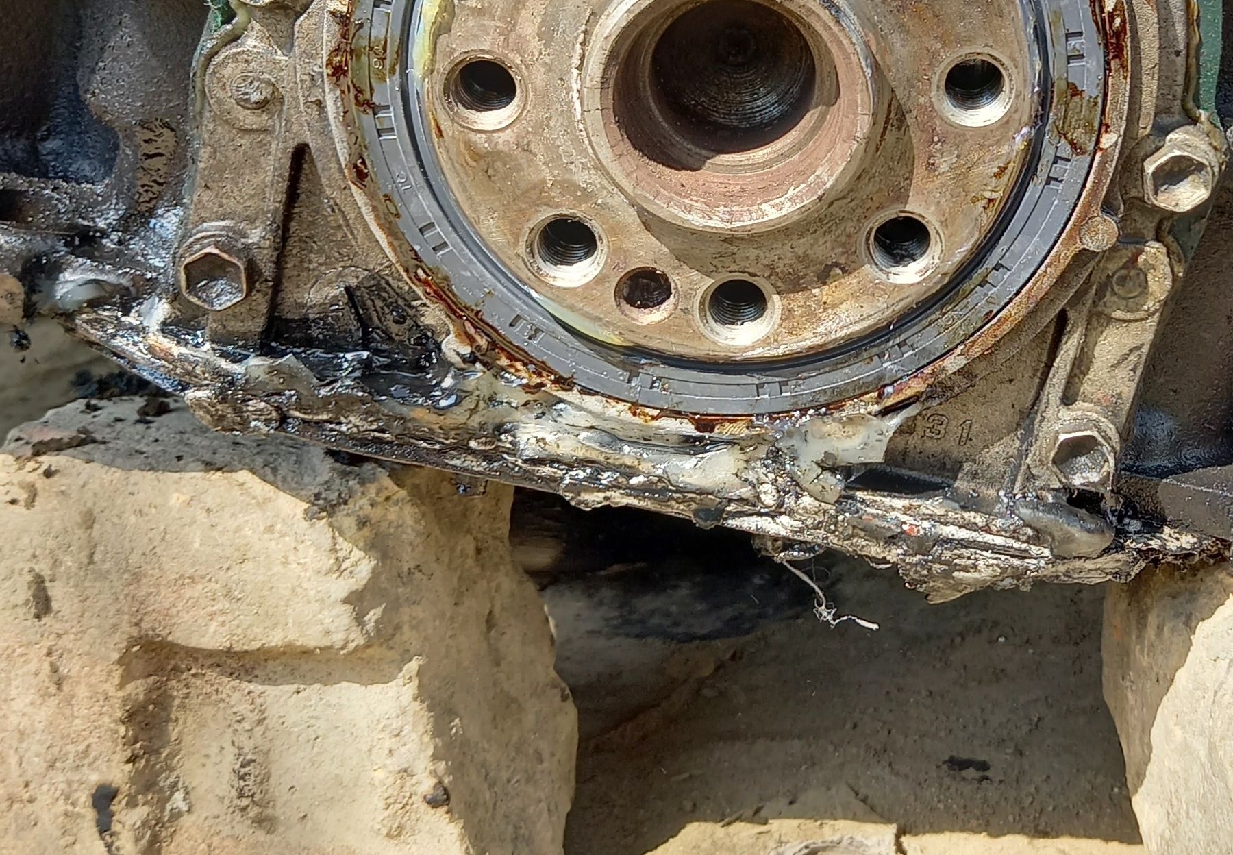

What is all this welded crud?
i think this is some silicon applied by that mechanic while changing seal...but my problem was still there of leakage....
No, the silicone might be the brown patchy stuff. I am talking about the stuff below the main seal extending all the way to the left. It looks like a badly welded repair to some major parts.
well there is nothing welded in engine..i think it may be some extra stuffed dirt.loll...there is no weld etc in chamber or any part..i will upload some more pix also....
The dowel pins are missing or broken. The main seal carrier has been broken and welded poorly. The main engine block tab on the left has been jugaared. One wonders what else has happened to this engine, but the edge of the sump does not look too healthy either.

we all know what dowel pin missing causes

Unfortunately i am in peshawar...What parts are missing in pic? As i am no getting it

Dowel Pin
use google to know the purpose of dowel pin in automobile engine
The smudge oily outline suggests that the transmission/engine mating surfaces are not stock. It get better and better.
