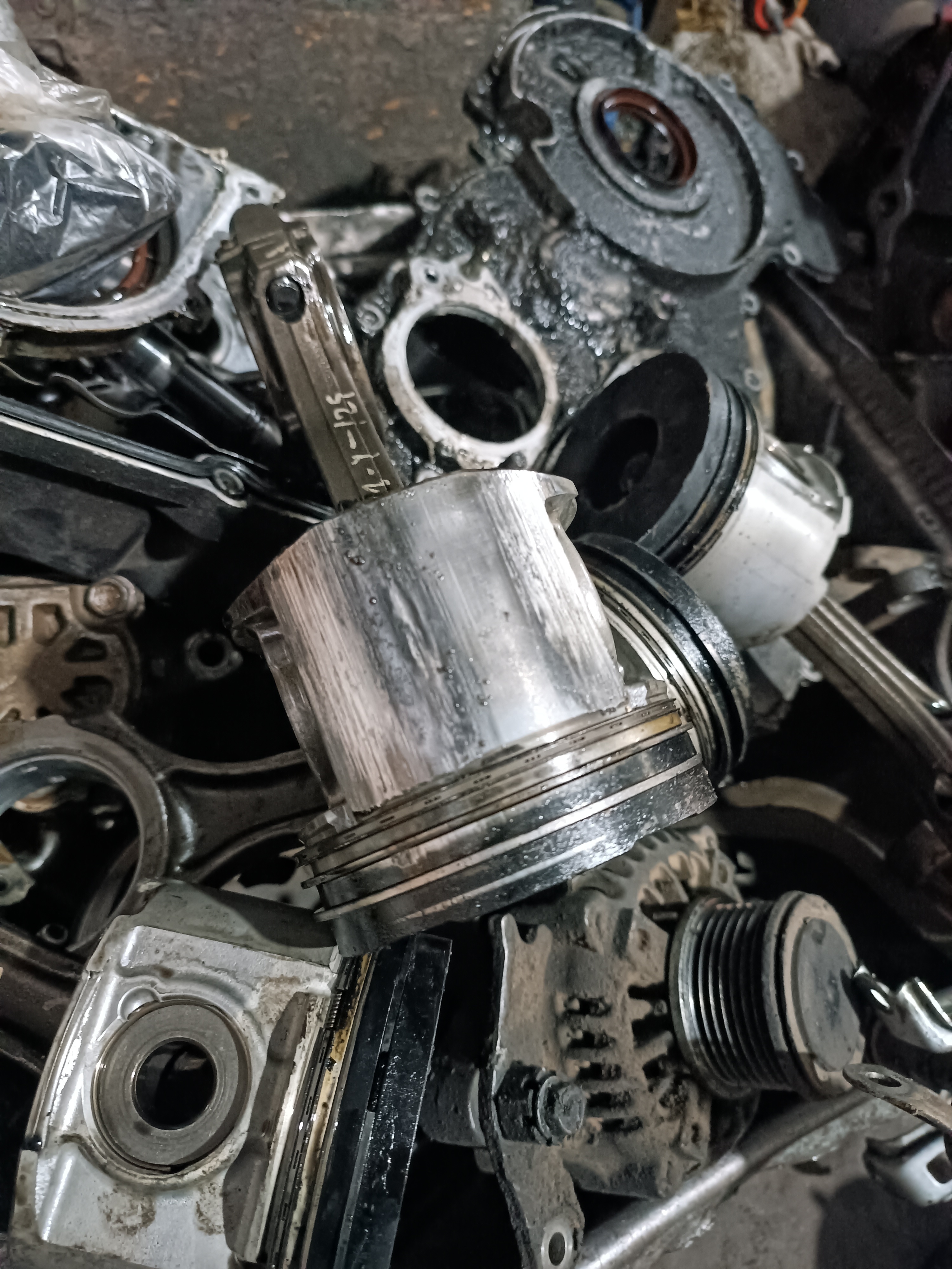

Overhaul from few days back 2KD - damaged pistons
sir what is approx parts price for such overhaul. @hash4u
A good rebuild costs around 650 plus Brand New injectors Pump is available and found in scrap too
very tight budget rebuildonly essential parts changed.which means old pump/injectors everything else re usednew pistons worth 78k was putting budget outso had to get kabli set 30k with Sleevesrebuild cost 165k . going fine so far.
