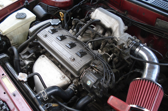

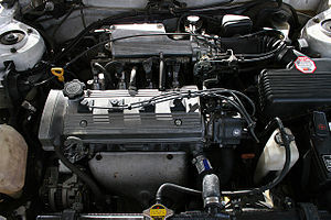

You have any pic or reference link for 3rd generation 4afe to differentiate from 2nd generation.
Intake manifold is different and as said above 3rd gen came in ae110 and ae111.
2nd
3rd
