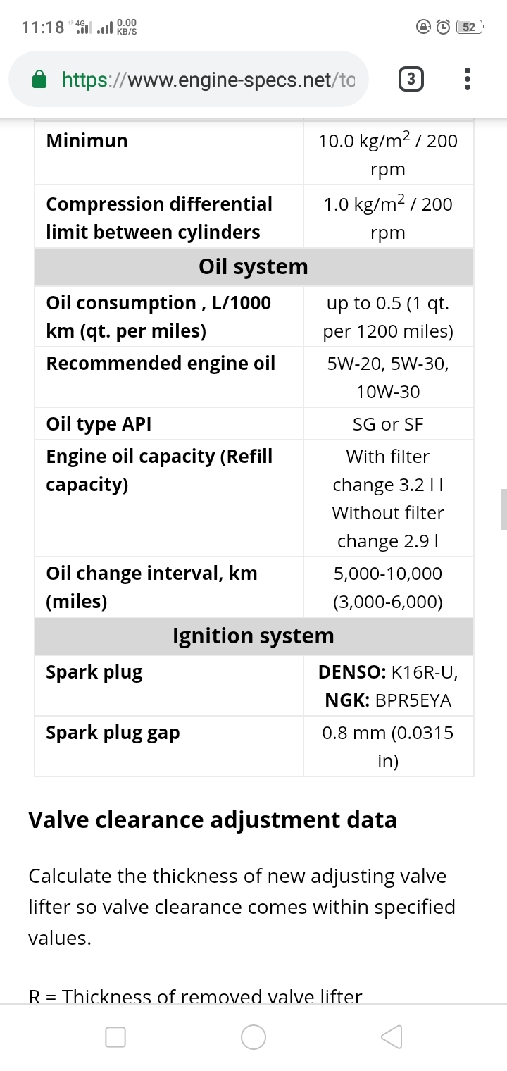

Without oil filter change: 3 liters With oil filter change: 3.2
