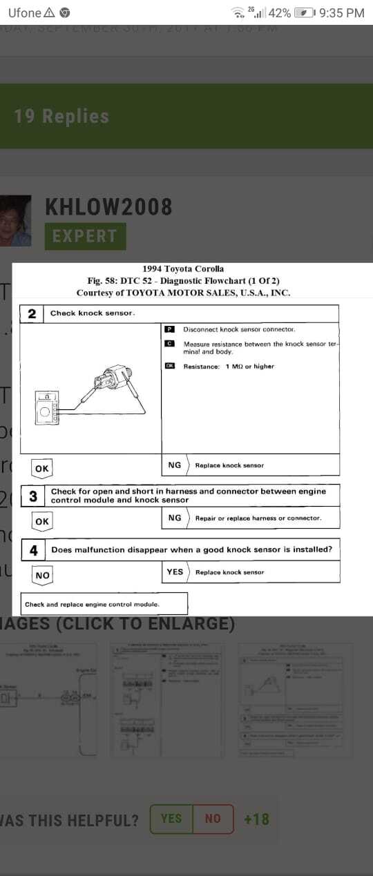

You can give it a try by using the probe of the multimeter to reach the terminal of the connector when it's unplugged. Unplug the knock sensor and test the actual sensor itself by checking that there is no continuity between the knock sensor and the body. If there is then the sensor will require replacement, but if there isn't then the sensor is fine and the fault is likely to be within the wiring or the ECU.
Give those steps a try first before considering replacing the sensor as you'd hate to go to all the trouble of removing the intake manifold for nothing. If the sensor turns out to be faulty. You can test it by continuing.
