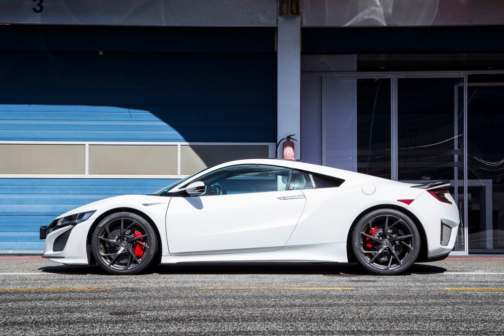

It produces downforce without any ugly wings
As explained here by NSX Dynamic Project Leader Nick Robinson - a man with an exceptional intellect as well as a stunning moustache - Honda’s new supercar does some very clever things with airflow. Air is carefully directed down the sides of the cars to the intakes in front of the rear wheels, after which it flows onto out of the rear via the flying buttresses, slots in the tail lights and boot, plus the larger outlets in the lower section of the bumper.
As a result of all the trickery, the NSX gets the downforce it needs, but without the need for big, pokey-out bits of aero.
The A pillars are thin, yet super strong
This seems like an odd point to pick out, but with massive, vision-blocking A-pillars becoming ever more common in modern cars, it’s refreshing to get in the NSX to find they’re delectably thin. Thanks to the pillars and the roof side rails being all one piece and made from ‘robotically articulated, three-dimensionally bent and quenched’ ultra high-strength steel tubes (quenching is the rapid cooling of heated metal, by the way), they’re about 33mm thinner than they would have been otherwise. Good to know.
It’s way stiffer than a Ferrari 458 Italia
As well as a Porsche 991 911 GT3 and a McLaren 12C, the NSX development team bought a pair of Ferrari 458s for analysis. One of these was almost completely dissected, its sacrifice providing vital information. Thanks in part to the analysis of the Ferrari, the NSX’s multi-material space frame - made of that funky 3D quenched ultra high-strength steel, aluminium and bog steel - enjoys 300 per cent the dynamic torsional stiffness of the 458’s own space frame, and 200 per cent the static torsional stiffness. It’s the most rigid car in class, too.
