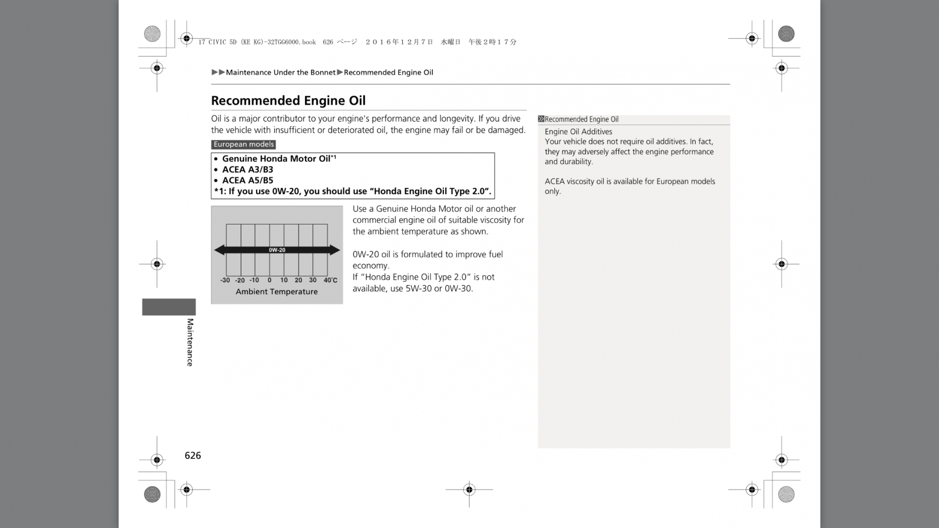

you will have a rolling disaster if you use those oils in your corolla as they are not fuel efficient oils and also it makes no sense to use an oil that would cost you about 30,000 PKR for a gallon and use it in a corolla.
