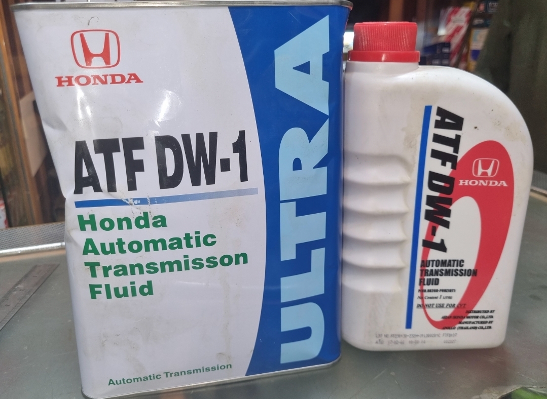

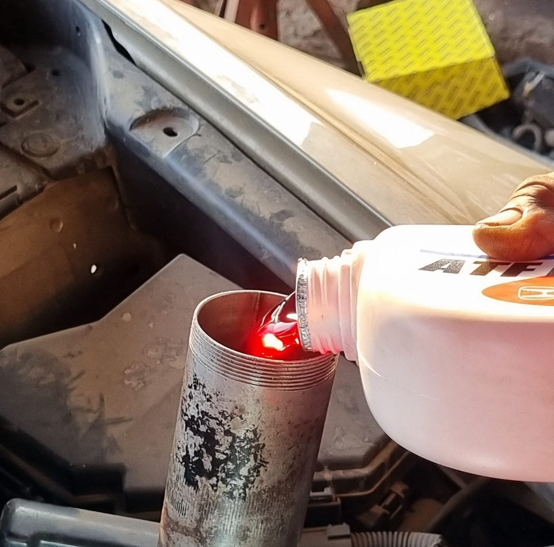

Put in 2.5L Honda DW-1 ATF from 1 liter containers, manufactured in Thailand by Apollo. Drove a little bit and confirmed the level on the dipstick.
Drive home was uneventful, and the car wouldn't shift into 5th for a while, preferring to stay in 4th, but eventually it did.
Let's see how it behaves in the morning.
Bonus: I didn't buy the tin on the left, which was Rs. 19,850 for 4 liters and called "Japan." Other retailers had the same tin for Rs. 12,500, which was dismissed as "China." The 1 liter "Thailand" bottle was Rs. 3,000. Can you see what's wrong with the tin?
