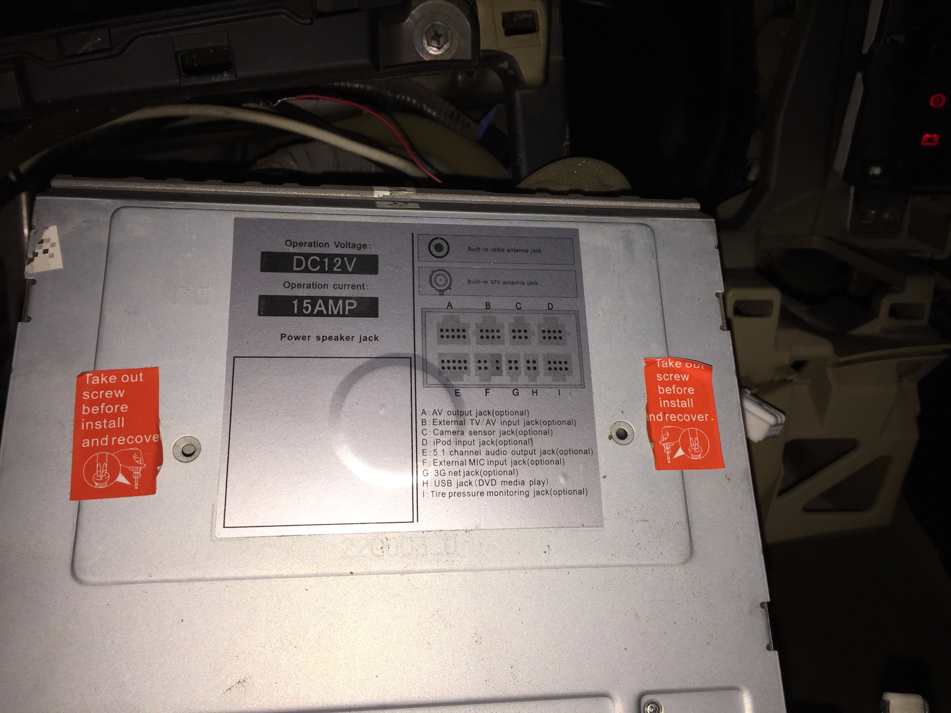

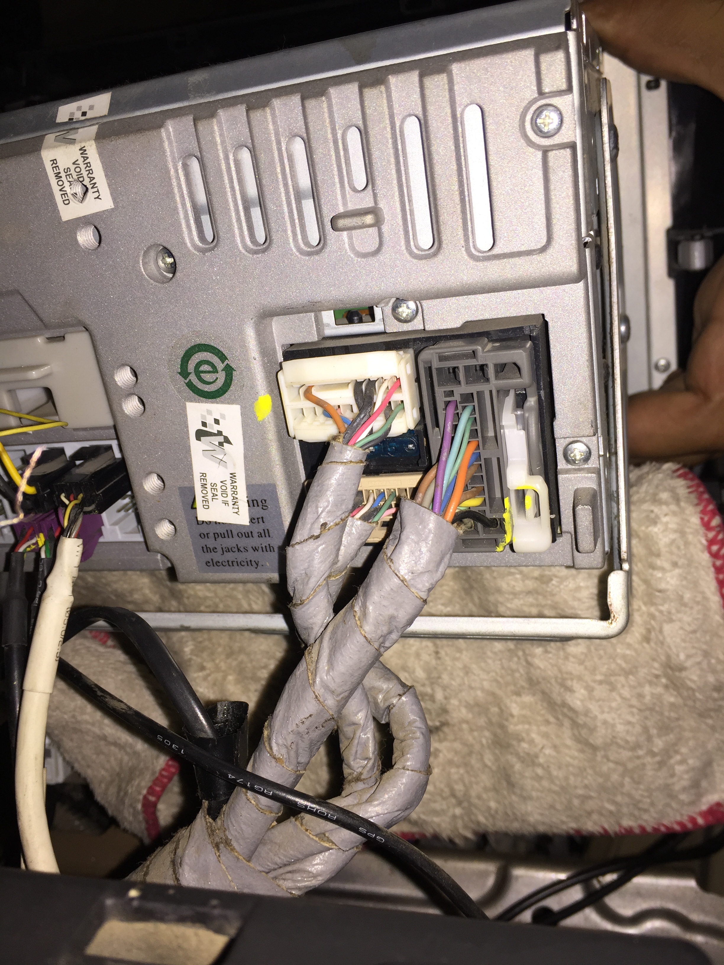

AoA Guys I need help regarding DIY installation of 2 in 1 Backup Camera & Reverse Parking Sensors on Honda Civic 9th Gen (2014) with original navigation unit head set.

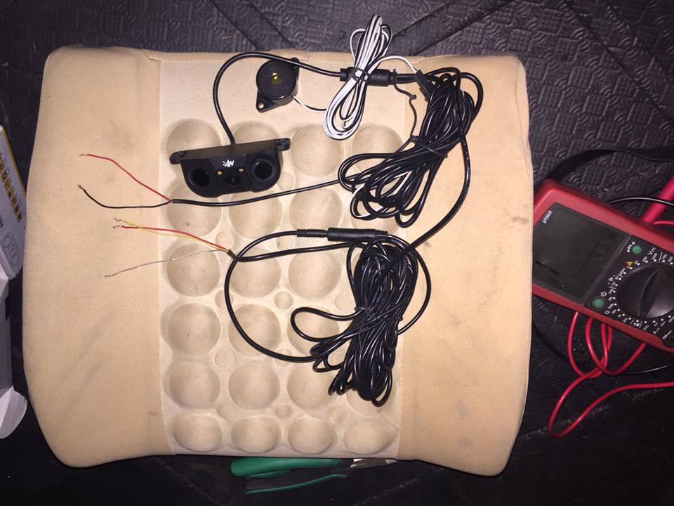

1/ I bought the kit from Pakwheels and tried to install myself.

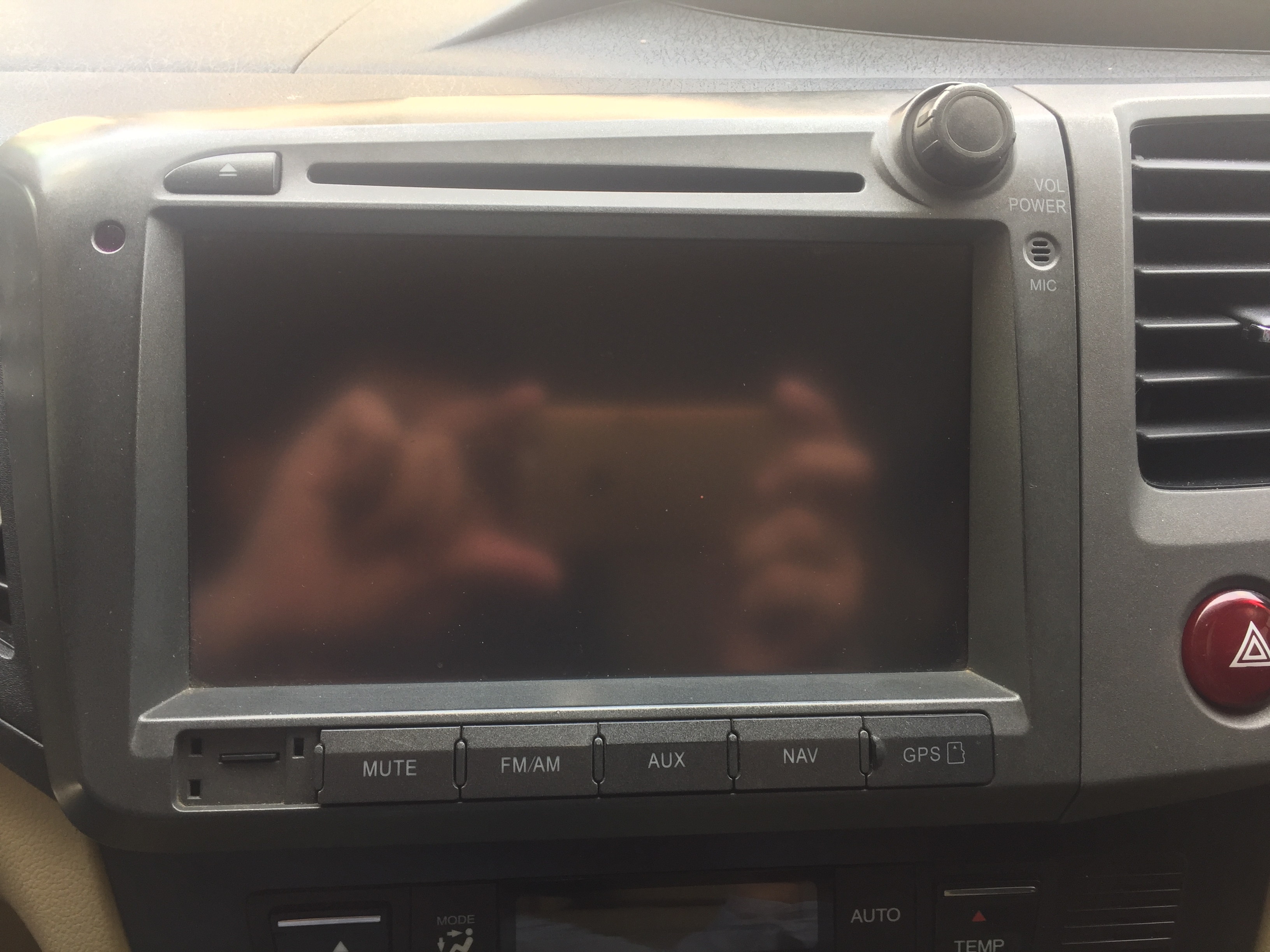

2/ Reverse sensors started beeping, I presume those are working fine (easy install). Also the night vision LEDs in camera turn ON.

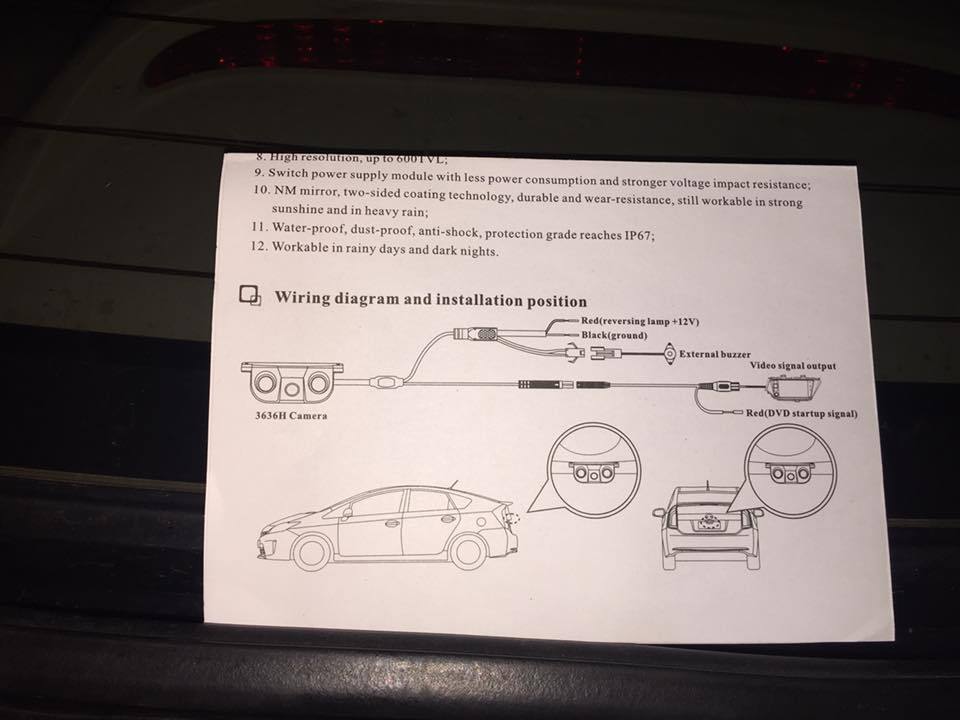

3/ However, the camera doesn't seem to be working, as head unit keeps saying 'No Device' but works just fine with its OEM camera.
4/ I cannot find 'DVD startup wire' required by the camera as diagram.

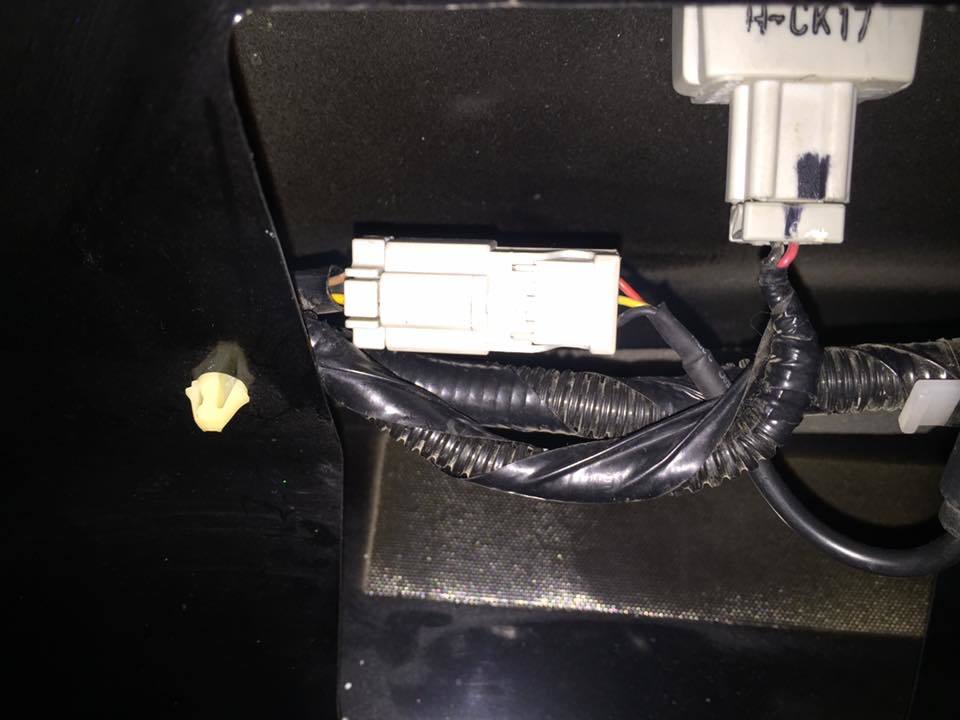

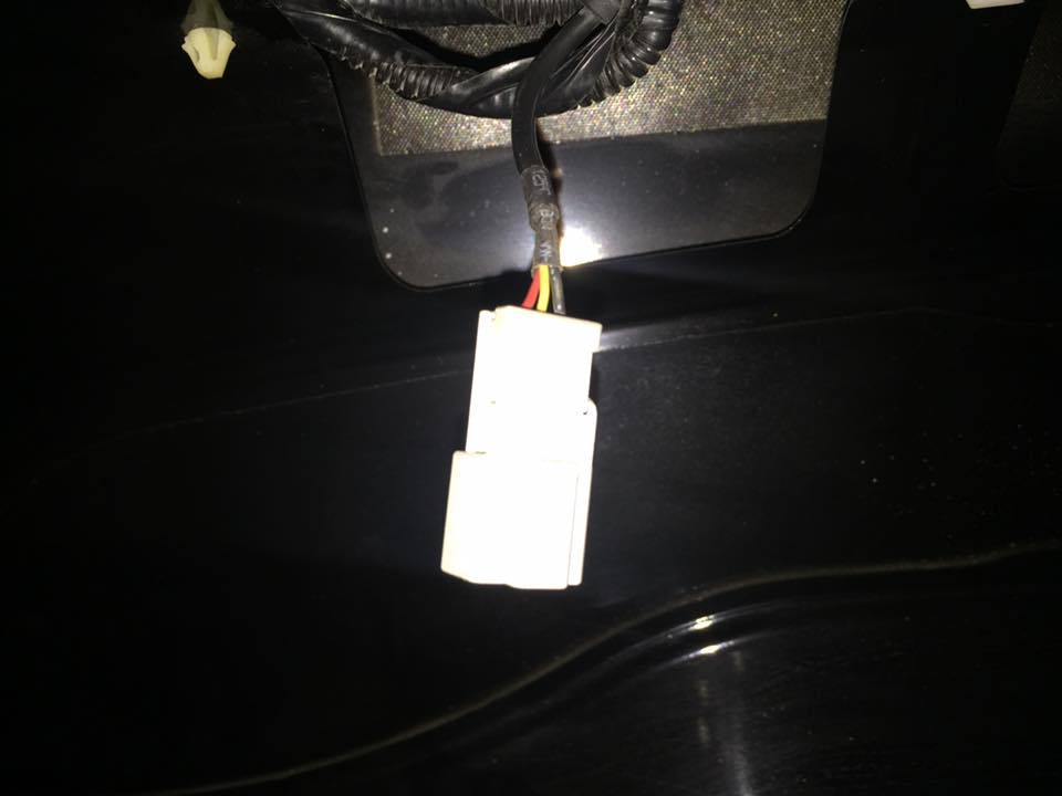

Following are the images I've taken from the camera and the car connectors.
