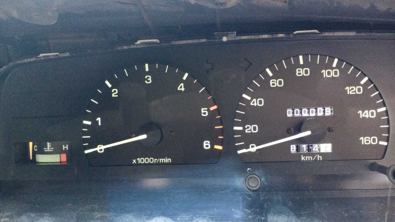

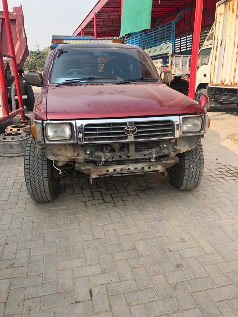

After coming back to Lahore we identified the following problems on our truck:
- The needles on the cluster were dancing around at discretion i.e. Incorrect readings
- Battery needed replacement
- Oil Leak from Steering Gear Box
- Some minor vibration noises around the cabin.

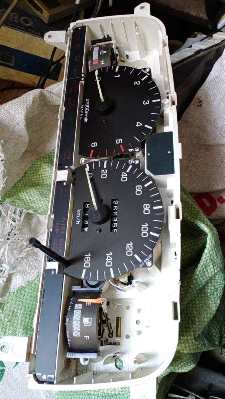

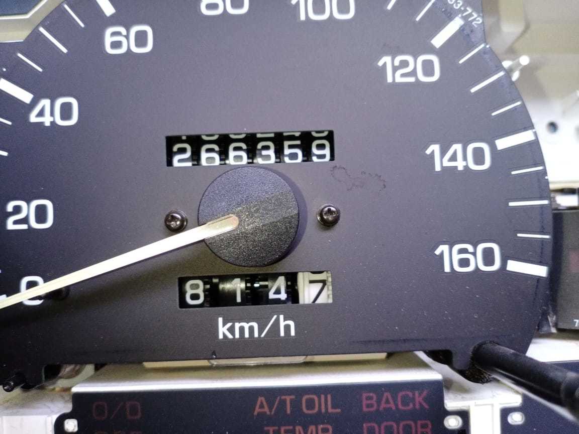

So first of all, we went in for the most important task; i.e. fix the gauges
On an old engine, heat gauge needs to be accurate, before fixation, it was dancing around randomly.

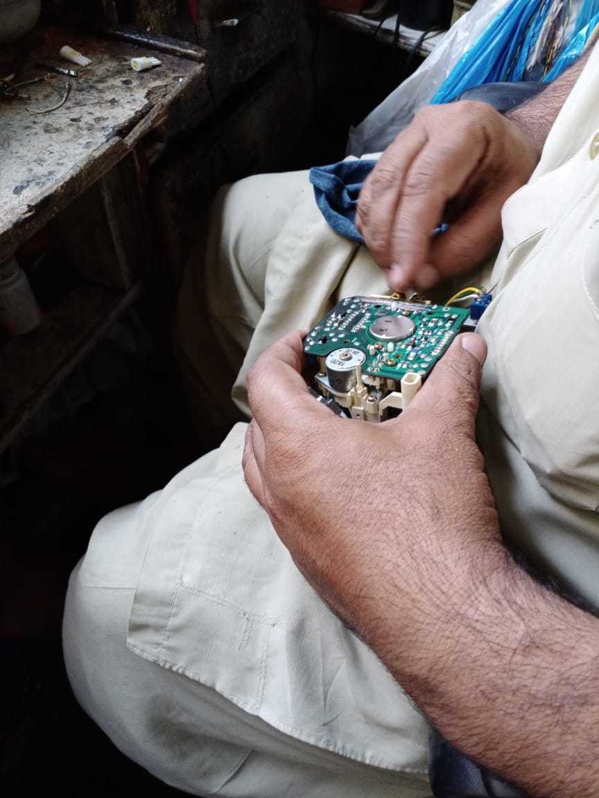

Meter was serviced and cleaned, reading was converted to 00000 in order to have our own baseline readings.
A capacitor was found out to be faulty on the cluster which was not sending out correct pulse, it was replaced and the issue was fixed.
Fixed at: Jubilee Speedo Meter Expert
Contact: 0300-4258017
Google Map: https://goo.gl/maps/wPC7q3svEbdrqyET9
Tasks Performed:
1. calibration of all gauge.
2. Reading was re-set
3. New LED Bulbs were installed to make the cluster look brighter
4. Heat Gauge sensor replaced (engine side)
5. Meter Serviced
6. Meter Lens Replaced
7. Fuel Gauge fixed (Cluster Side as well as Float in the fuel tank)
