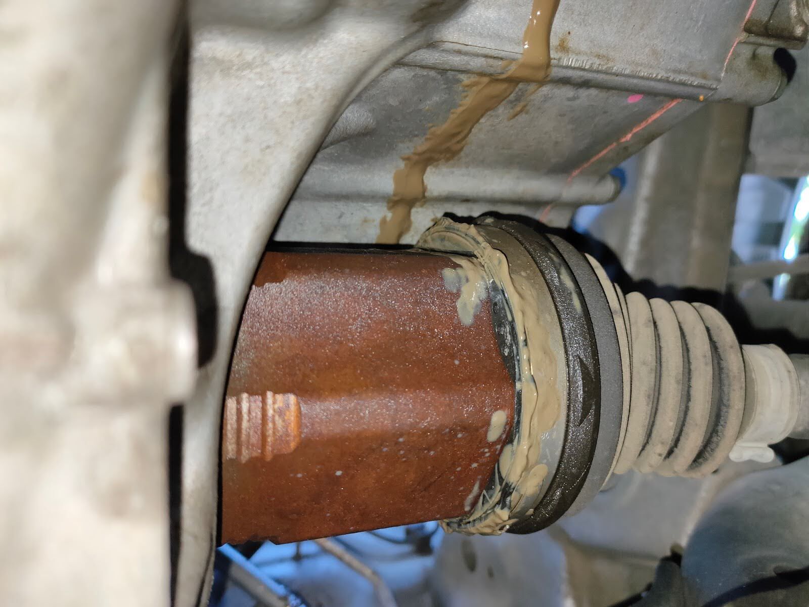

Has anyone had CV failures in their BRVs yet ? It seems water has gone into my my BRV's cv boots ... https://photos.app.goo.gl/QdWjT6Wiwdu7ti9k7
Please explains a little bit more with photos. Link of photos is not working. What do you mean by CV?
Here is the pic. Link is working
Seems like Boot clamp is loosed some how. That is why its leaking. Water can be spilled in during car wash. You should replace the clamp and grease immediately. If the boot (RUBBER PART) is not broken then should be a minor repair needs maximum half an hour. However replacement of boot is a hefty process which requires disassembly of CV joint by a KHARIDIA. HONDA shops have facility of doing this at one place but they will rip you off. Needs immediate attention otherwise joint will start making noise.
I think it's better to take it off and wash it thoroughly to remove all mud and grit etc and regrease. I think the water might hbae gone in during the rains or something... I doubt it's from a car wash but could be... Terrible quality /fitting from Honda though...

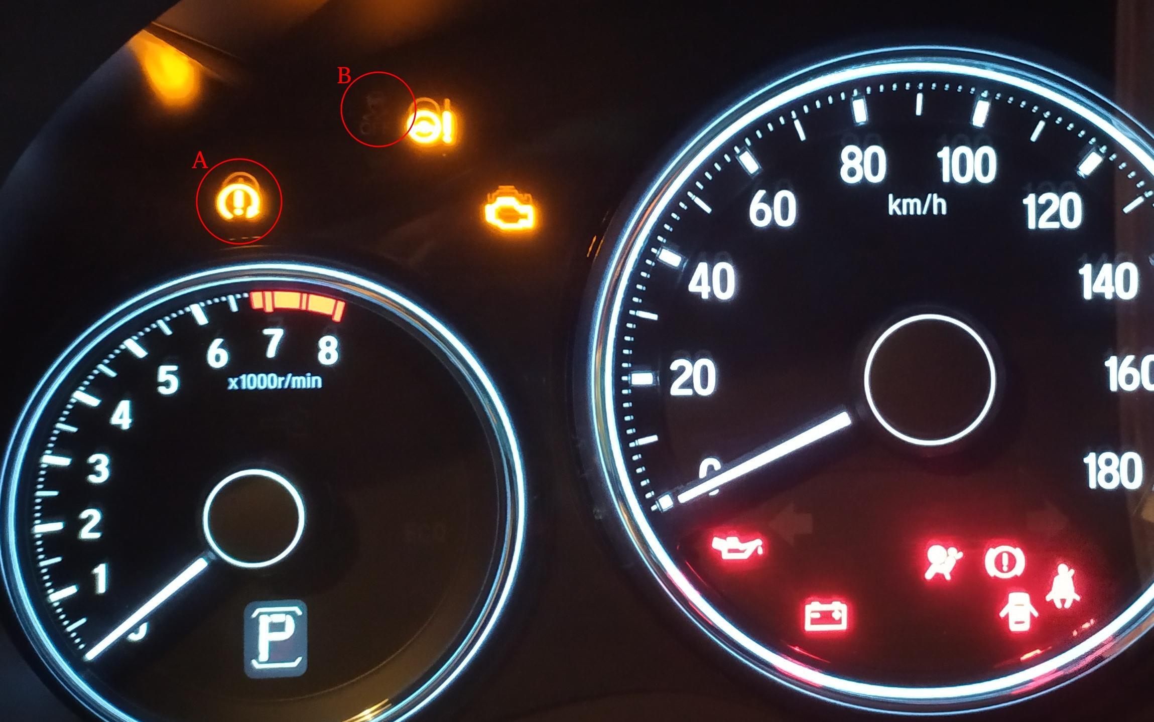

This is the meter cluster when I turn on the ignition in BRV facelift.Can someone tell me what warning light is in section ASection B is traction Control which is not available in PDM BRVI also looked in the manual but could not find any information on this icon.
Starter system
Light B is EPS electrical power steering. Light A is new to me and never seen before.
Circle B is on the VSA/ Traction Control icon which is not lit.The EPS icon is next to it...
