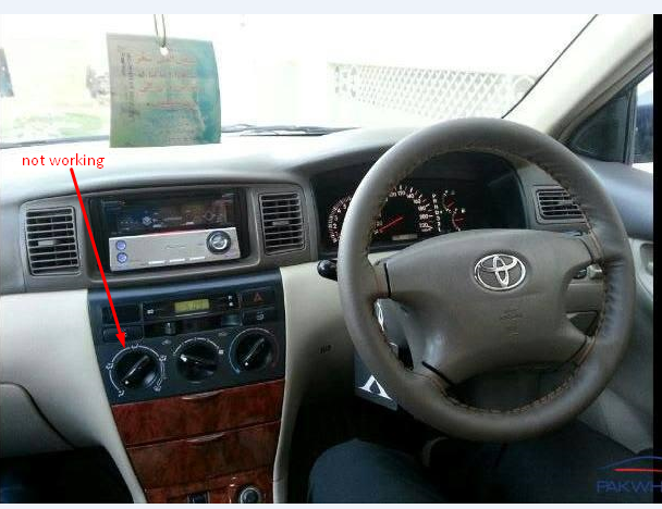

Hi guys hope any of you can help me.I have corolla 1.8 2006 and having issue with it climate control where can i fix my car climate control in rawalpindi/ Islamabad ??
What problem you are having with the air flow directional knob is it stuck , not moving at all or moving freely ?
I guess the motor inside which changes the direction of air flow from Face to feet till defogger isn’t working. No worries you can either the repair the motor or you can change it for 1500.
There is a metal wire which is linked with this button and it breaks up. I had it fixes back in 2010 in just 1000rs from toyota dealership.
its not changing the air flow position.. its keep throwing from front

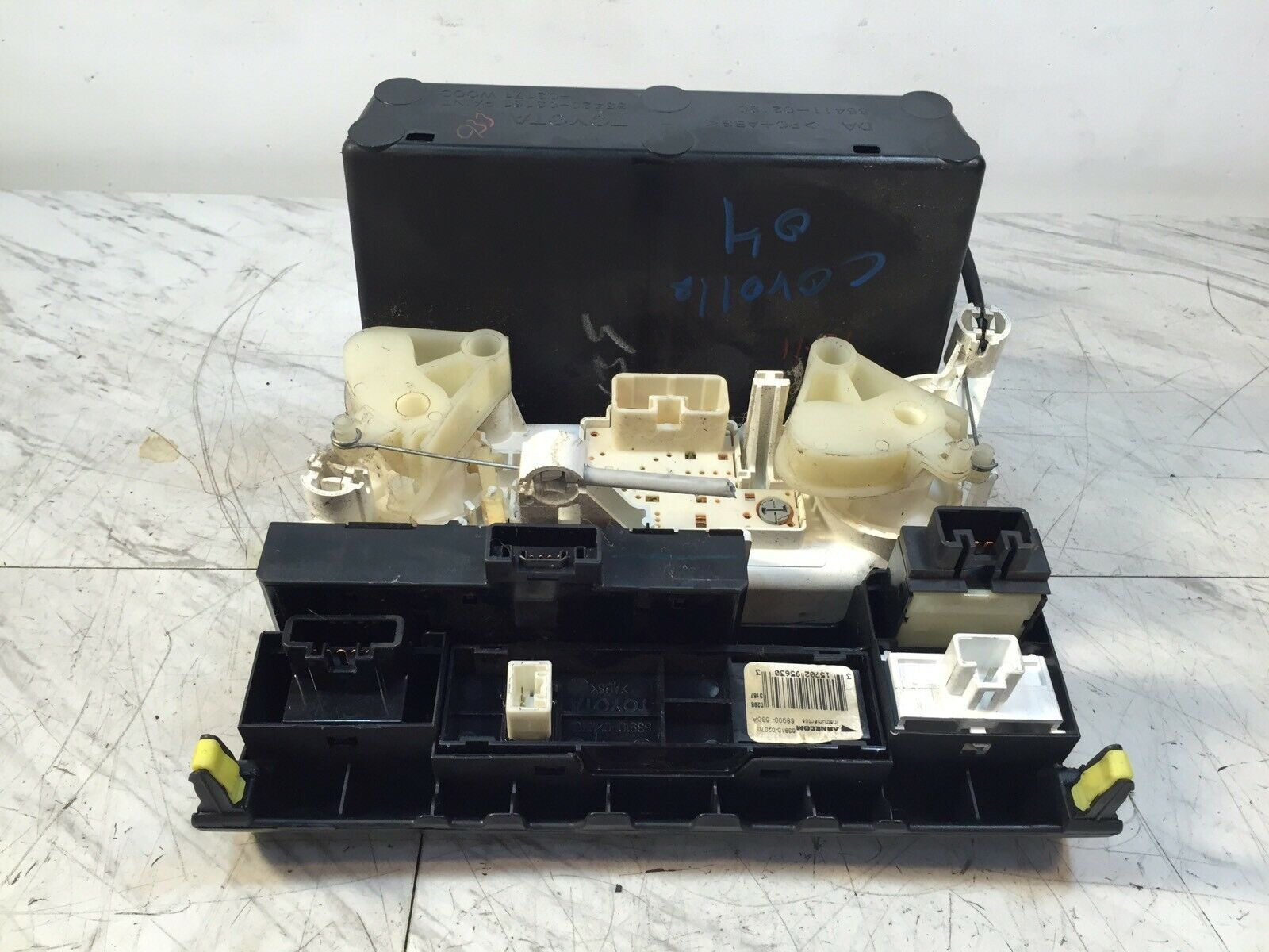

Bro there is no motor in 9th gen corolla both airflow and hot/cold knobs are attached to cables

Yes do visit them. It's just a metal wire that changes ac direction. It breaks up after several years of usage. Mine broke after 4 years. Wire costed 600rs in 2010 and labour was included in the ac service as I was replacing its leaked heater core.

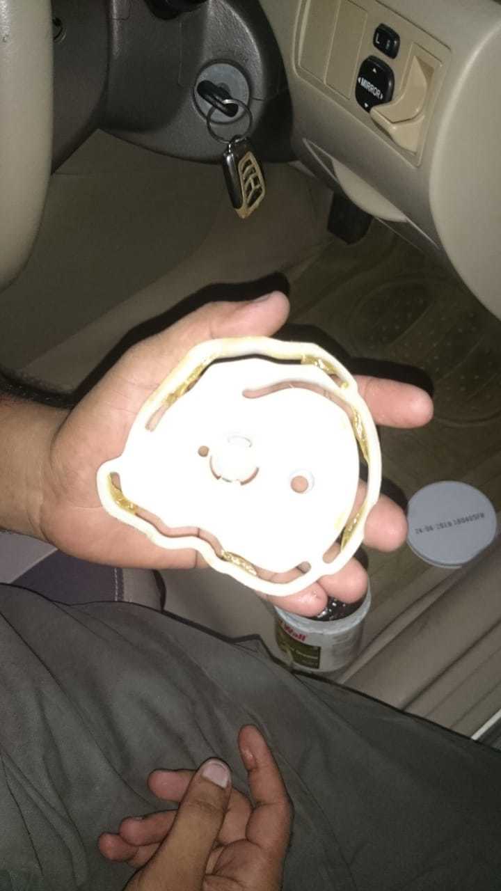

Hi guys : Issue resolved by toyota islamabad motors dealershipIssues identified: metal wire issue. and knob was chocked as wellCost of wire: RS:1250 labor and knob fixed like oiling etc :RS5005% Labor GSTTotal: RS1785
Direction knob pic
