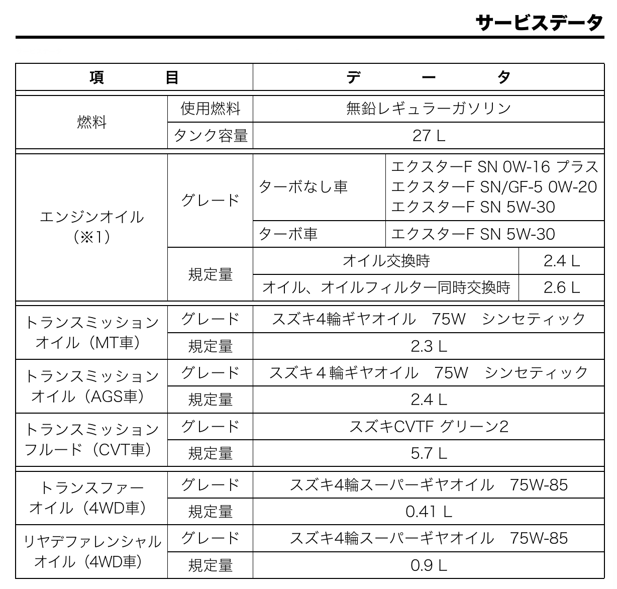

Local User Manual vs Japanese User Manual
The Japanese user manual recommends:
Oil grade: 0W-16 or 0W-20 (API SN / ILSAC GF-5 or higher)
Capacity with filter change: 2.6 liters
But the Urdu manual provided by the dealership says:
Oil grade: 10W-40
Capacity with filter change: 2.7 liters
I understand that oil grades can be climate-specific, but this seems like a significant change. Anyone else notice this? Is 10W-40 safe long-term for the R06A engine?
