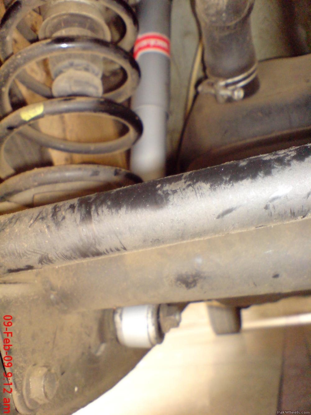

Few months ago in my 06 Alto i feel very soft & bottom ride specially when few person ride at rear with 55 gas cyl and poor cornering at high speed, so then decide i should install gas shocks at rear, i checked Alto's geniune KYB but those was look like too week.
After search I suggest to install KYB gas A-just monotube 552017 shock and Bosch 4 tip for better performance in CNG, need some drill for 17 size bolts, now i feel excellent ride, cornering with comfort & much better engine throttle response with Bosch 4 replacing NGKs.
(note! Sentro owners, after seen best result i install these shocks in my cousin's SENTRO also, now its ride much better than stock, these shocks improve cornering, handling & braking, Alto & Sentro rear shocks size is same)
