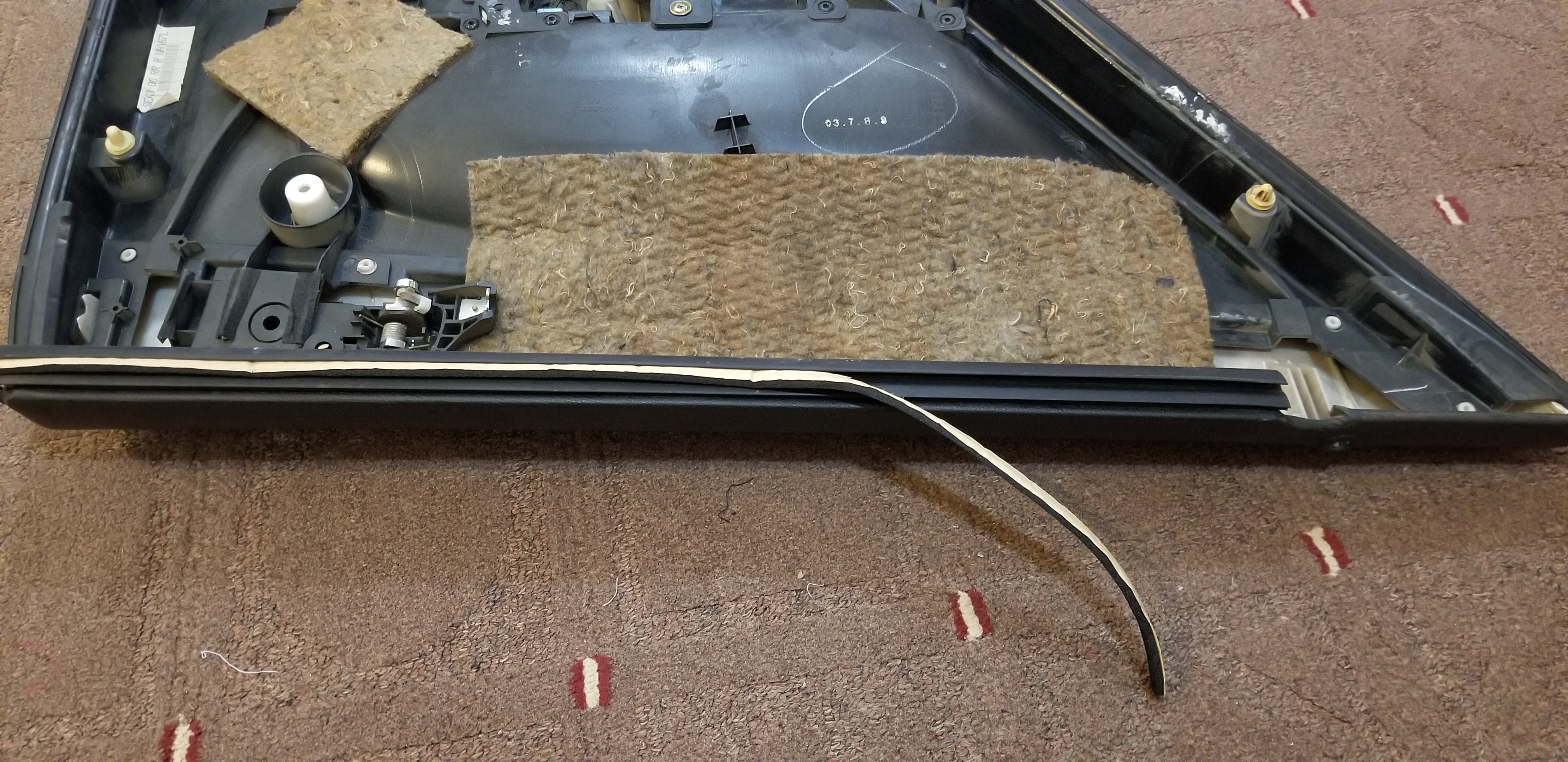

If you're talking about Lancer then I'm surprised. I kept 2 Lancers between 2006 and 2016 and never got an interior rattle. I have acoustic cell foam tape from AliExpress which really helps with interior rattles - hard part is pinpointing those but, once discovered, that tape can be wedged between them (out of sight) and really works well.

This is the one I use, got it from AliExpress. Its made of closed cell foam and can be cut and compressed to fit between 2 panels which stops them from vibrating against each other and producing noise. Glad to hear that you are using a nice sound system, though in my little experience I found Lancer's stock system to be the best one I've heard.
And this is the kind of material its made of (closed cell foam). Does not absorb water, so longevity is great.
