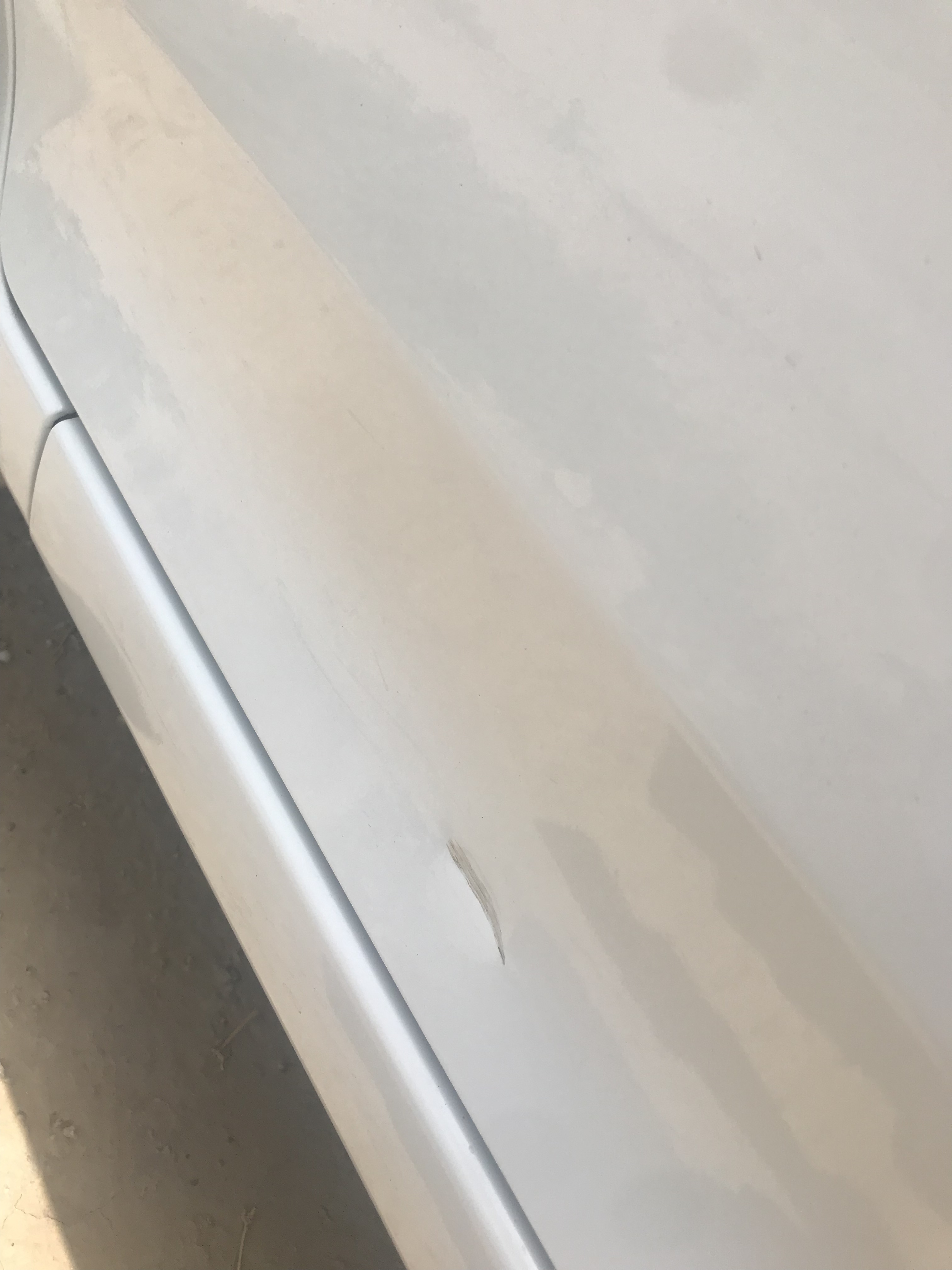

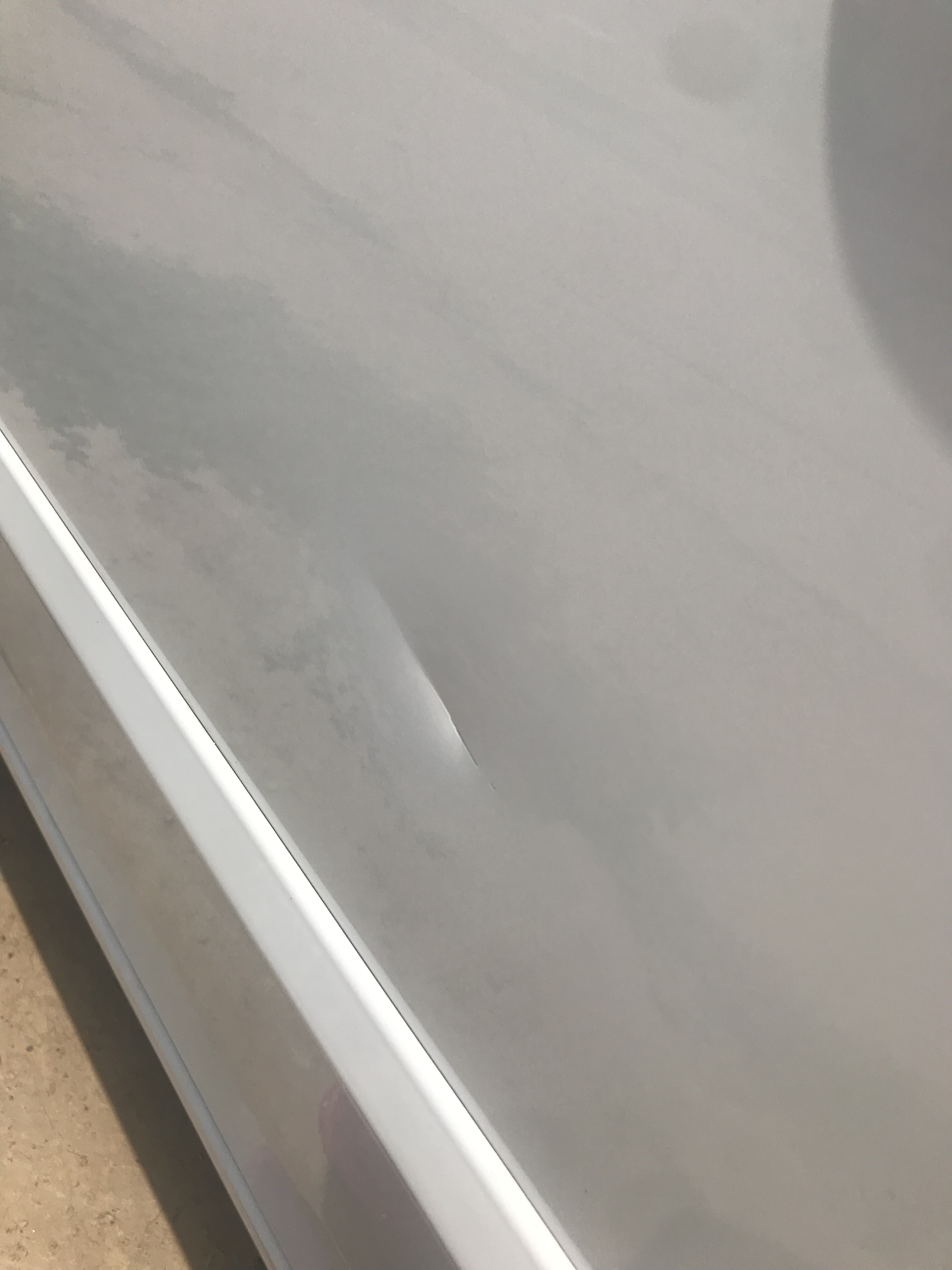

Metallic paints don't have pearls... Pearls are different type.. Metallic is different sir.
And secondly dry denting is just a jargon to snatch good amount of money... While we know dry denting or any denting does not makes the surface fully smooth. So paisay dekar agar silwatein hi dekhni hain dubara to either live with this or either get it Done properly...
Second thing yeh match nai horaha time lagta hai matching me is just a technique to earn good amount of money by saving more in material...
Like i go to paint shop buy the paint of the colour code mentioned on chasis plate. And buy it in Nexa or sikken or any good brand. And then if i paint that particular portion it will easily match in metallic and solid. But for pearl you need to spray the hardener lacquer on whole piece to get accurate touching...
And i have learned everything myself so that's why sharing this experience with end users like you..
So always keep the information I've mentioned above in mind...
