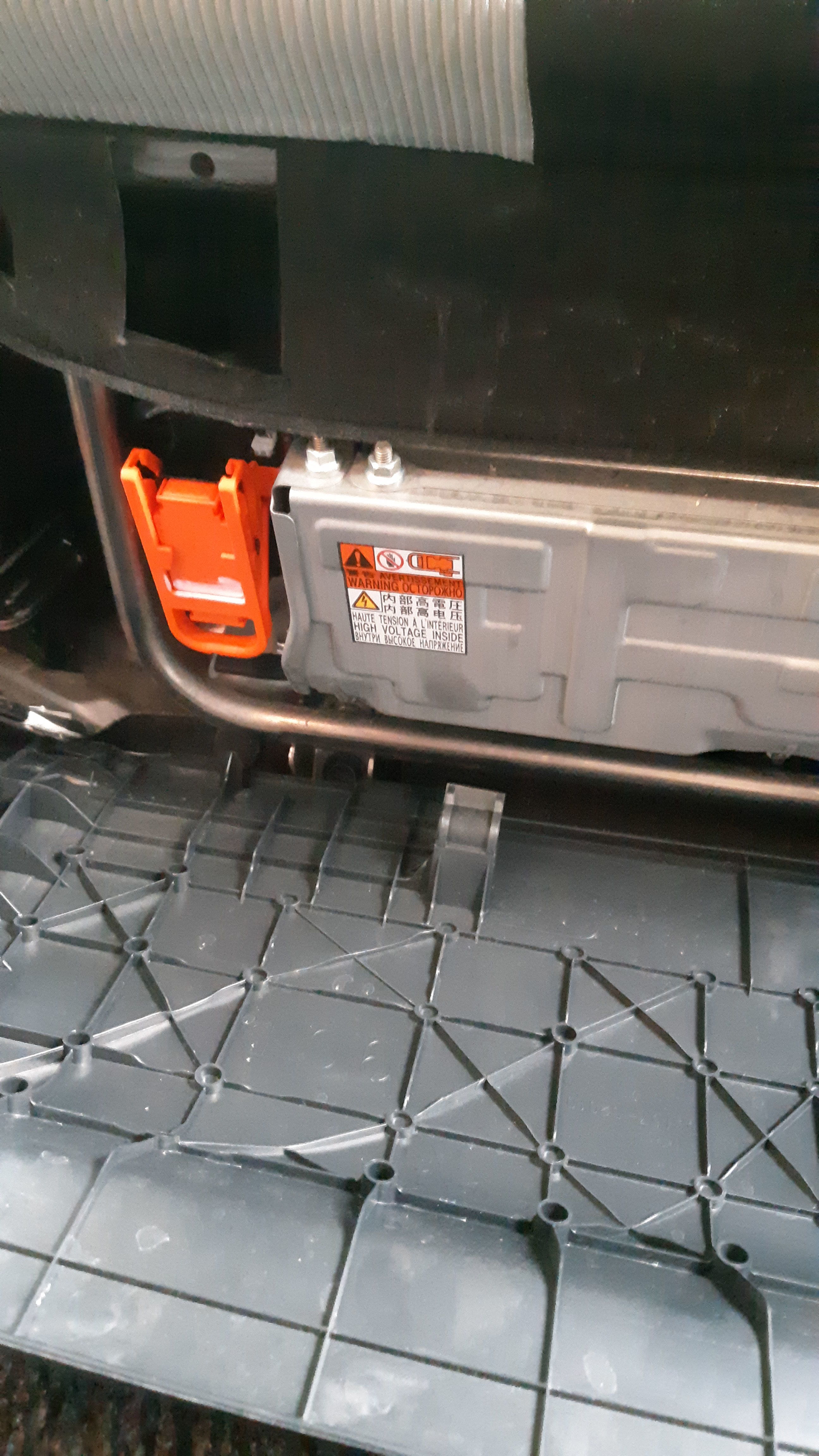

There's a hybrid safety plug (orange color) between 12V battery and Hybrid battery packs (under back seats) which was in unlock state instead of lock state, preventing the car to start. I believe the detailing guy switched it by mistake while cleaning this area. Someone on Pakwheels Facebook group mentioned to check it and it worked Thx guys
How come detailing guy took off the cover and pulled out the plug..
He must be trying to be over-smart by cleaning every corner of the car
