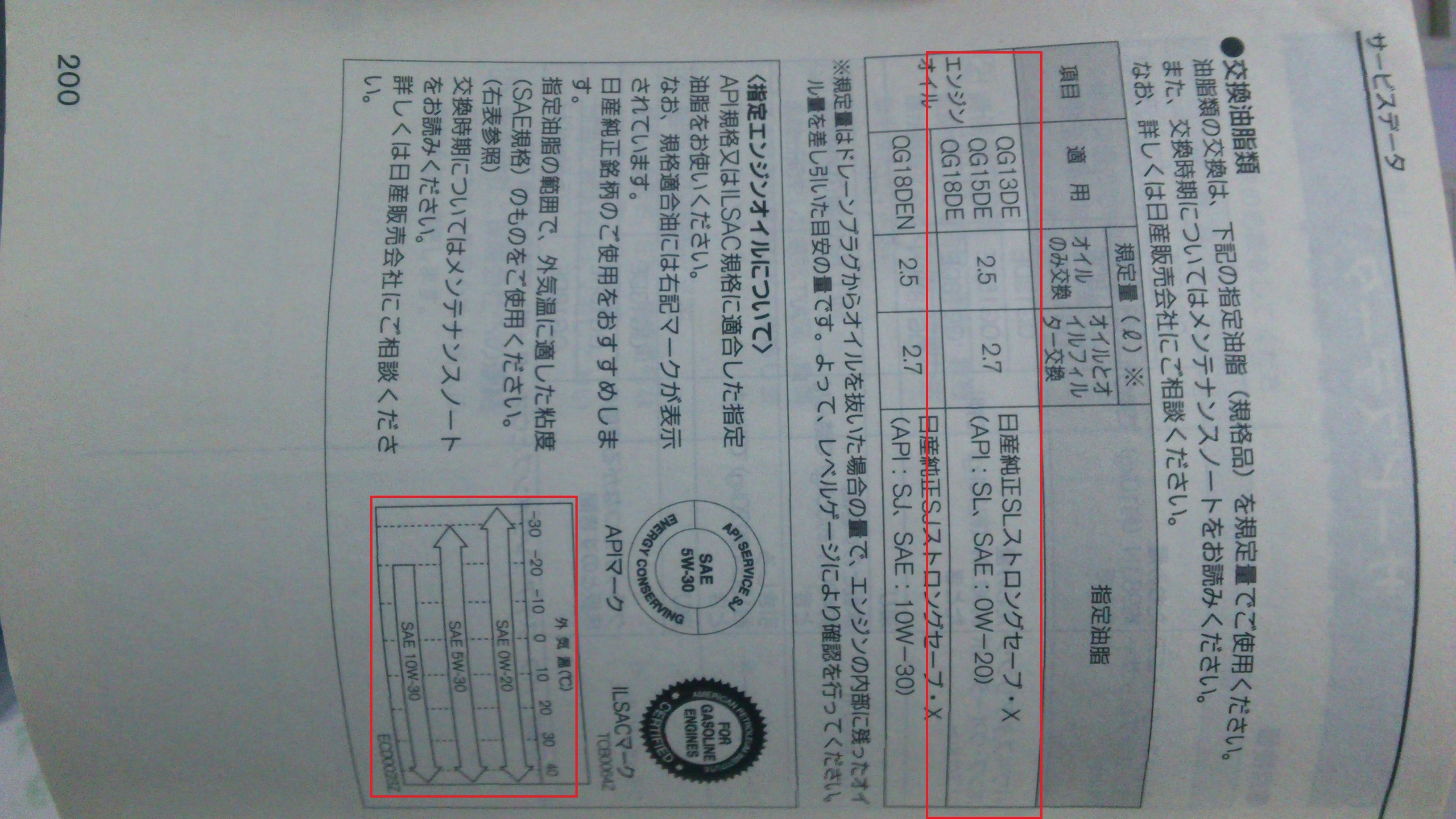

I own an Nissan AD van, model 2006 having QG13DE engine (JDM). The engine has clocked around 230k kms and for the past 6 years i am using havoline formula 10w-30 oil in it. Yesterday i got my hands on its owner's manual through a friend and I was surprised to know that they recommend 0w20 SL oil for this engine. Can I switch to said viscosity at this stage of engine life. Overall engine health is fine, no oil loss, no blue smoke at exhaust, coolant in radiator throughout, fans are auto and thermostat in place. Average fuel consumption remained around 11 to 12 km/l in city/highway mix driving. I want to improve fuel consumption and engine response by adding thin oil but hesitate to do due to engine's age and the use of higher grade oils previously.
And also 0w-20 SL grade oil is good for temperatures between -30 to 40 + degree centigrade as per chart whereas most of the people including me relate the oil grade values to temperature values. Is it correct method.
