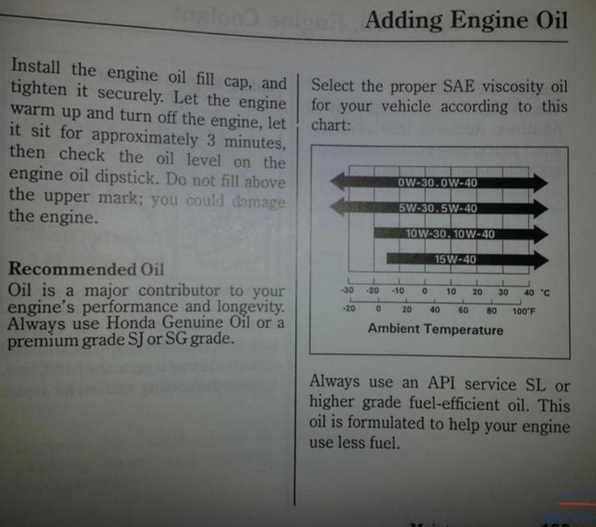

What does your car manual recommend?

This is a picture of the owner's manual taken from pakwheels because i don't have mine with me right now.. i'll check it when i get back home in a few hours.

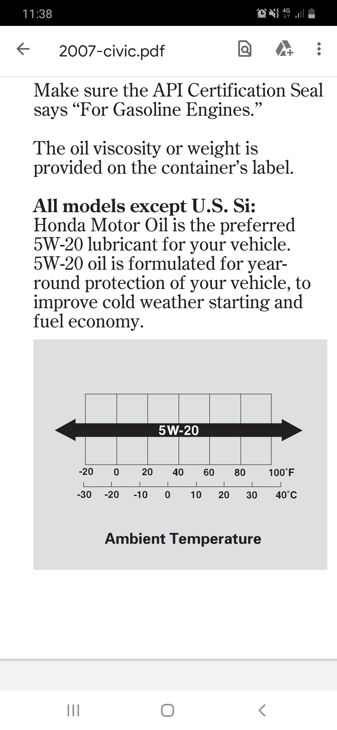

The reason i am confused is that for this same engine 5w-20 oil is recommended in other parts of the world. Wouldn't it ok to use in pakistani made civic too because r18 engine is the same everywhere?

There is more stupidity on the page, one on side it says to use API SG and SJ oil which was obsolete even before the launch of the R18 engine, and on the other side it says to use API SL only.
Looks like the internee hired to copy paste this material into a book at AHMCL had a devdas moment.

Xulfiqar bhai, i felt the same way after seeing this owner's manual. So i will just go ahead with the 0w-20 oil at the next oil change which is due in a few days. Everyone's been telling me that 5w-30 is the recommended grade but i think the motor will run just as well if not better on 0w-20/5w-20 oil.
