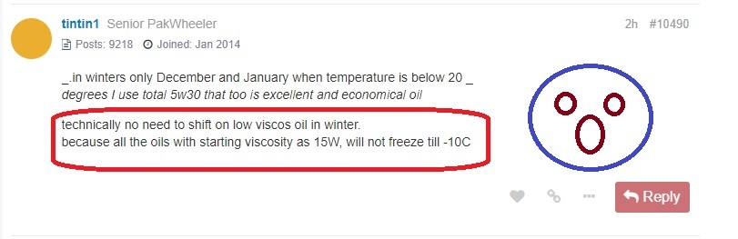

V true me too using it in summers in my daewoo racer and my car loves it....also its economical too .....and engine is squeaky clean....just engine should work on optimum temperature I.e thermostat installed and auto fan......but fake copies are present so beware u buy from right place and confirm the counterfeit code present on it to ensure its originality.....the most funny thing is the oil changer are afraid to put in car and when I start it they stand far from it as they think it might explode 🤣🤣......my drain interval is 5k km.....and I use guard oil filter.....in winters only December and January when temperature is below 20 degrees I use total 5w30 that too is excellent and economical oil
Yup but my car give hydraulic lash sound for 10 seconds in winters morning when temp is 0 degree so that's why I shift otherwise remaining 10 months its perfectly fine......i have even used shell helix ultra in it but delo is economical as well as equal in performance in my case

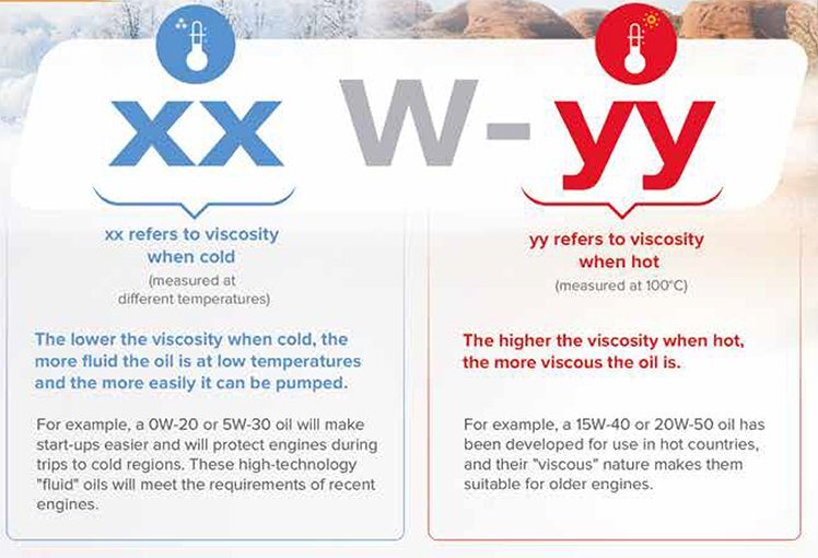

15W is viscosity ?

problem is you are misleading the masses.
viscosity at ambient cold outside temperature shall be THIN low as OW or 5W
not 15W as per simple language in your post
you are chewing up the words and using excerpts from main phrases to please yourself.
i thought you must have sobered during pandemic and have spent time in gaining some real wisdombut you are a total disaster.
