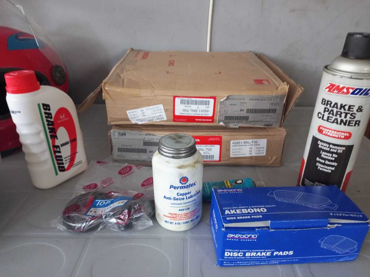

More than a month ago I did a diy front brake job. Items that were changed were:
1- Rotors (OEM got them from the honda dealership)
2- Akebono Brake Pads
3- Caliper slide pin boots since old ones were worn out. They were not oem since dealership was out of stock.
I didn't change the brake oil since it was already dark and was tired. For reference brake oil was changed around 1.5 years ago.
I've been to monal many times and never experienced this kind of this noise. There is no sound in city driving or even highways. The journey to monal is steep and the brakes get hot on the return journey. I was wondering if this could be due to the new rotors or is there something wrong?
Here is the pic of brake job for reference.
