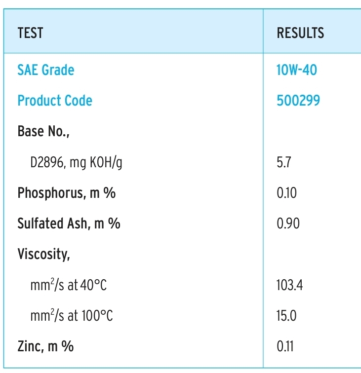

I've used Shell HX6 10W-40 SN, Valvoline SynPower 5W-30 SN (10.1 cSt @ 100C, oil pressure light when warm, had to dump it) and I'm now using Havoline Extra 10W-40 SL. The PDS for Havoline Extra says it should have 1100ppm zinc, if I'm not mistaken, so I should be fine. The oil seems to have performed well over the last few months and 2000km.

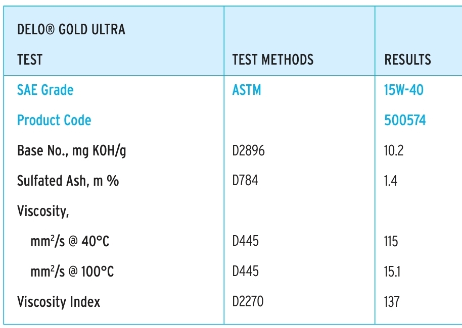

I've been thinking about switching to Delo Gold Ultra 15W-40 SL, but the PDS doesn't show any specs for zinc content, even though the TBN is 10.2.

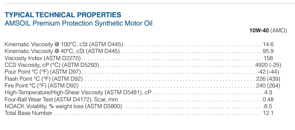

Alternatively, I wanted to try AMSOIL's Premium Protection 10W-40, which says it's backwards compatible up to SG and has a high zinc content, although the exact amount isn't specified, nor could I find a VOA - but the TBN is higher at 12.1.
