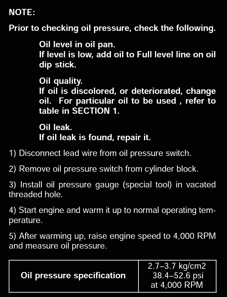

Small update: Jameel Autos (thanks to @capsat for his recommendation) had an analog oil pressure gauge. Incidentally, my engine was the first time he'd ever used it.
48 psi at the oil pressure switch at 4000rpm hot unloaded, which is fed directly from the second crank journal. So within spec (38.4 - 52.6 psi) according to the engine manual instructions to measure at 4000rpm.
Uploading...
At 1000rpm hot idle, 6 psi.
Since the engine instructions don't talk about oil pressure at idle, I'm assuming everything is fine. What do you think? @Xulfiqar
