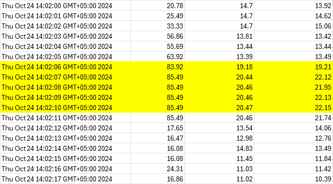

I have verified ECU adjusting IACV duty cycle with load i.e. it goes from 20-22% to 40-42% with increasing load. What's the range though, how high can it go? Is ECU not adjusting enough.
