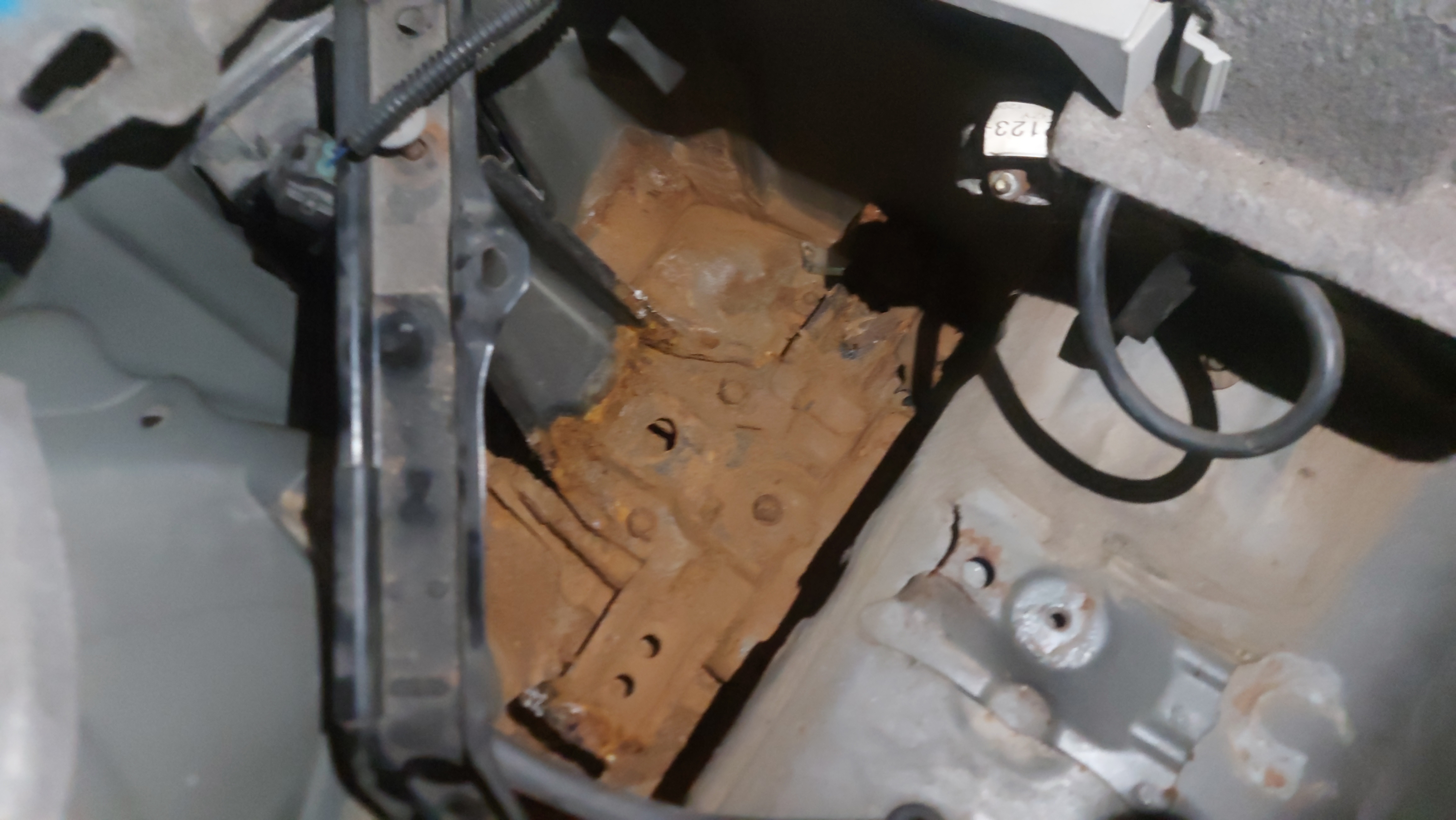

Iāve noticed some oil seepage under my Mehran EFI during an oil change. Three different mechanics checked it ā all say itās probably the main seal leaking and that the engine needs to be removed to fix it, though one mentioned it could be from the oil chamber.
I remember you once said mechanics can usually identify leaks, but either they donāt want to or arenāt sure ā and in my case, I have limited options.
Right now, the oil isnāt dripping or reducing, but I wanted to ask ā can this kind of seepage get worse over time, or is it safe to keep driving while monitoring oil levels regularly (e.g. morning and a few times on long trips) as I don't want to keep the car for more than 6-7 months from now?
For background: about 4ā5 months ago, my car overheated once (not severely). The mechanic then made the fan direct and removed the thermostat valve. Soon after, I noticed a gear oil leak, got the seal fixed, and changed the oil. Around two weeks later, this engine oil seepage started. Now thereās also noticeable vibration in the steering ā the car feels heavier and not as smooth as before. Could gear oil leaking, engine oil seepage, vibration, heaviness are all the after results of overheating?
