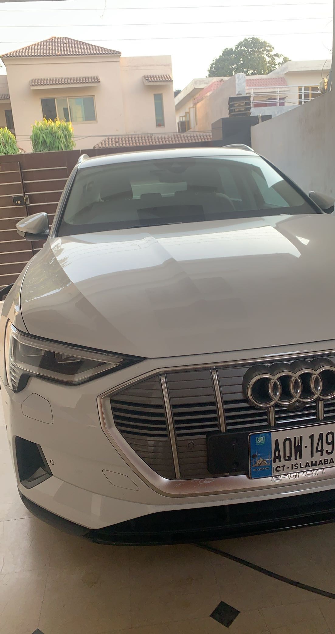

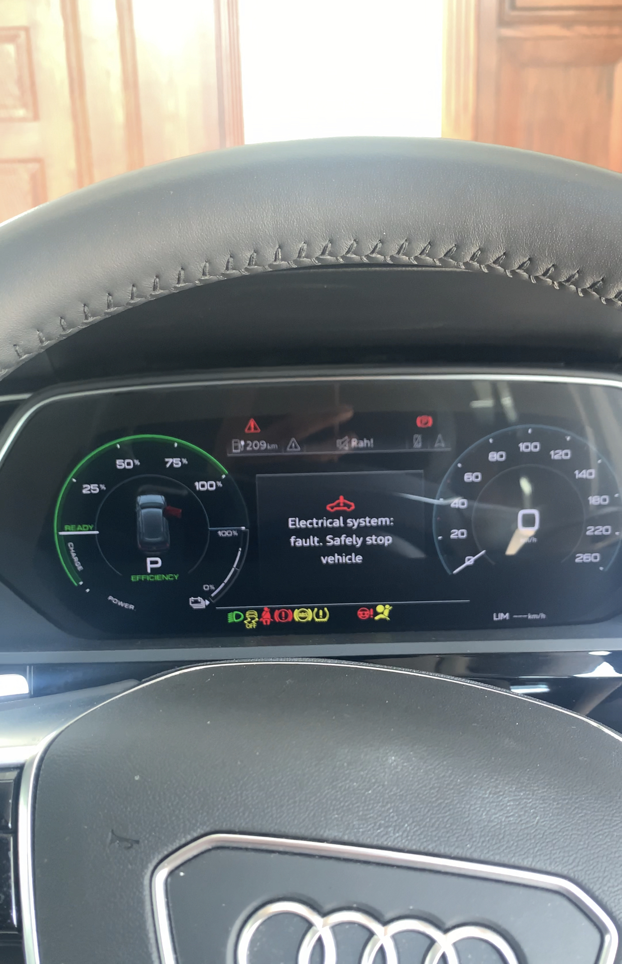

AOA I just wanted to tell you that this is the error which came out of nowhere in my audi e tron and i called a person from audi lahore he said that we need to pickup it in recovery cause this won’t work anymore like seriously this is 1.6crores this must not be happening People buy expensive cara just because they want to be comfortable not like having issues like thaT I WANT YOU TO POST THIS AWARENESS FOR OTHER E-TRON OWNERS IG I REGRET ABOUT BUYING THIS IN PAKISTAN I HAVE AN A4 BUT I DONT THINK SO THAT E-Tron was much successful car
Is this 2019 model? There is a recall for 2019 e-tron for faulty battery that could cause fire.
Moisture in the high-voltage system can cause a short-circuit, increasing the risk of fire. If warning lights appear along with the message "Electrical system: fault," immediately stop driving the vehicle, park outdoors away from structures, do not charge the vehicle, and contact Audi Roadside Assistance to have the vehicle towed.
