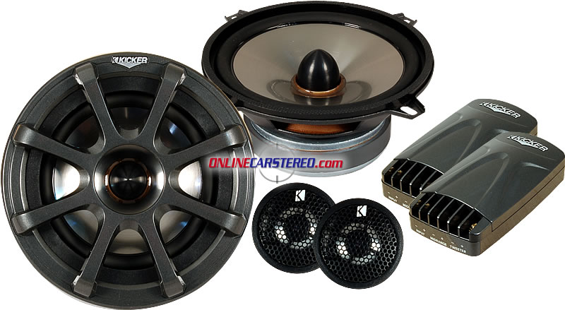

this is the component set will be used on the second door
Model KS50.2
Woofer (in., cm) 5-1/4, 13.0
Tweeter (in., cm) 1, 2.5
Max Rec Amp Power (watts PEAK/RMS)* 130/65
Sensitivity (dB 1w/1m) 88
Frequency Response (Hz) 38-21k
Woofer Hole Diameter (in., cm) 4-9/16, 11.6
Woofter Mounting Depth (in., cm) 2, 5.1
Crossover Point (Hz) 4.0k
Crossover Slope (dB octave) 12 hi/12 lo
Tweeter Attenuation (3Db steps) 0/+3/+6
