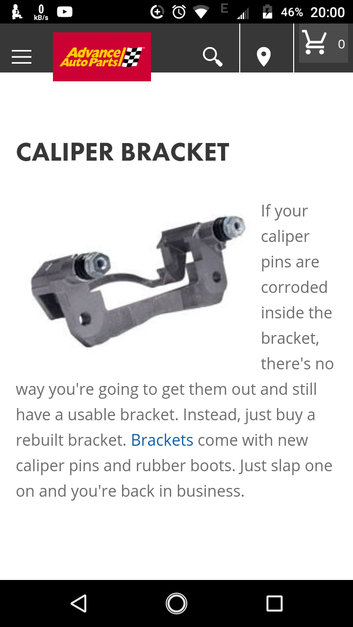

Awaaz aati thee jab gaarhi chalti thee us kee pins lose thee
pins me bush hote us ki. rubbers etc wo change karwa dete 200,300 ki ilti hain. means ap regular break service nahi karwate. regular means alteat in 6 months.
According to him woh change nahi hotay
bushes or rubbers caliper pin k change nahi hote ? seriously ? according to him agar change nahi hote tou ap kaha they bhai ? us ko bolte wheels wapis band kardo
caliper rebuild kits are still sold - and toyota calipers are very easy to rebuild - Do not trust scrapped parts blindly.
Yes Sir I learned a lesson after driving my car with jammed wheel
This part fails when your average naswaar or gutka chewing moron uses chassis grease to lube the two pins and boots.
It takes silicone grease only.
Hmm actually I always prefer for OEM parts but here in DG Khan neither parts are available nor mechanic is willing to use OEM part.
These ustads have never even heard about Silicone grease.
