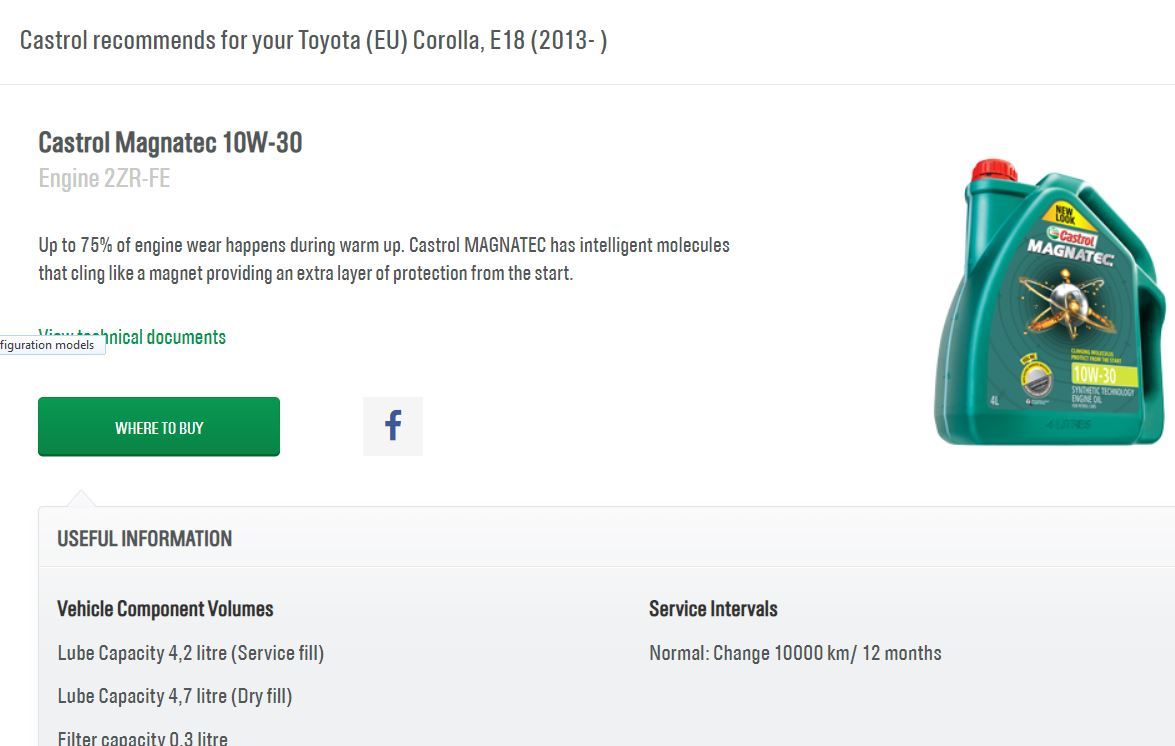

Toyota sell the 2ZR and 1KR across the globe - they have the same oil 0W20 oil spec for anyplace on earth. UAE is not special no matter how much gulf news you read.
