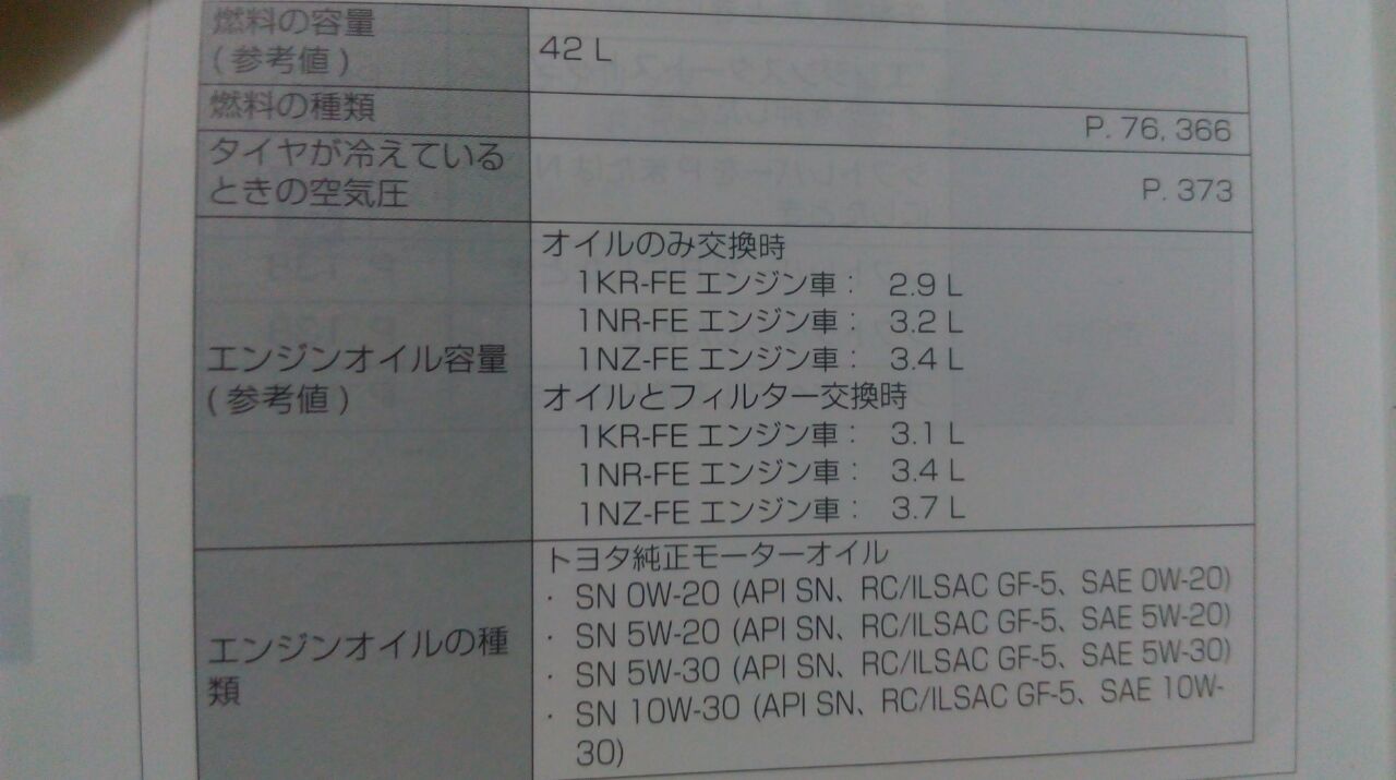

Quantity?? How much liter
3 litres ... actually in owners manual its mentioned 3.1 litres with filter but 3 litres sy b kaam chal jayega ! Here is a screenshot from owners manual.
I would like to inquire about my 2014 Toyota Vitz with a 1-liter engine capacity. I usually put in 3 liters of oil, but some people say the tank holds about 3.5 liters. Could you please clarify this matter for me?
