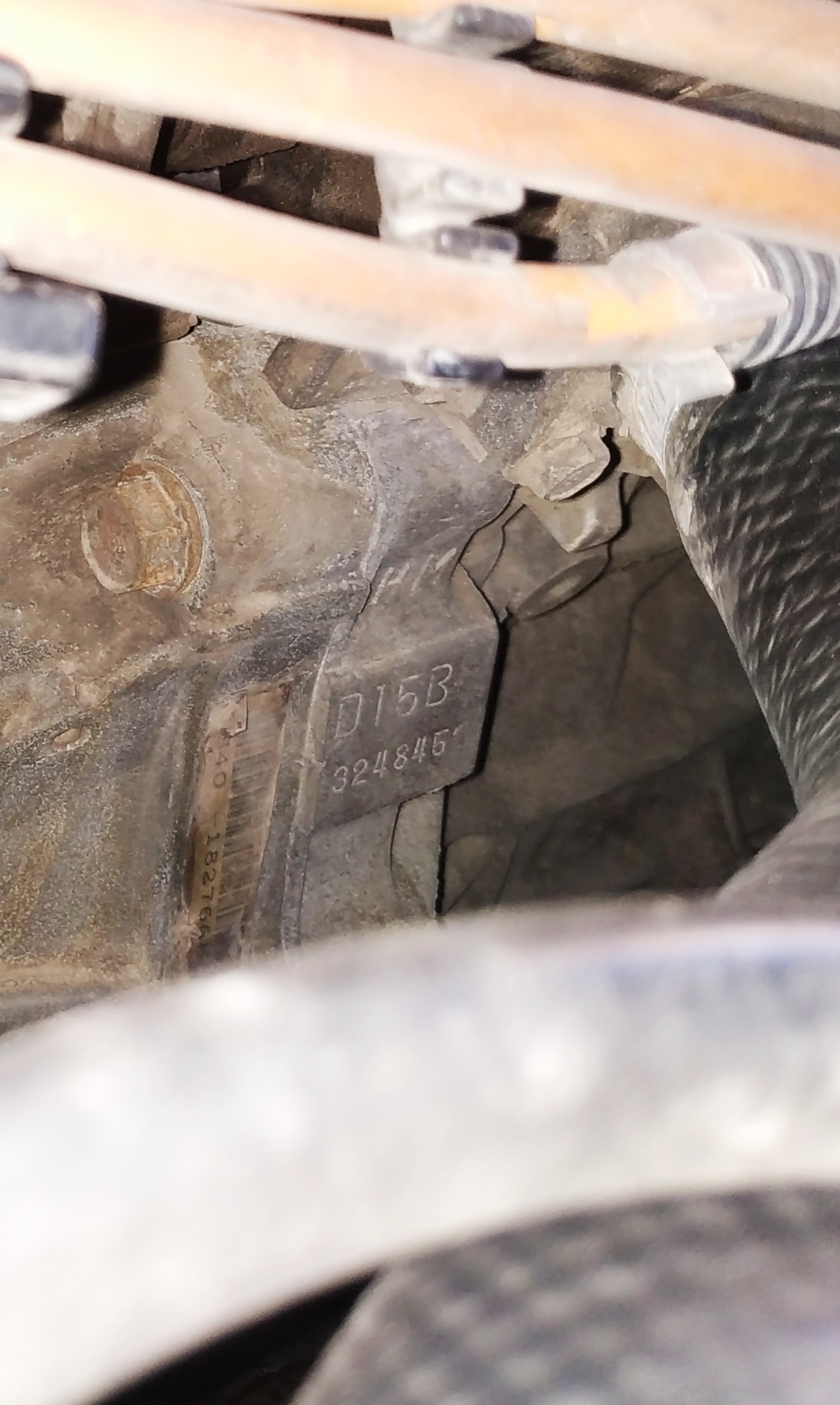

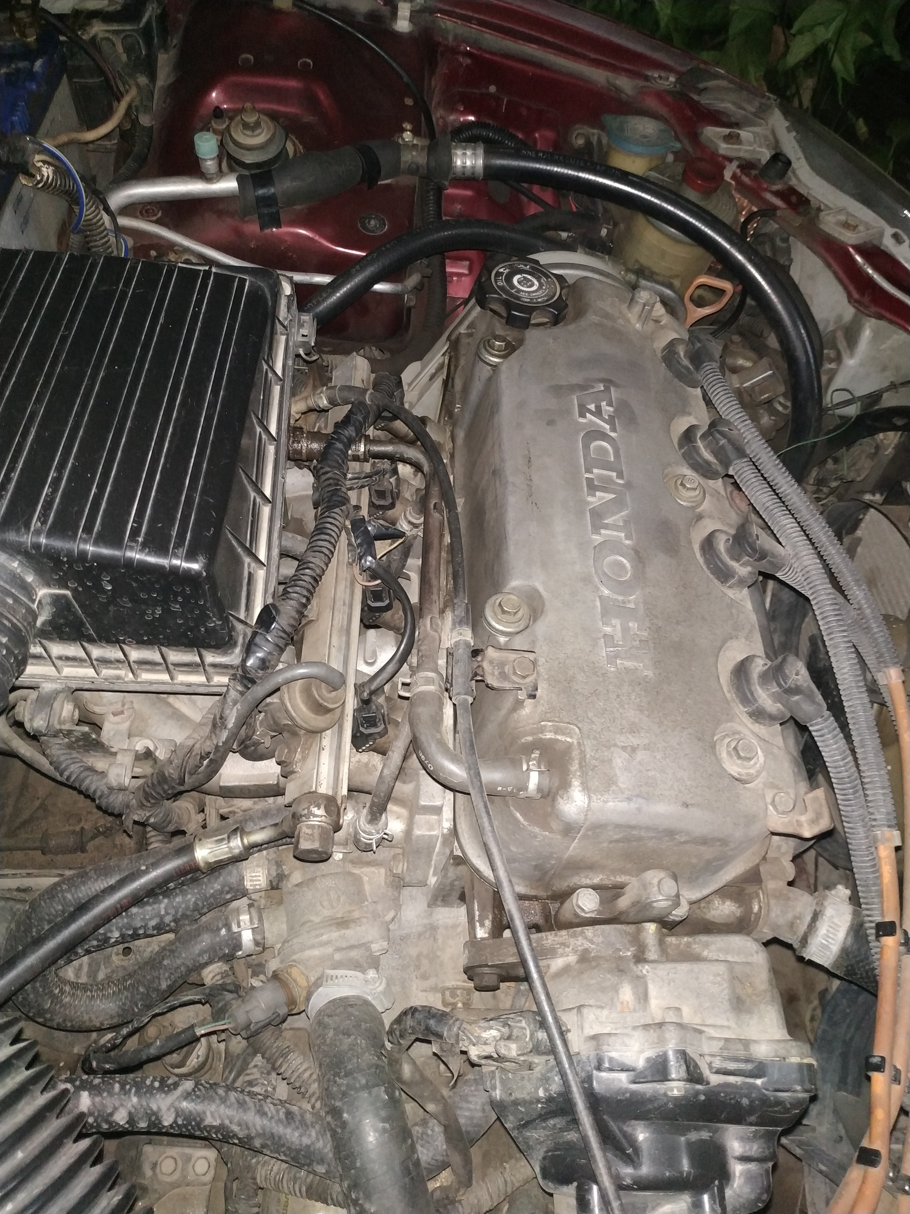

Rightly said. Actually its engine is swapped with d15b by previous owner almost 5-6 months ago according to him. I was told its vtec engine but when I started reading pakwheels forums about vtec engines having solenoids I checked the engine of my car and found no solenoid.
First confusion is to clarify what engine is being installed on this car.
Second is whether the wiring is according to the engine.

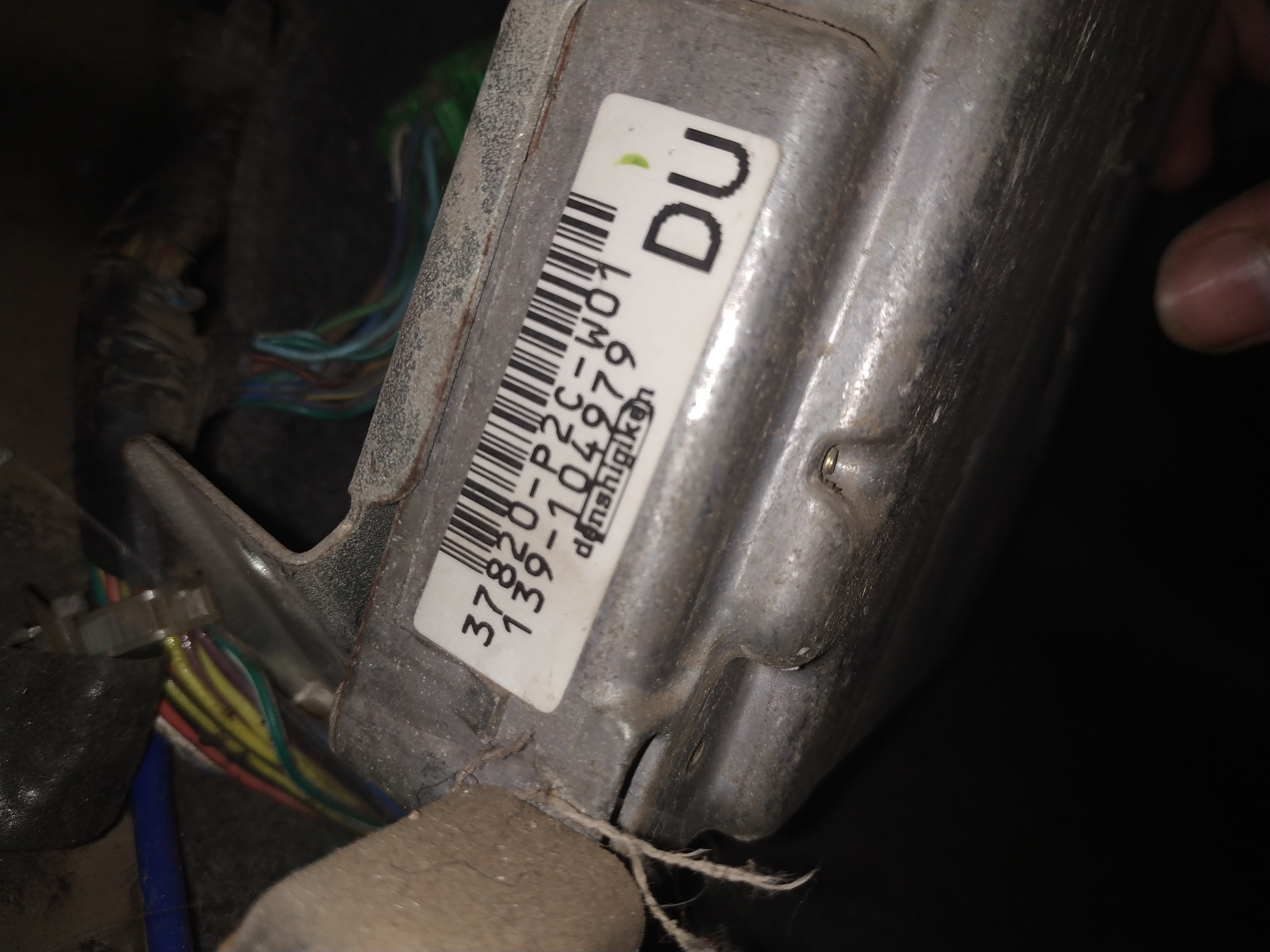

Third whether my ECU is compatible with this engine or not. My current ECU is 37820-P2C-W01 (DU).
I found no details about this ECU on pakwheels.
The reason behind this enquiry is experiencing 7km per ltr mileage. And secondly on AC there is sound of knocking sometimes while accelerating. Previously knocks can be heard on lower gears but then I used STP additive and the sound shifted to upper gears now. Sound is not usual though.
AC electrician made the fan direct. Knocking felt better but now its same. I read here that direct fan is not a good practice.
