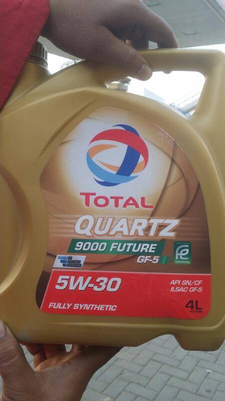

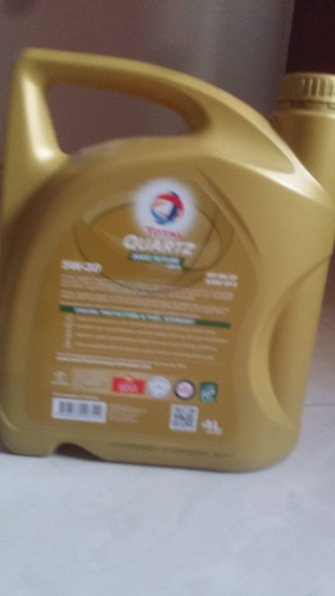

Thanks guys for help yeah i did research all the times but this time mistake done anyways i just changed the oil to total 5-30w fully synthetic i bought it from caltex pump at gushan-e-iqbal block 2 cost 3070Rs 100% genuine local shop owner selling it on low price but those oil is not genuine, Yup 5w 30 is a oil for new cars i read the calted oil guide lines over there it gives you 9000km per oil change and one more thing i tried har to find 0w20 or 5w20 but fail so i went with 5-30, I just attached the pictures of oil cane have a look.
5w20 is available in Zic, it's called Zic A+Anyhow 5w30 is good. Also change oil filter as well. Inspect air filter too, if needed change it as well.
Still not recomended oil by toyota japan for mira e.s.But atleast better than previous one.Us Pakistanis will never opt for company recomended stuff. Bec we all our selves are brilliant Inventors and Engineers. Wish your car runs fine for ever. Good wishes
