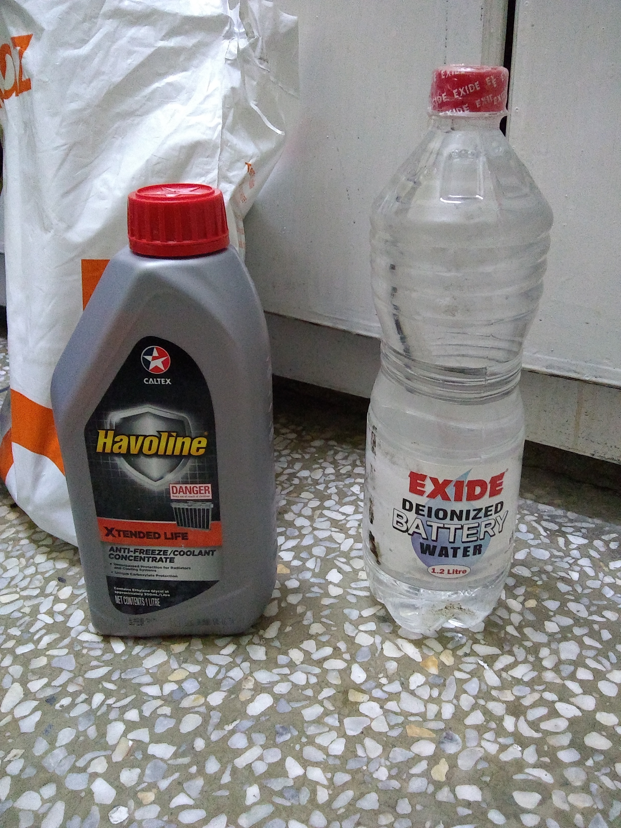

Draining the radiator, then flushing the entire system until water runs clear with the engine running. Then drive for a short while and drain again. Replace with LLC coolant concentrate, using the volume in the block to calculate the amount needed to give a 50:50 mix.
(It is best to use distilled water for this flushing.)
