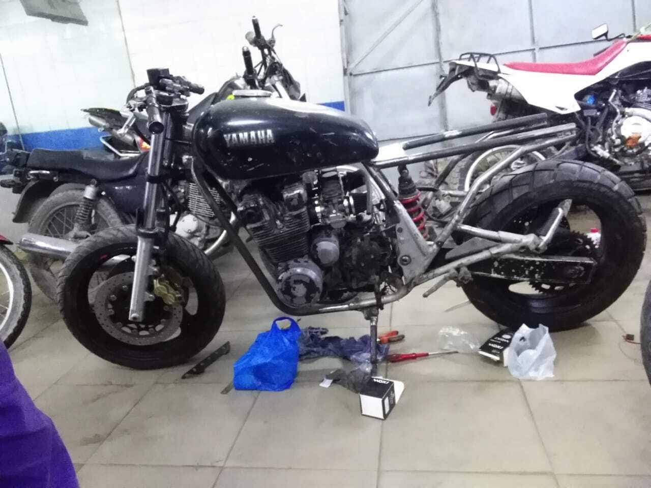

prefer to use a chasis which is registered we made a custom chasis 6 years back and used the NECK (gatta) of paiggio Storm 125
see below all the chasis was brand new custom built... onces you are done bike ka CPLC kerwa lien takay documents update kerwanay men ap k pass CPLC or laboratory ki report mojud ho
hope this helps..
