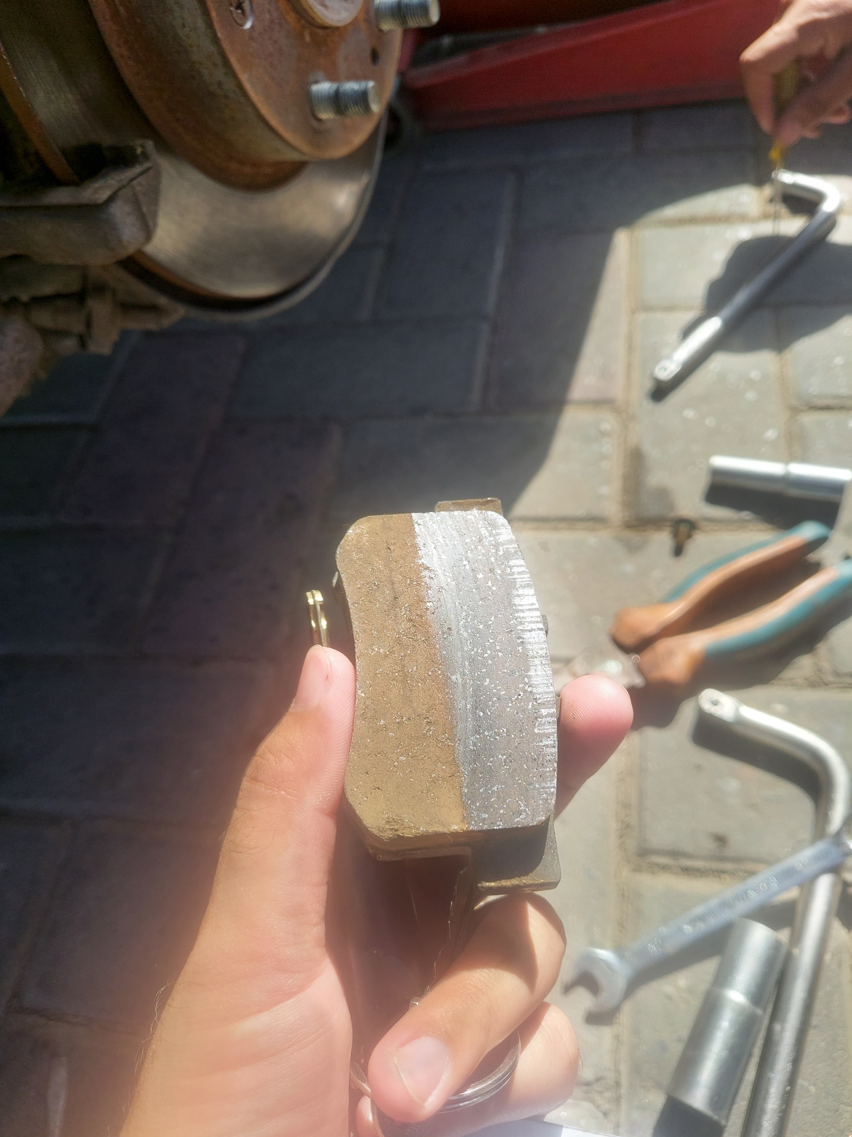

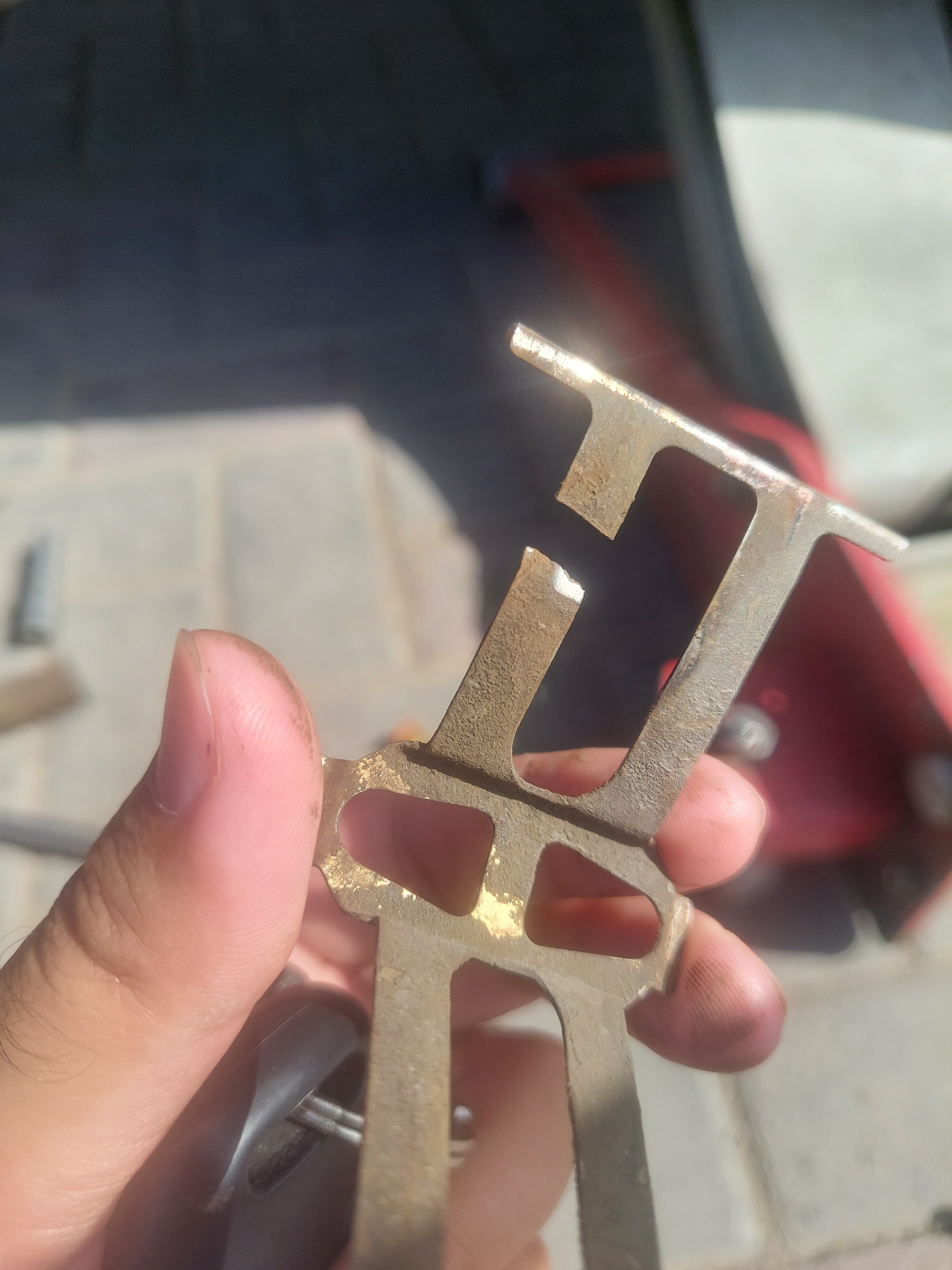

Brakes on right back side make noise with each tyre rotation before getting on a high speed or applying brake. When I got it checked the first time, outer break pad was half used, and the clip holding it was broken.

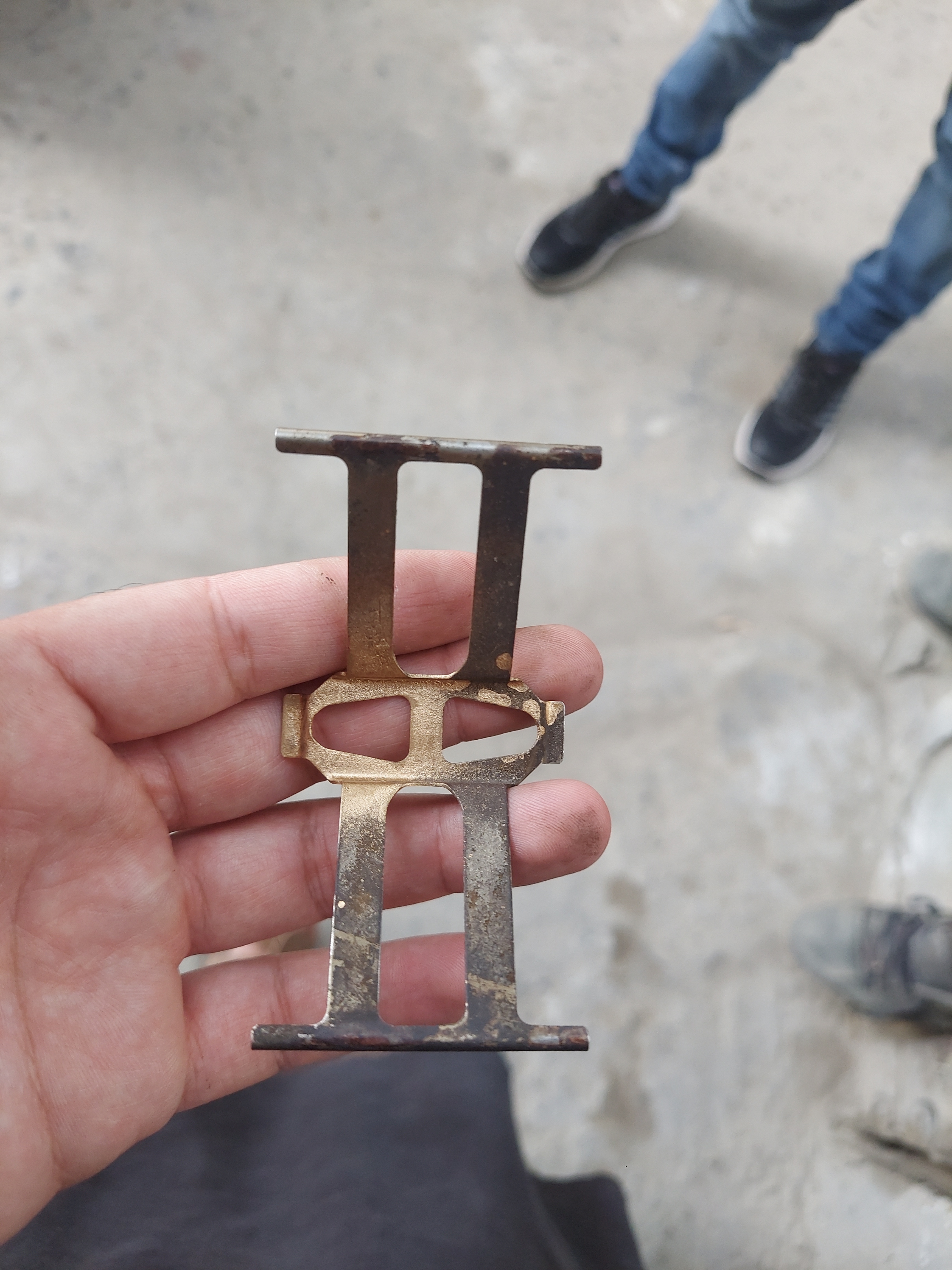

That mechanic cleaned the pads and removed the clip saying it is not much needed. Mechanics said the wheel bearings are okay. the sound didn't stop.
I got it checked yesterday, and this time the inner pad was half worn the same way. So there was rust on the rotor accordingly. The mechanic insisted that I need to get the rotor clean to fix the sound, and change the brake pads. That didn't made sense to me, but I got the rotors clean, but didn't change the pads. I think the issue is still there.
What can be the cause? Guide pins are free to move.
Also, where can I get this clip? The people near walton lahore want to sell it to me for 1500. 🤣
