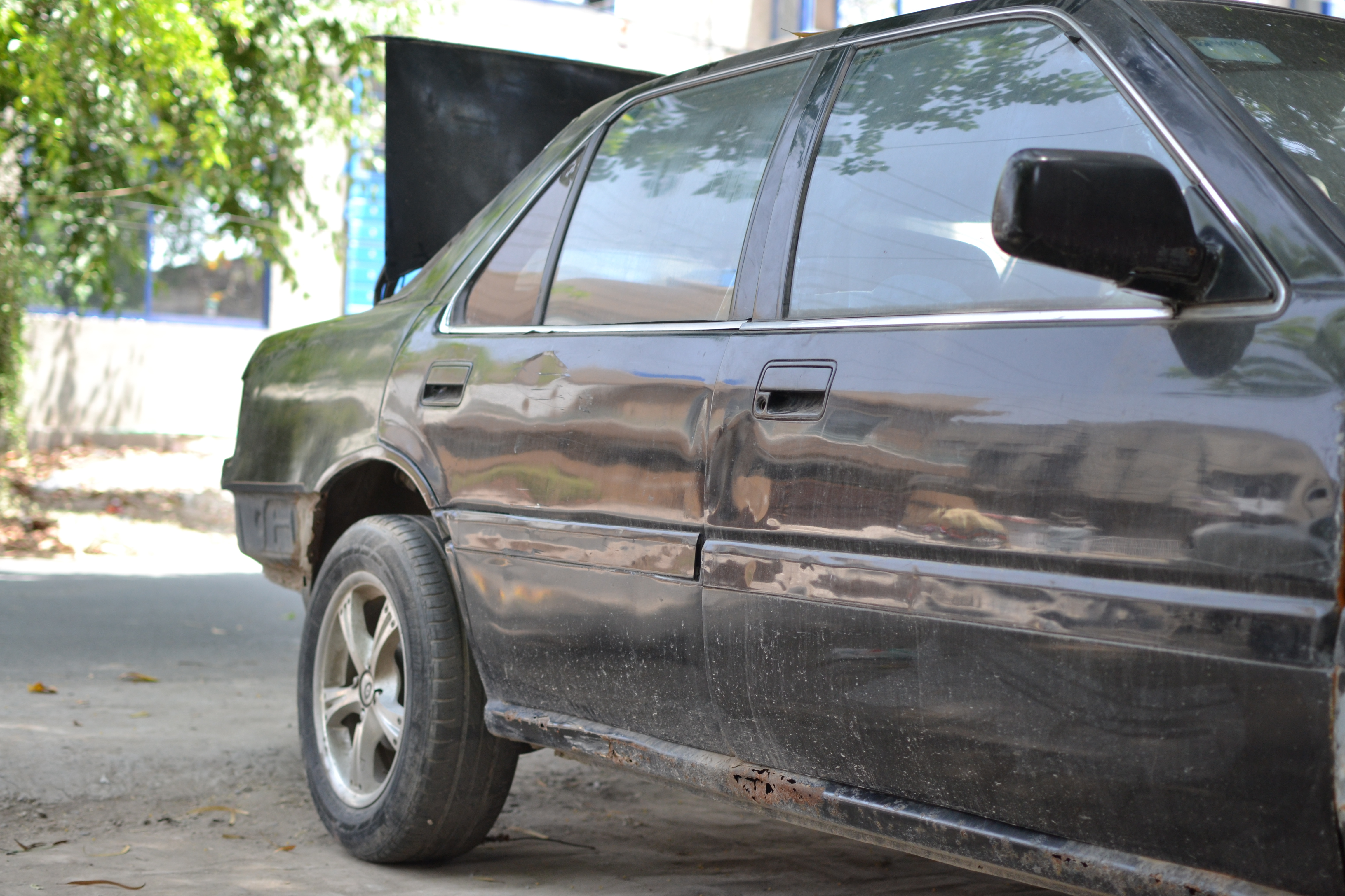

Alright guys, I've handed over the car at the workshop.Project Honda Accord CA5 has officially started, Alhumdulilah =)

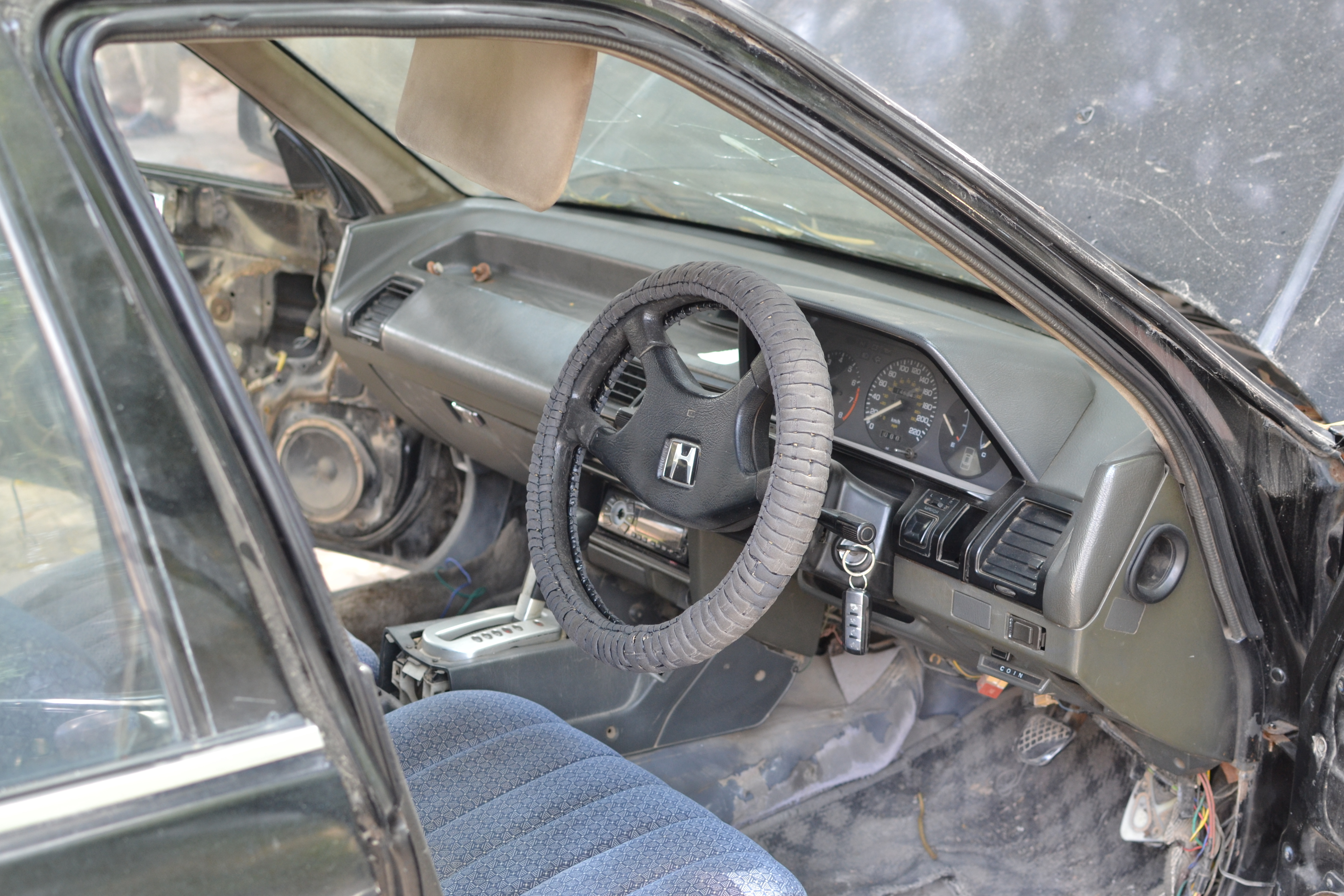

This is the position of the interior right now, luckily, there are no cracks in the dashboard, the door inserts are complete, all the switches are in pristine condition and they're working as well.

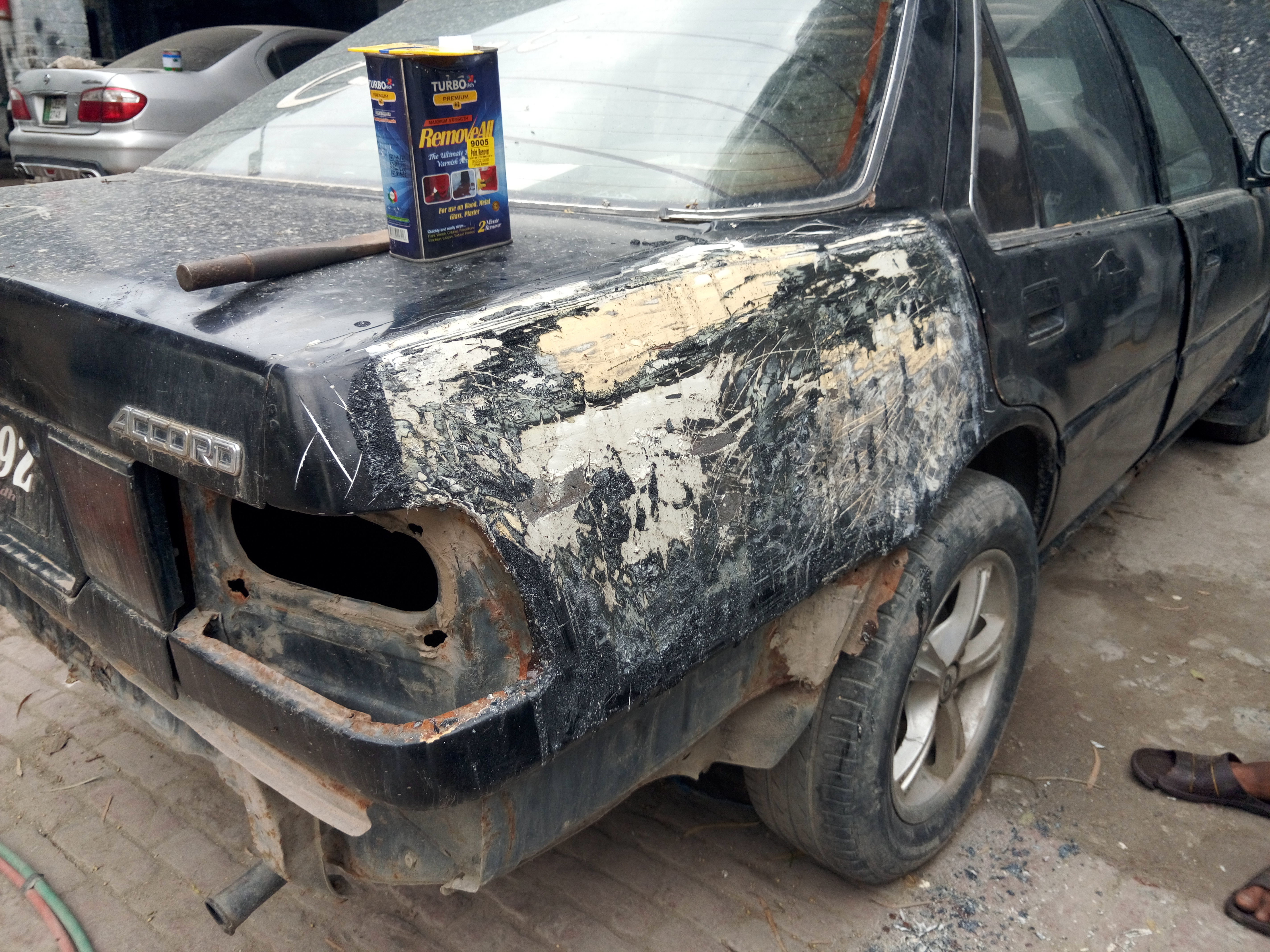

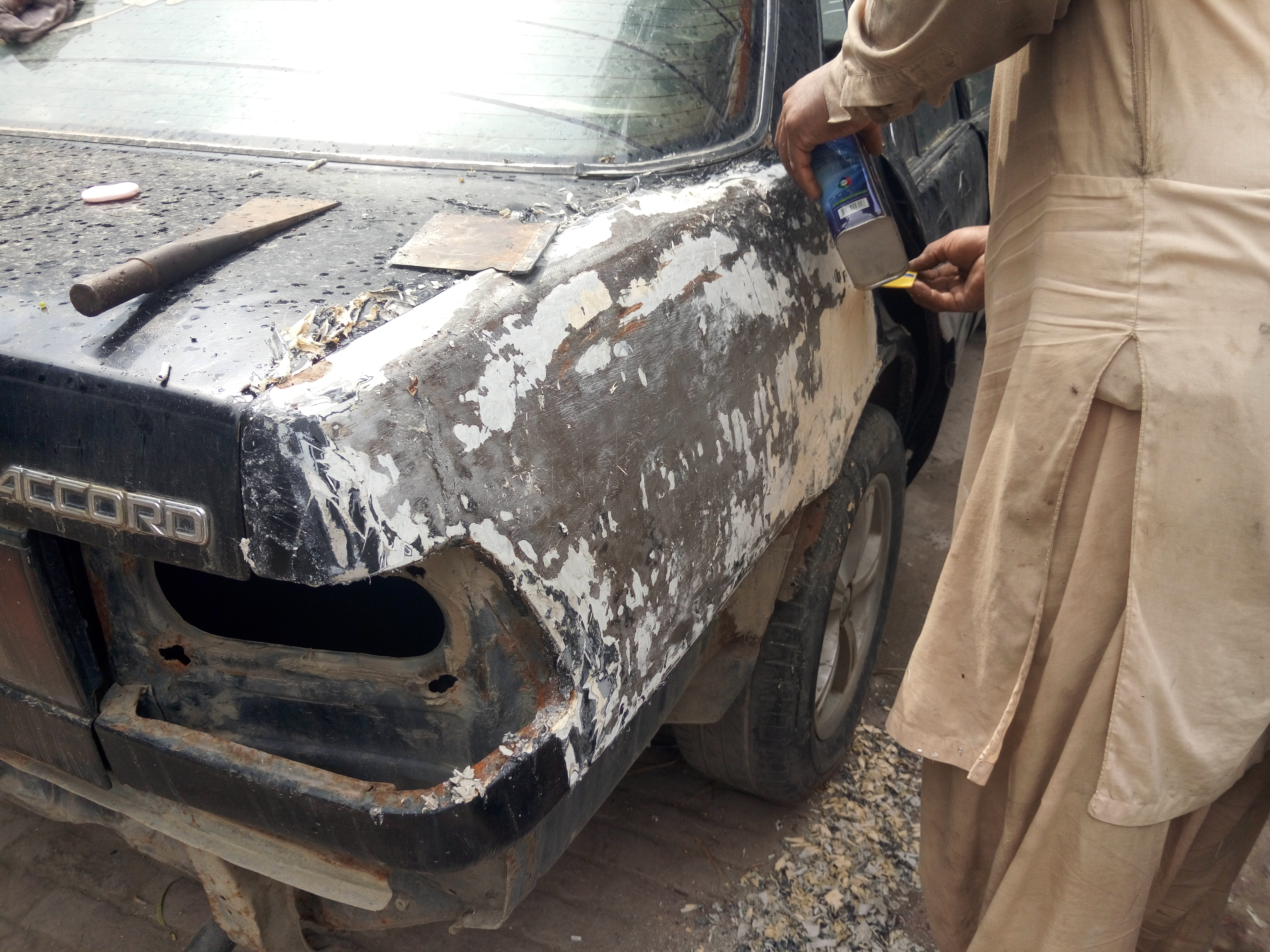

Day 2: The denter started working on the rear panel, by stripping down the paint first.
He's using this paint remover, locally manufactured by Shalimar Organics

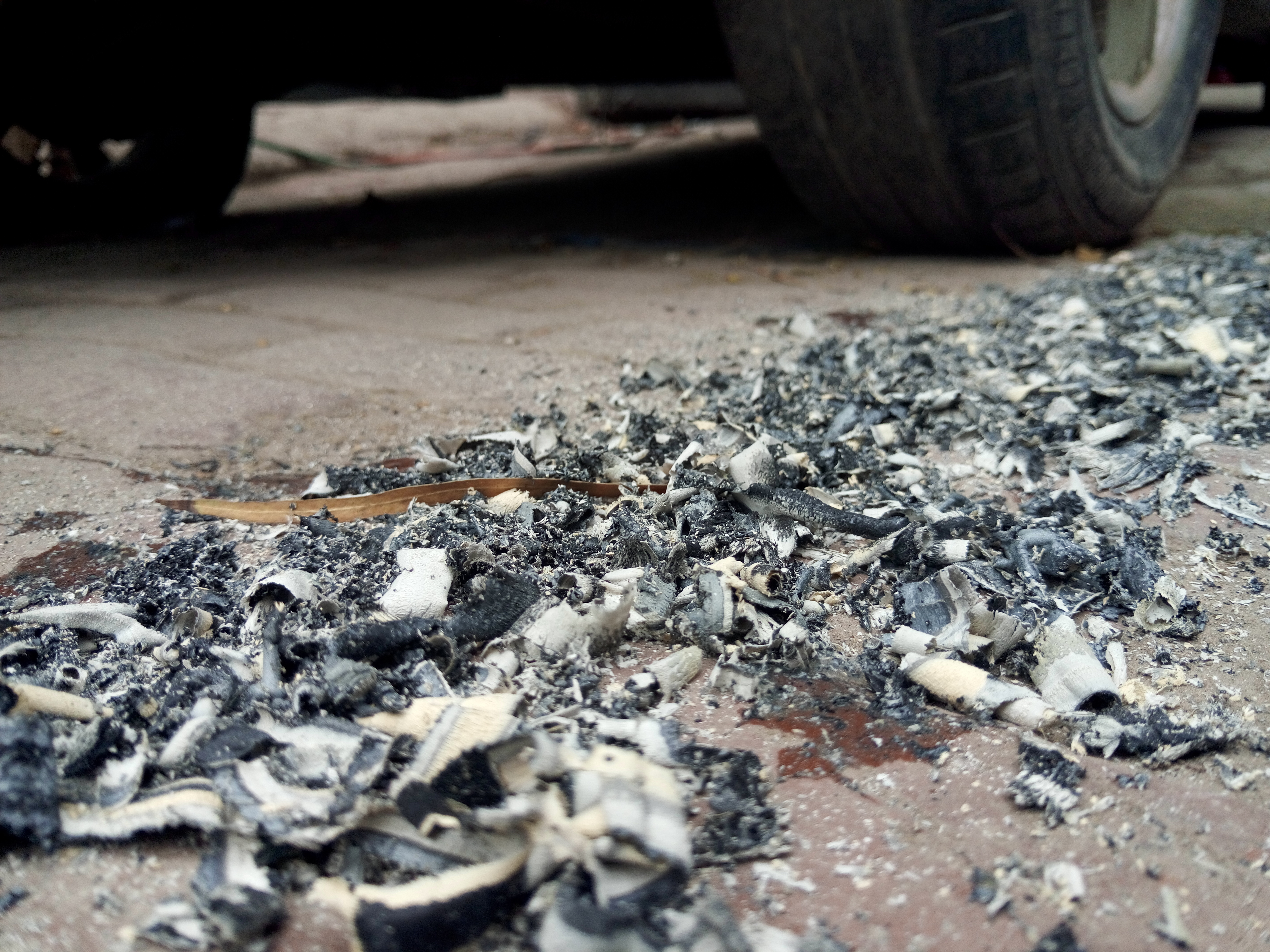

The paint and filler came off quick and well, thanks to the paint remover, otherwise it was a pain in the ass. The previous owner sure did *****up the car with a cheap paint job.
