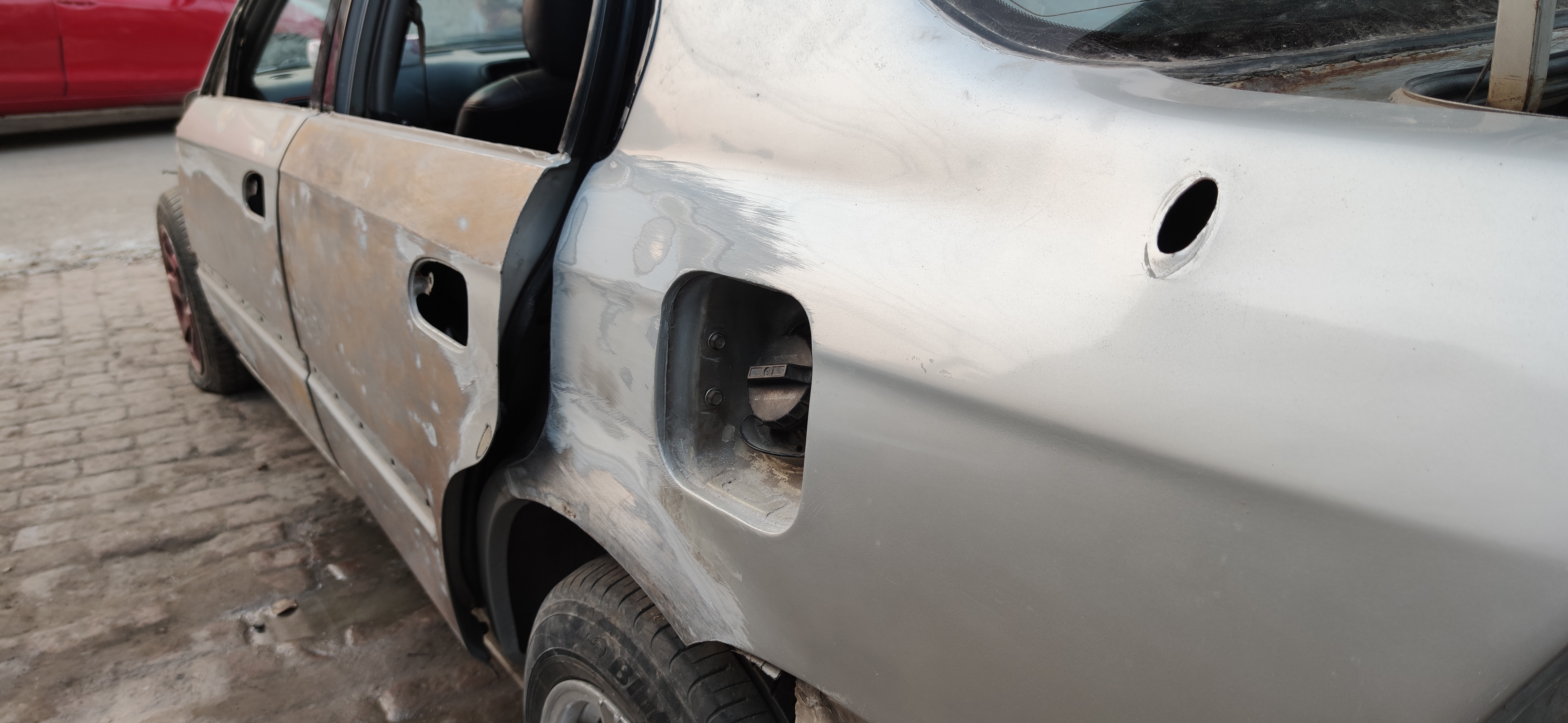

The left fender needs to be replaced, due to excessive filler applied by the jerk who BOTCHED up the car earlier, the fender isn't aligning with the front door properly, will he going for a replacement. Can't believe that a single fender costs 7-8k today for a 21 year old Civic.

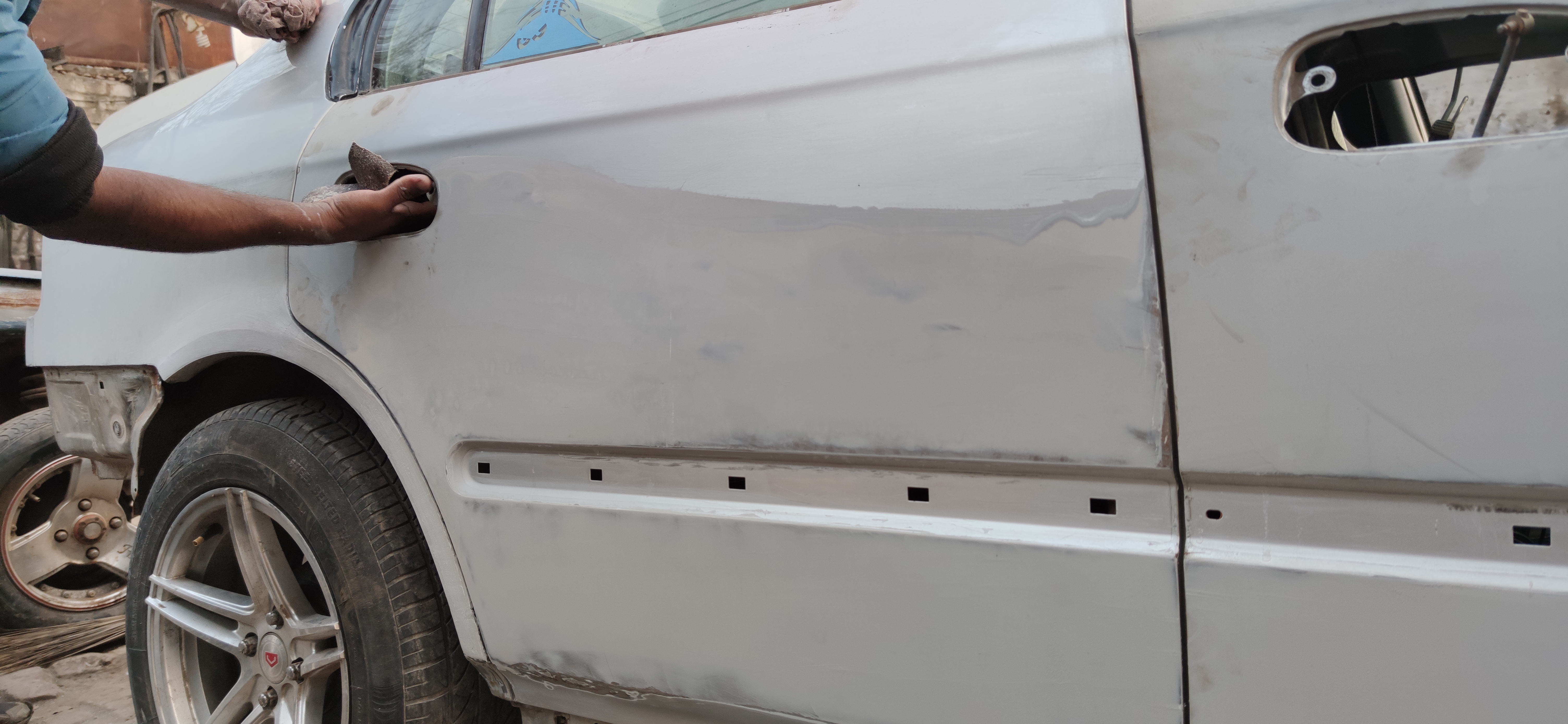

The right front door was done and the filler was removed from the rear door and the rear quarter panel.

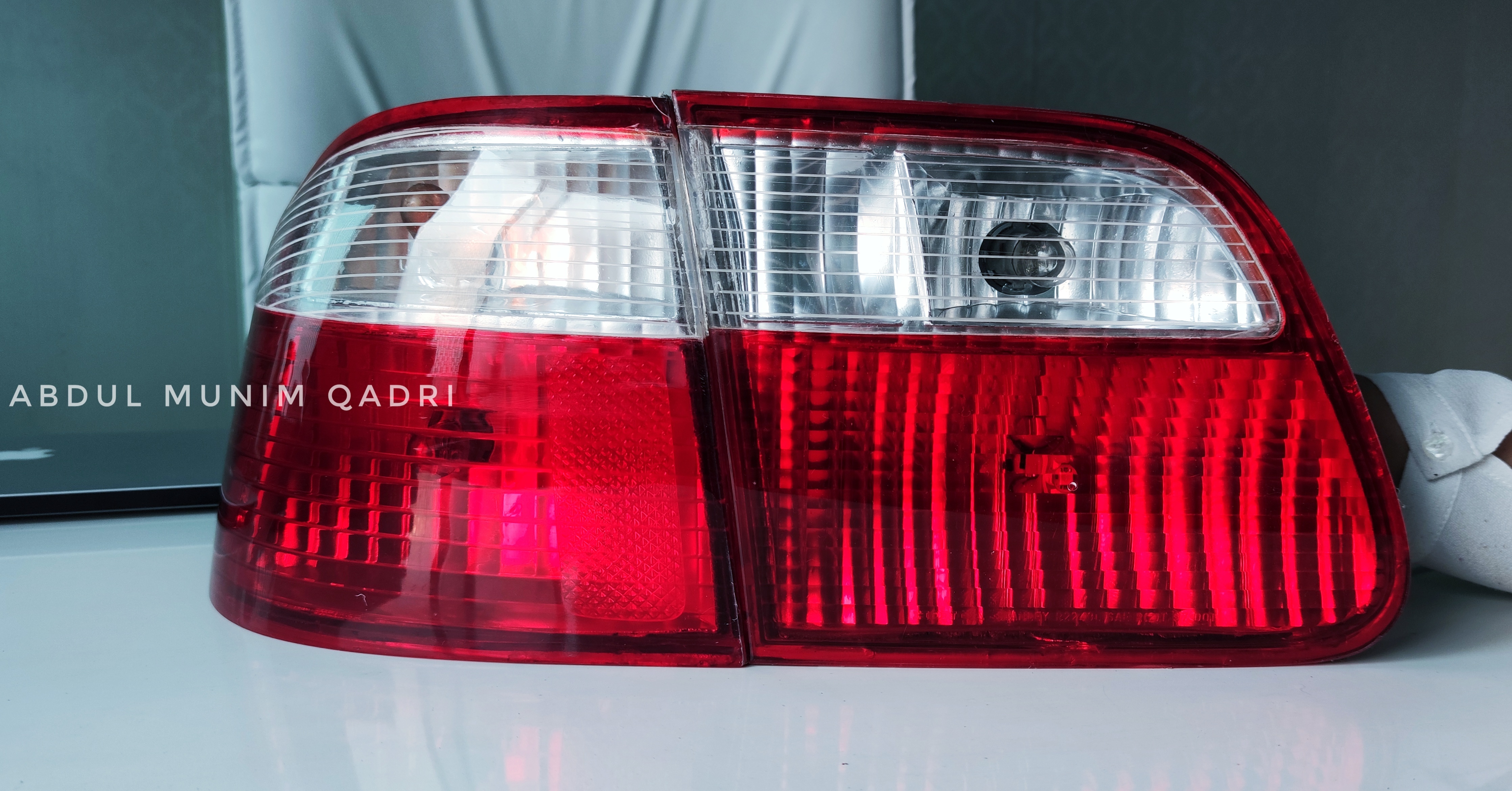

And here they are, the converted RS tail lamps.

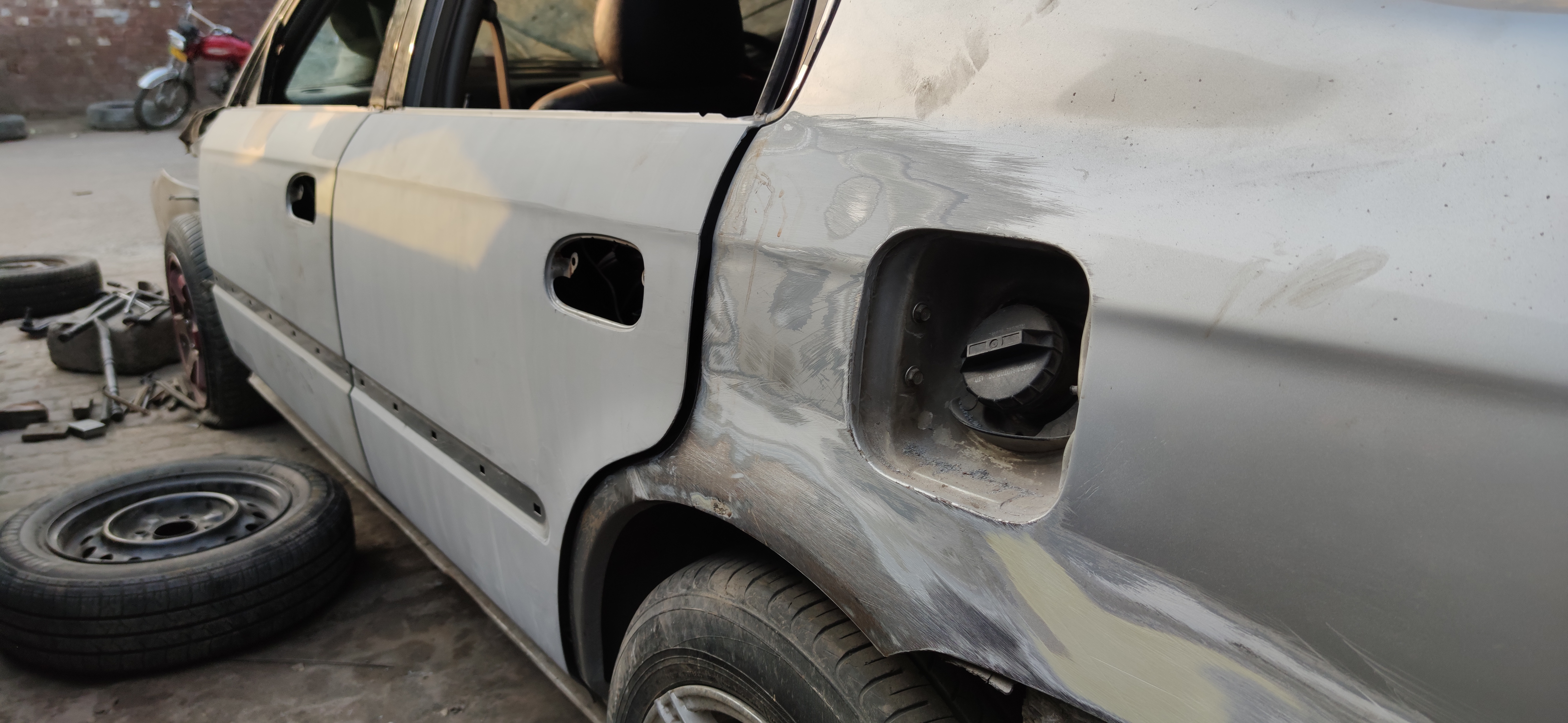

The extra filler will be sanded down but I'm glad that the door's back in shape

Sanding in progress
Filler off
Filler on

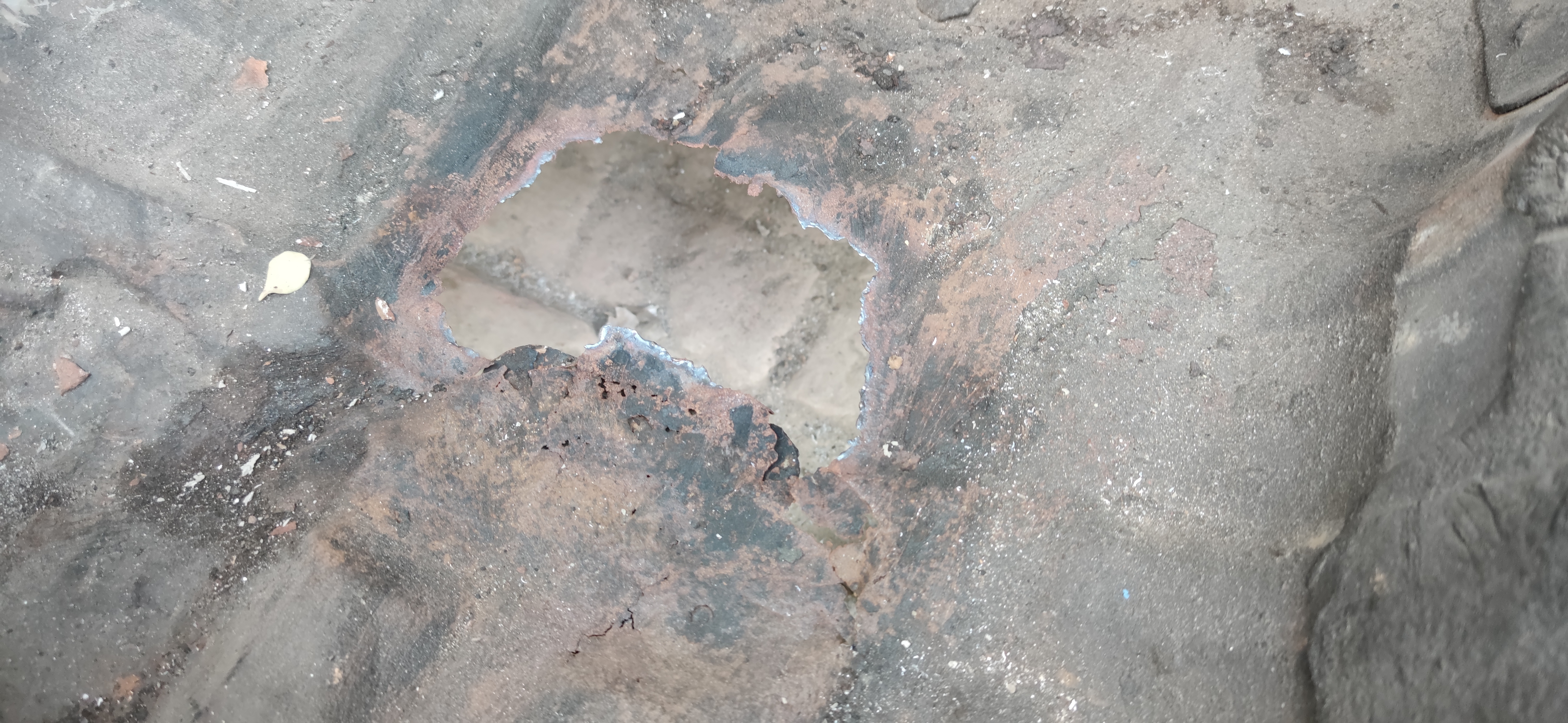

The spare tyre area of the trunk is really rusty, I'll be buying the entire piece instead of welding the missing piece on an already rusted piece.
