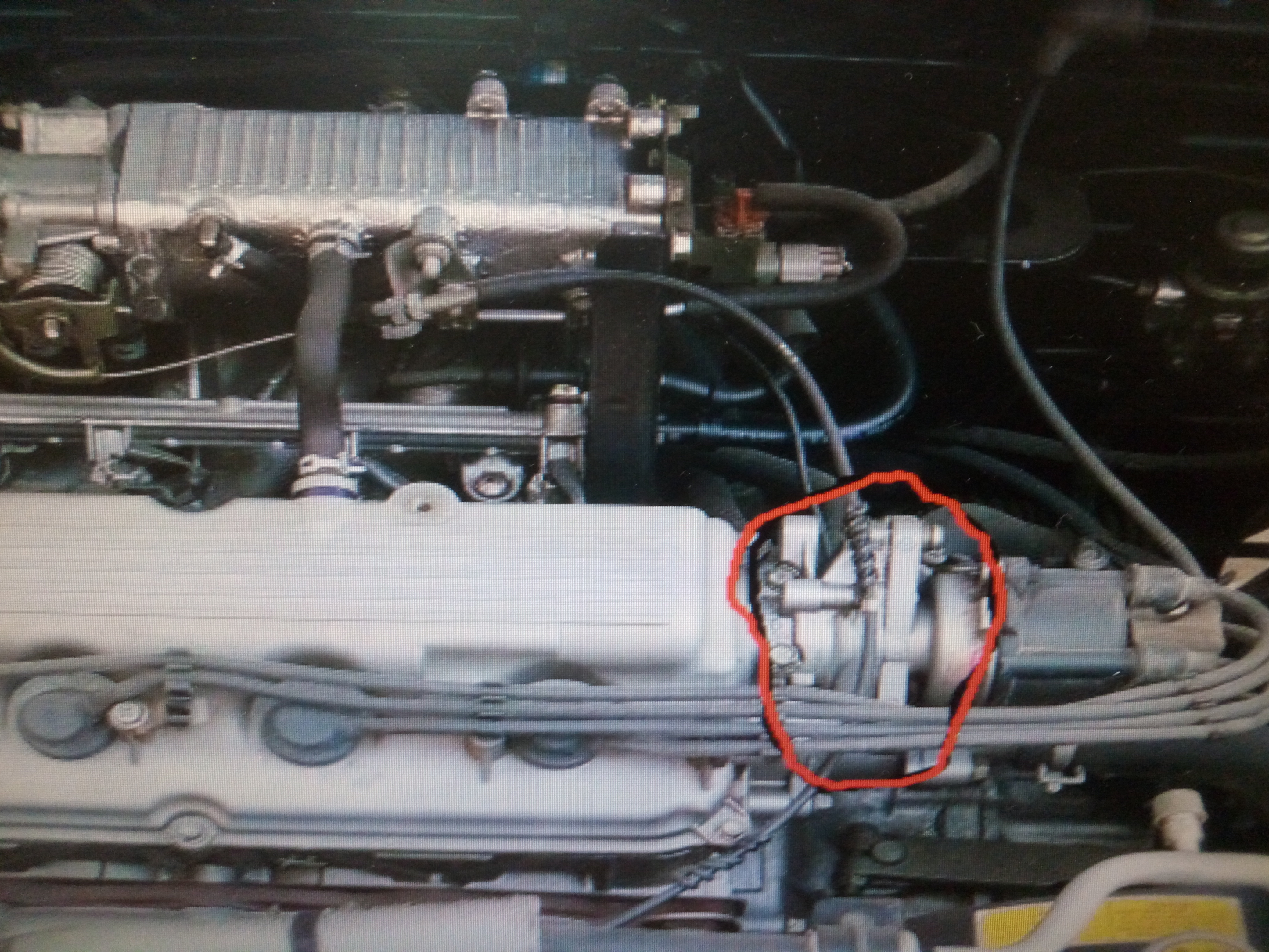

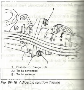

For CNG timing is kept a bit advance. Advance timing usually increases the pick of a car to a certain point and also might increase the idle rpm, you will have to allow the ECU to relearn the idle. But this will also cause knocking on petrol when engine is under load. For increased mileage maybe a little advance would help.
